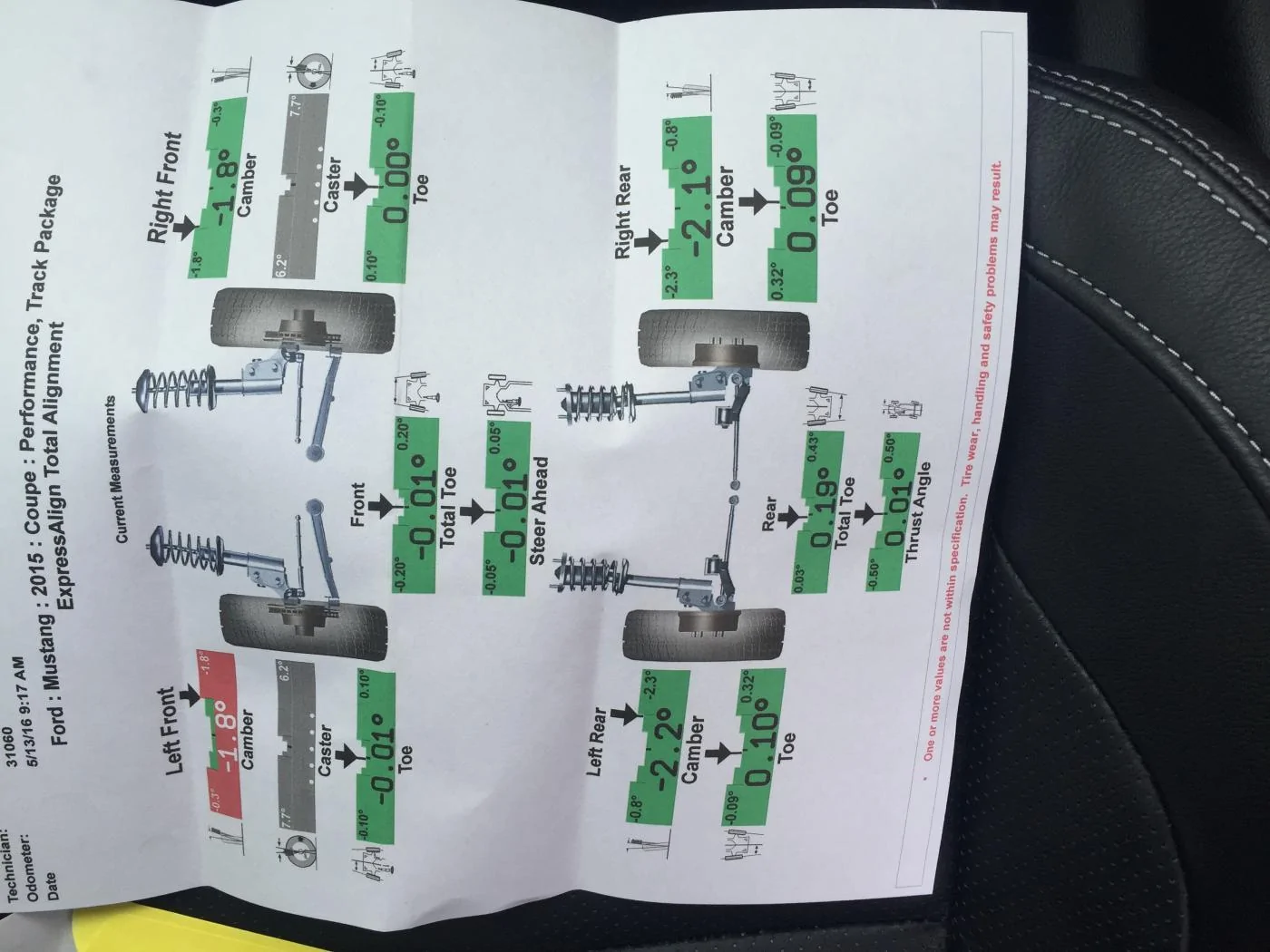

I was just looking to compare what others got for their alignment specs for Eibach Sportline springs and see if mine are fine. Let me know what you got!
Wheel specs:
VMB5
20x9/10.5
Offset: 35F/45R
275/35/20 & 295/35/20

I don't have access to my specs at the moment, but my alignment was done at the Ford dealer, and they were able to get my front camber at -1.5 or so-which was my requested number-without any camber plates or bolts. I'm running slightly more negative camber in the rear.

You are correct. I may plan on adding them in the future if necessary. I don't see there being anymore adjustment in the rear since it'd be too close to the fender.

You need some toe in for the front unless you specifically asked for zero for autocrossing for instance.
