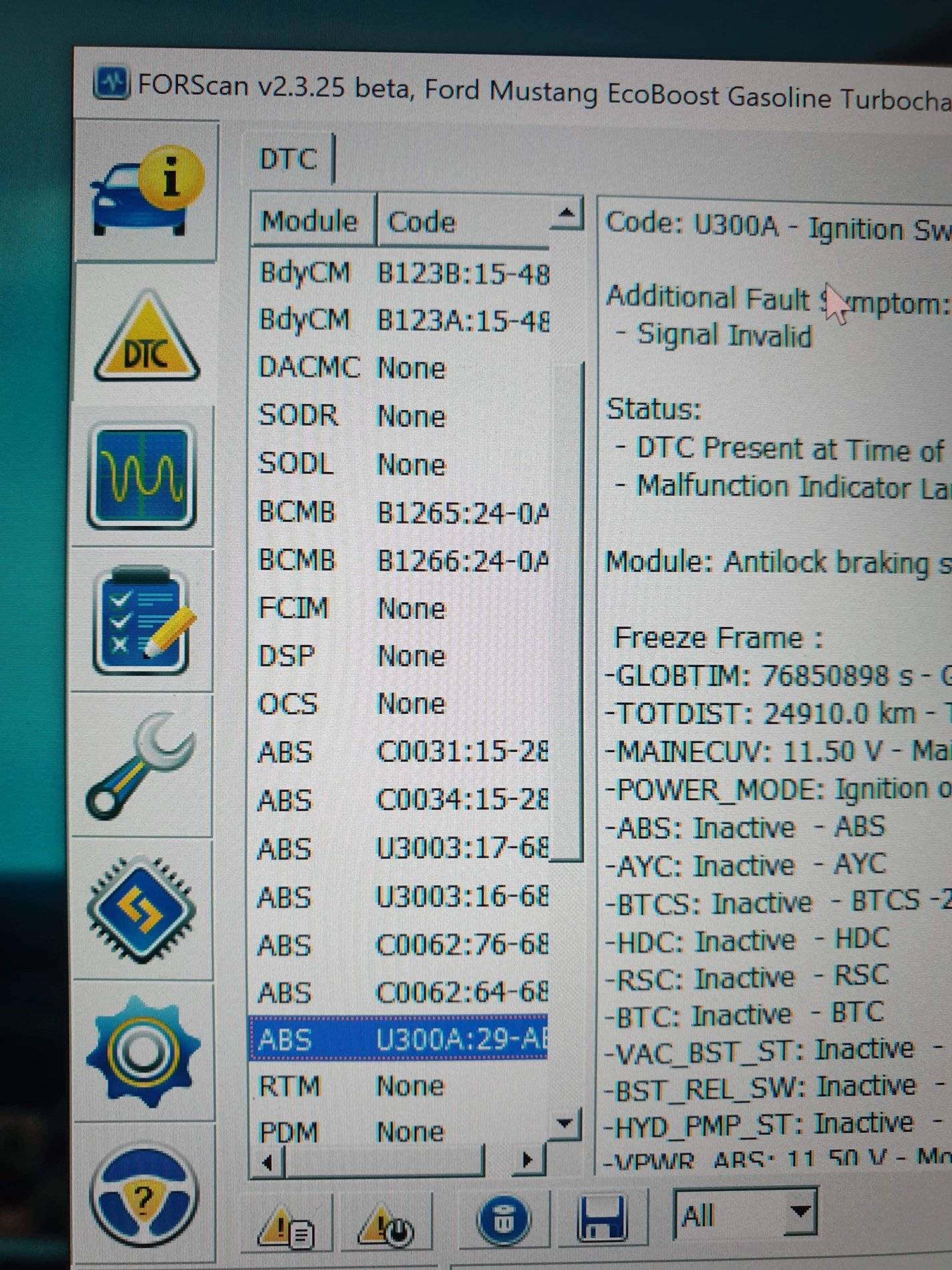

Hello guys , so i `ve been looking through forum threads and i cannot find the exact problem i do , so , i ve bought a 2016 performance pack eco , wrecked , not extremly hit , pretty easy to fix , car was hit in the front right side corner , the main wiring harness was hit , and couple of conectors were torn apart , i ve replace and repaired wire by wire every single thing , and after the car was all put toghether , send the airbag module from under the center console to get repaired i got all these codes shown in the picture , pretty much its telling me the abs module has no conection , i don`t know if its like an electrical conection , or CAN conection , the tester its not able to make a can conection though , or thats what im getting told , i ve checked the abs module for power , and the power gets to him , checked the pins from the large conector , now im not sure , but the abs module isn`t the box from driver side from where the brake lines get out ? , not a mechanic , just wanted to make myself a project .Also the tranction control switch from the dash does nothing when flipped , when i break there is no abs action car goes sliding , i pretty much have no sistems working at all . So all this beeing said , has any any clue what could this be caused from or where can i start looking ? Thanks in advance .
