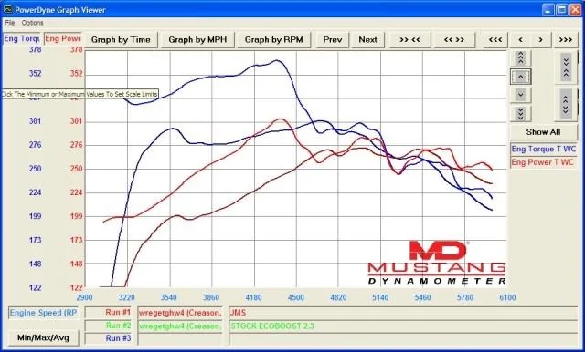

Found one. They did a whole write up on it on stang TV. Base line dyno was 273rwhp. They put both the pedal max on it and boost max and got to 306rwhp. So 33rwhp gain. BUT, and there is a big but. The dyno graph looks terrible. The power is all over the place and it peaks the hp at 306 around 4k and then it actually DROPS below the stock level, ummm no thank you. For the two products they cost $600. A Cobb accessport with a real tune gets my vote. The power curve looks way better and I don't wanna be getting in the the throttle and have power fall off in the 4k range.

LoL WTF is up with that graph....

Found one. They did a whole write up on it on stang TV. Base line dyno was 273rwhp. They put both the pedal max on it and boost max and got to 306rwhp. So 33rwhp gain. BUT, and there is a big but. The dyno graph looks terrible. The power is all over the place and it peaks the hp at 306 around 4k and then it actually DROPS below the stock level, ummm no thank you. For the two products they cost $600. A Cobb accessport with a real tune gets my vote. The power curve looks way better and I don't wanna be getting in the the throttle and have power fall off in the 4k range.[/
The graph had this caption at bottom from Stang TV it got cut off in you pic
Power gains are even more prevalent when we overlay the JMS dyno graph and the stock graph. Look how much torque the engine is making as soon as we hit the pedal, and once boost peaks, it really climbs.
The End of the article from Stang TV read
"Final power numbers ended up at 306.7 hp and an impressive 370.3 lb-ft of torque at the rear wheels. That’s a gain of 33.5 hp and 66.5 lb-ft of torque to the rear tires. Assuming a 12-percent power loss through the drivetrain our EcoBoost was making 343.5 hp at the crank and 414.7 lb-ft of torque. That’s better than current Mustang GT levels of torque at the crank, and equal to or better than a 4.6 3-valve 05-10 V8 with a few bolt-ons in terms of power at the wheels..
Suffice it to say, we can think of very little else we could do to our EcoBoost project car to gain this kind of power so quickly. On the street the new-found power, especially all that torque is immediately noticeable. At the top end of second and third gears, we noticed the ESC stopping wheel spin on the rear tires. The gobs of torque, and the responsiveness of the engine are incredible, and while the car was enjoyable before, its ability to induce a smile during a quick spin around the block is even better than ever."

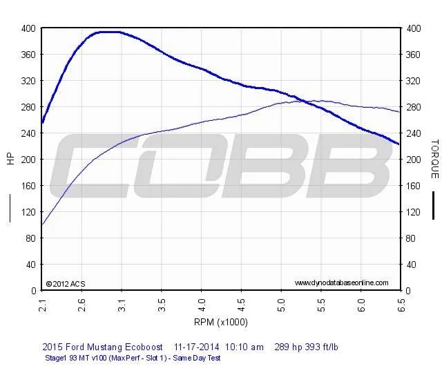

Straight off the shelf map no mods bone stock from Cobb ($500).
Vs. the above graph you just posted. At redline 6.5k Cobb is still pushing 280rwhp. Your graph above is with both pedal max and boost max ($600) dyno graph stops before reline, probably falls off even more, but at 6k it's only pushing 250rwhp. You're definitely gonna feel getting into the power and that drop off.

Does anyone get the "too soon Junior" feeling when looking at the PedalMax/Boost max graph? All go in the beginning, then dies off half way lol.
