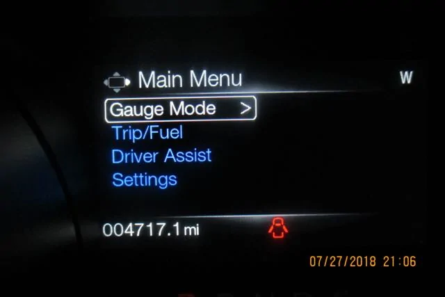

Mine shows nothing on the info display and I can't find a definitive answer from a search. It's listed on the Monroney sticker. Thanks in advance.

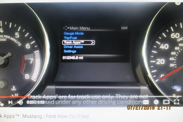

The official Ford track apps youtube shows it between trip/fuel and driver assist. It's missing on my base V6. See photos. If someone can enlighten me I would appreciate it. View attachment 292919

Maybe Ford deleted the feature from 2017 V6 cars at some point?

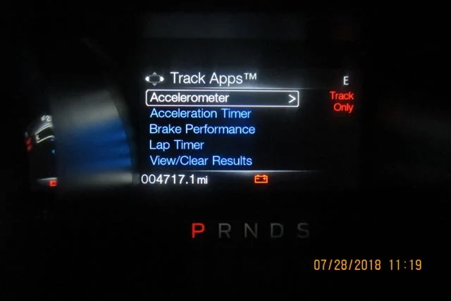

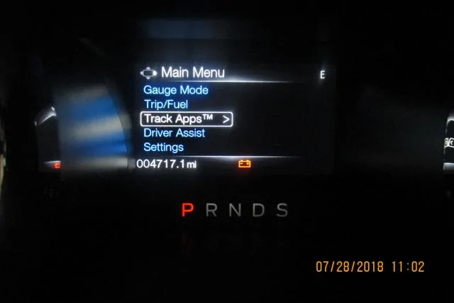

My 2017 V6 has track apps.
Edit: do you think maybe you have a "my key" programmed to disable the track apps?
Bingo: When the car was new, I wrapped one fob in foil and hid it on the car in case of a fob mishap on the road.
Evidently, the one I kept in use had the track apps deleted by the dealer via MyKey for employee/test drive use.
I activated the hidden fob and behold, track apps. Cleared the MyKey settings from the other fob and all is good.
As previously mentioned there is no line lock or launch control, but the rest is there. Thanks guys.
