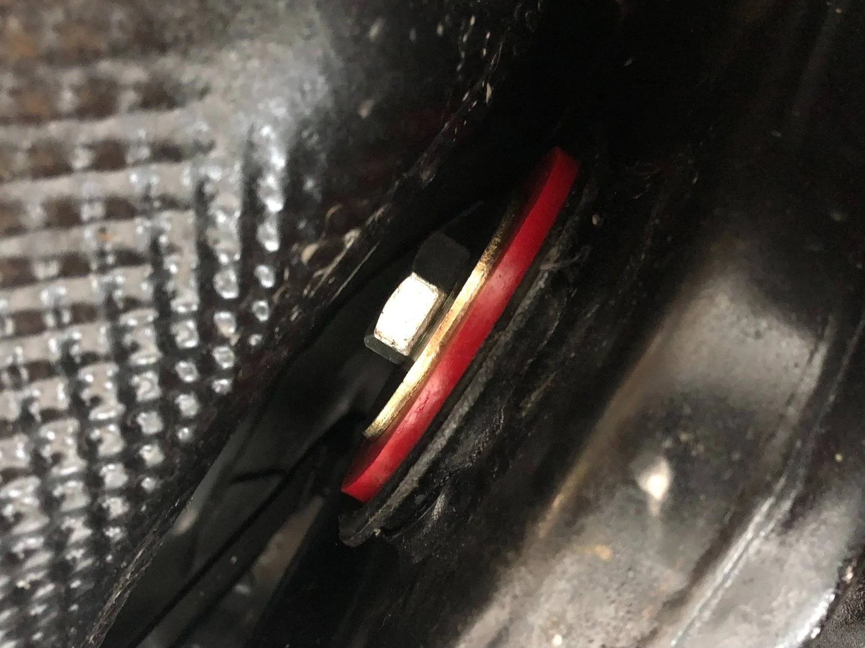

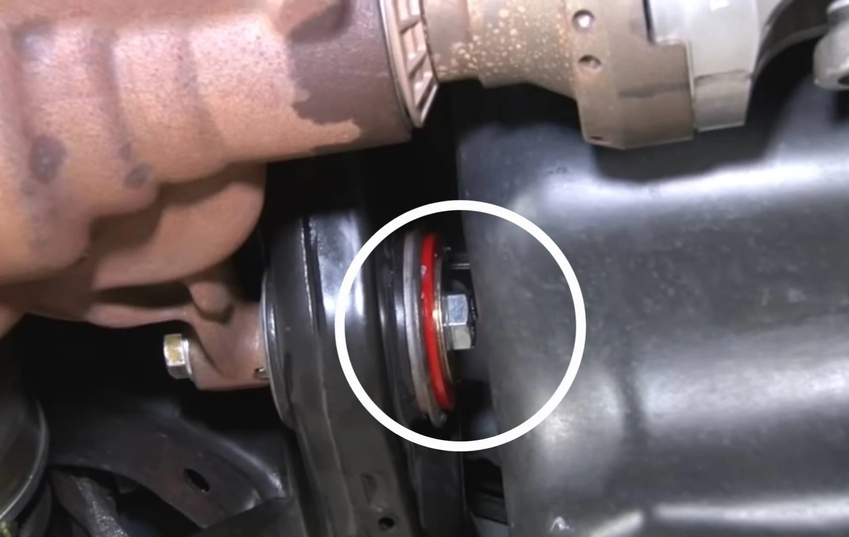

I have the rear cradle out of my car right now, and am in need of a dimension.
I'm looking for the distance in-between the subframe (where the forward diff bolts are) and the fuel tank on both sides?
It would be best if it was on a setup that has the cradle squared up with alignment bushings for accuracy, but I'll take what I can get.
Pic below for reference:
6,826
13,684

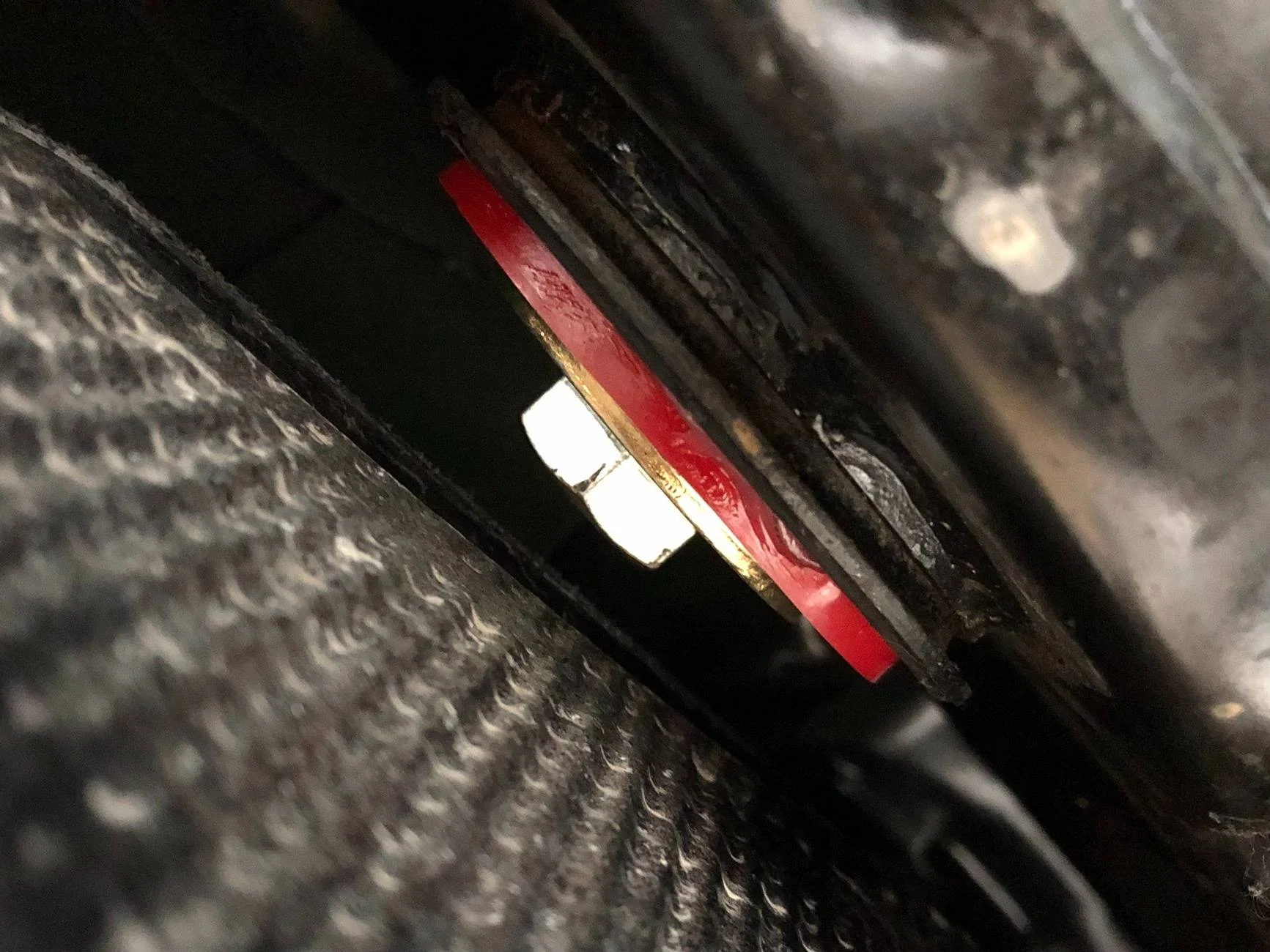

I only have these two pictures :
But it looks to be about the same as the M14 bolt head (about 9mm) :like:
Note that my tank has heat shields on it, but your photo looks like a bare tank ?

Thanks, yes that helps. I do not believe I have the heat shields that wrap around, but I pulled my picture off of Google.
I watched a few diff bushing install videos to get an idea on how much room there was there.
Looking at doing a different through-bolt setup and trying to make sure I have enough room for my idea. Thanks
