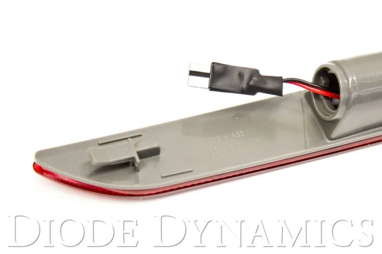

I fitted DD Side Markers using the supplied (crappy) taps and wiring harness and tapped into my rear number plate wiring. Tested that all was OK, then decided to tighten up the harness connectors then nothing worked! No side marker lights, no rear licence plate lights, so I guess I blew a fuse. Cannot find the fuse that protects the licence plate lights in the User Manual and NOTHING ON ANY FORUM. I can’t be the 1st person to do this. Help me someone please identy the FUSE number!!

Hang on, why in the world would you tap anything with their side markers? The side markers do not even come with a tap, it's literally plug and play:

Because in the EU/AU models the stock side marker is a dummy reflector. Diode Dynamics supply a wiring harness to tap into the licence plate wiring for power... now forgive me, I dont want to appear rude to all my Stang friends out there, BUT an answer to my post is all that is required (to recap) WHAT IS THE FUSE NUMBER THAT PROTECTS THE LICENCE PLATE LIGHTS PLEASE
