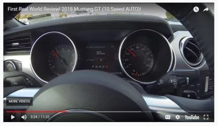

How do we get this onto our 2017 cluster?
2018 Mustang now comes standard with centre digital speedo if you don't choose the latest full digital dash display.
