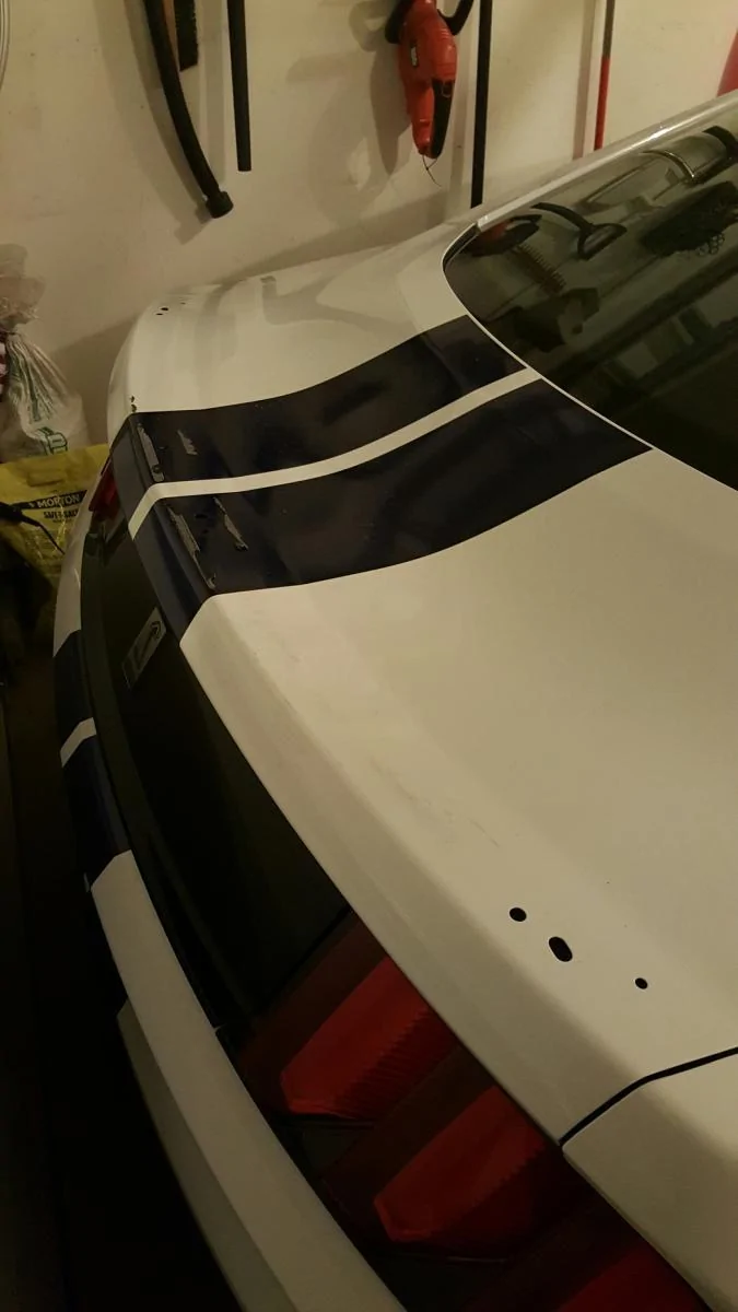

7)With the spoiler removed you will be left with this. I removed the tape by just rolling my finger over it with light pressure and it balled up. Then i just rubbed my dry finger on the rest with more pressure to ball up the tape. This part took the longest, and could go faster if you have some other tool/product.

Just installed mine. Super easy and quick. I used the wife's hair dryer to heat the spoiler. It made the tape release very clean and manageable. It didn't require any fishing line or a buddy. This pic was taken immediately after I pulled the spoiler, you can see how clean it was. Make it easier on yourself and use some heat;)
