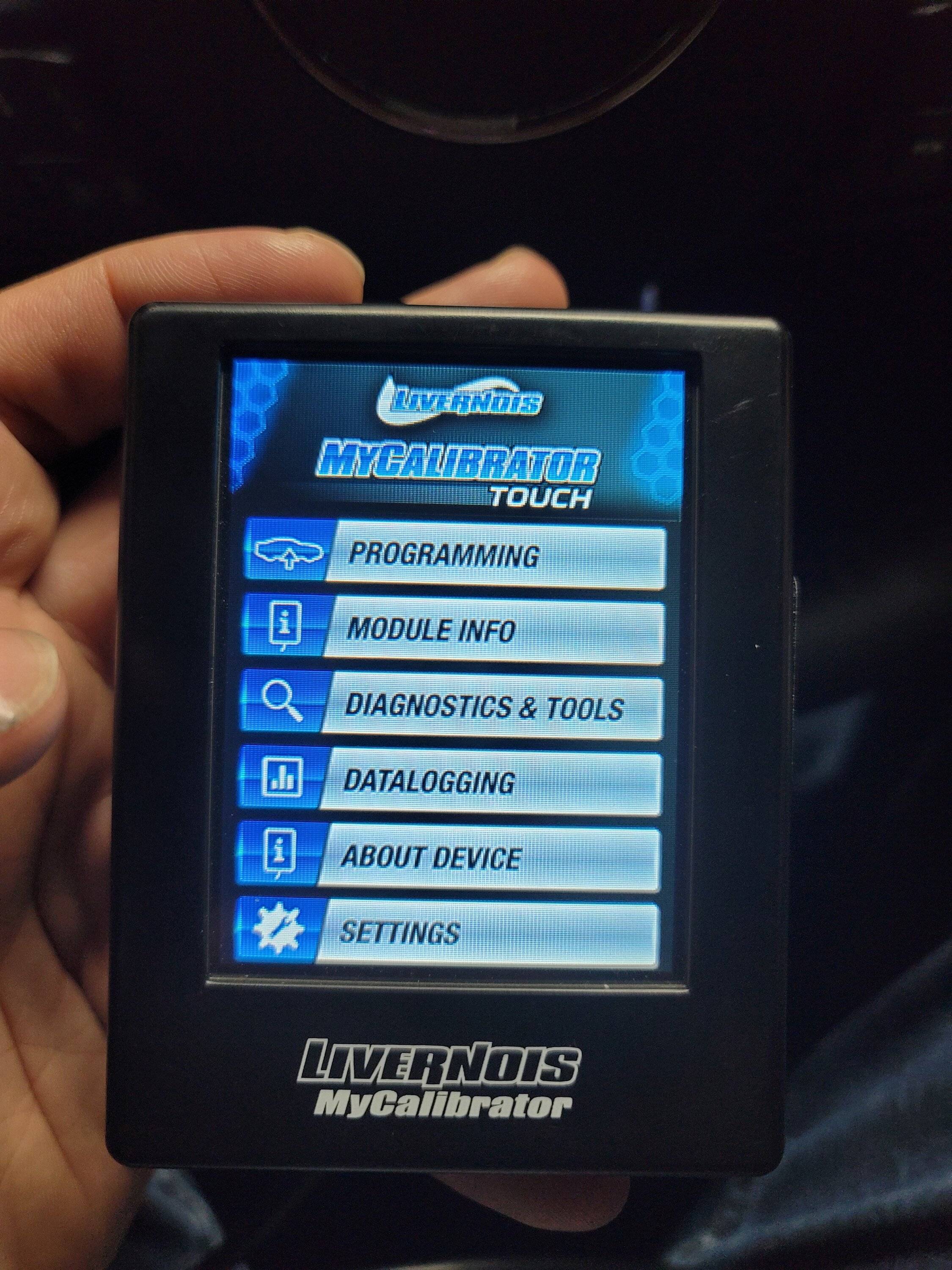

I'm having an issue after installing my vortech kit and need to data log using the Livernois Mycal Touch screen tuner.
I'm not sure how to get it to log what I'm looking for. I reached out to them and they told me to just choose my PIDS and log it. Problem is I cannot find where to choose them and there's no instructions.

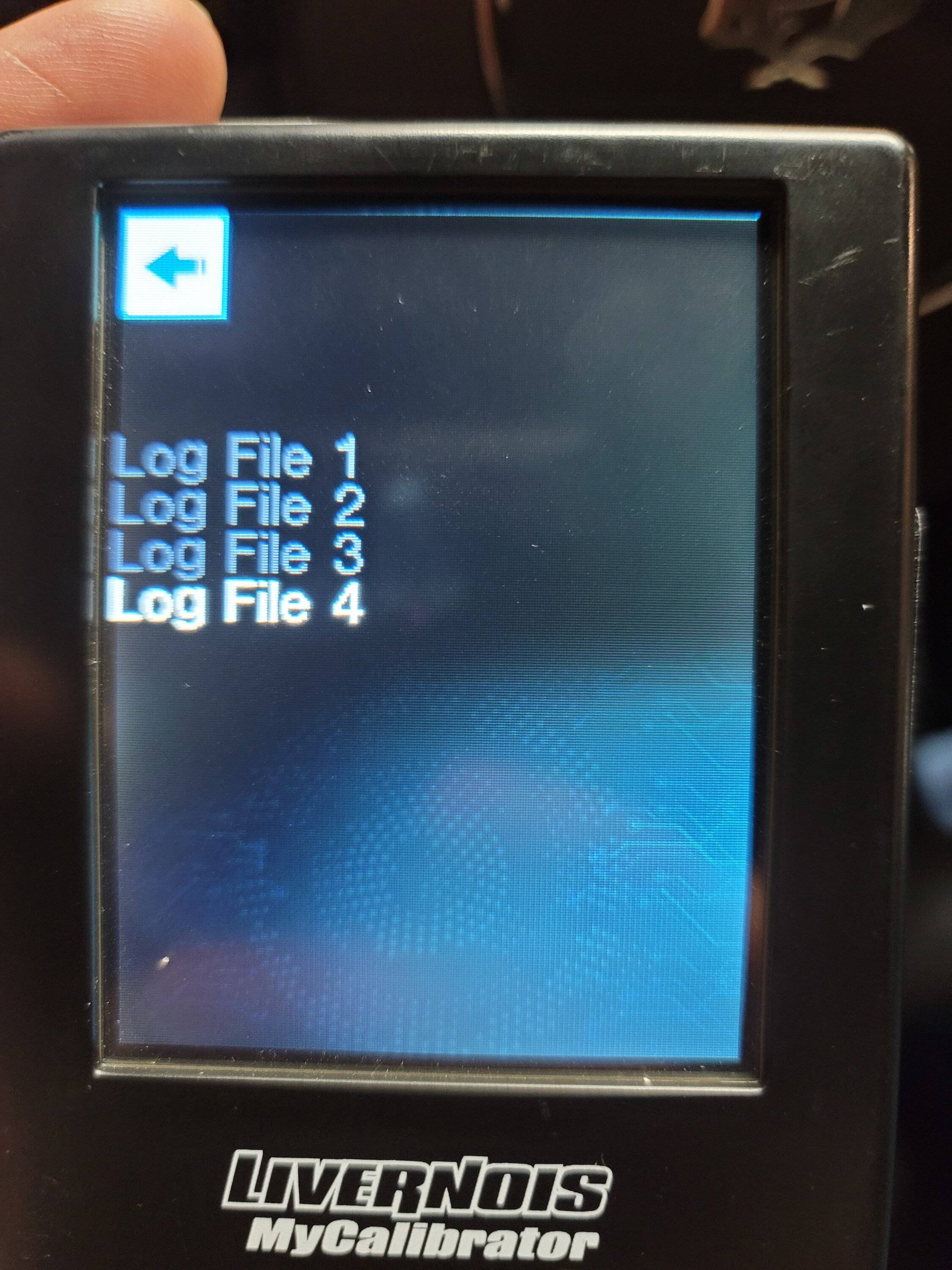

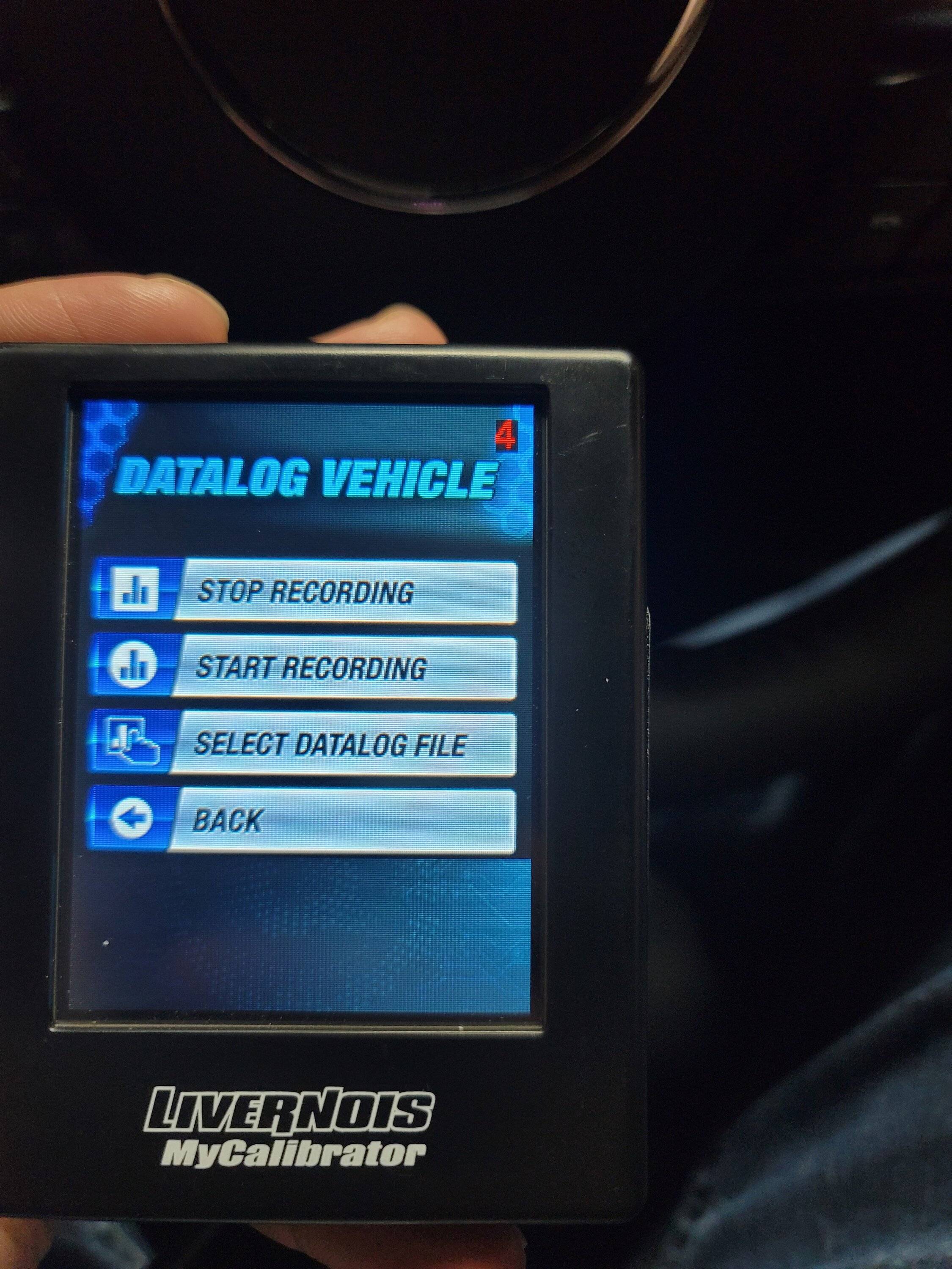

When I select file, it just chooses a file number, no selections. When I click start log, the file number appears and it does log data but they're pretty useless PIDS and again no choices.
Very likely I'm just stupid but does anyone have experience with this device?

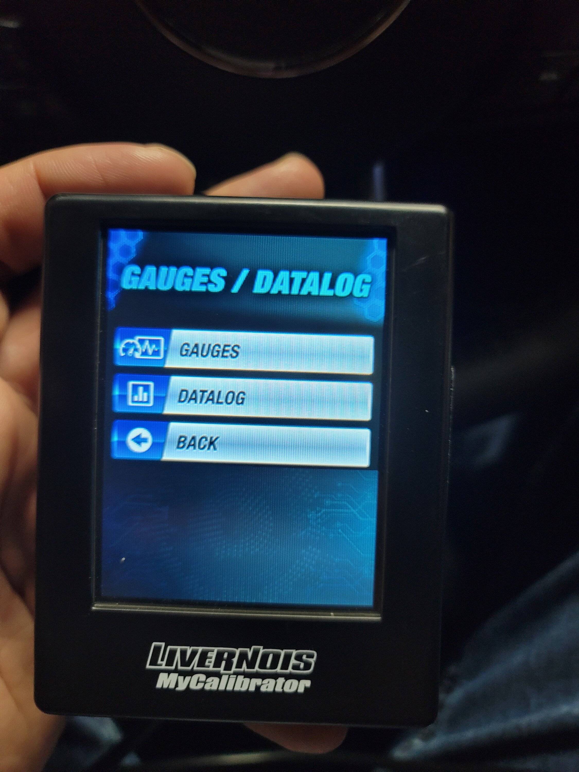

They got back to me again. You have to go to gauges,choose them, go back out and then select the log and start. The gauges are the PIDS it'll record.
