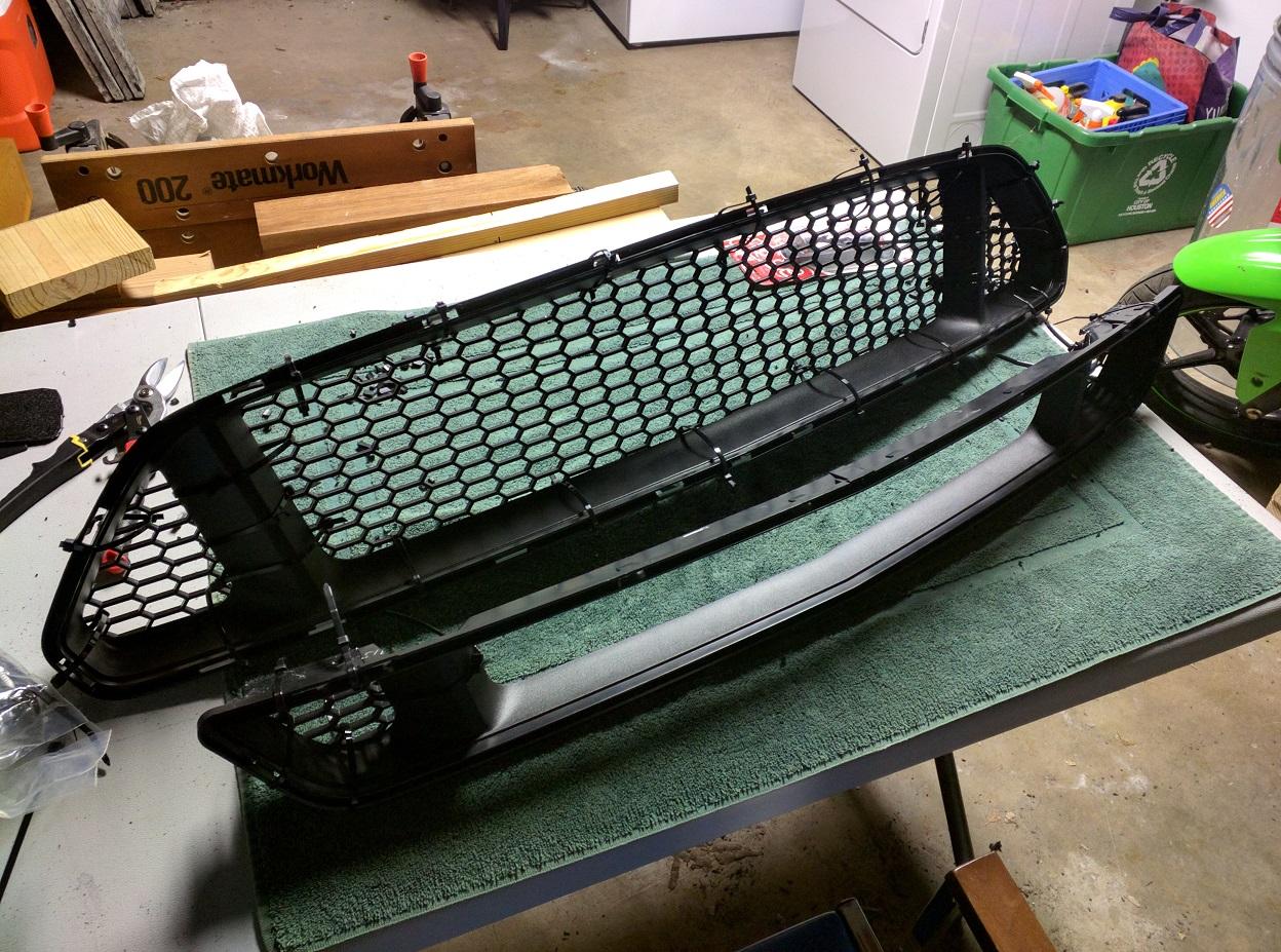

Also just finished this up! Some off-the-shelf CCG mesh. I like the oem style stuff.
