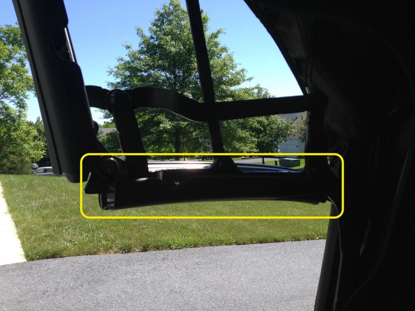

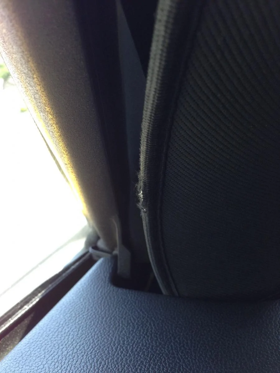

I have this crunching/clicking sound on mine when I put the top down too, last few inches of it going down. It only happens the first time I put the top down and only when the top is cool from sitting in my garage. When the car sits in the sun it never happens, and it also never happens a second time on the same day. I can immediately put it back up and back down again (anywhere from just a few inches up to all the way up and sealed) and I can't duplicate it. I can never actually see what it is that is causing it because it happens when the top is almost completely down and there isn't much room to view the "guts" of the framework. From what I can see, I don't see anything out of sorts. Even my headliner looks pristine instead of being frayed like in the picture. The nature of how and when it happens would make it very difficult for the dealership to reproduce and fix it, so I've resigned myself to letting it happen and waiting until something breaks to bring it in.

Sounds exactly like what happens with mine.
Was over the dealer yesterday, speaking with the service manager, he thinks fraying is unrelated to that noise; apparently, there are some sharp edges on the frame and he thinks that those are causing fraying.
While at dealer yesterday, the service manager heard the noise while putting top down. Taking car in on Thursday and they are going to see if they can figure out.
At first, it only did it the one time (first time I put the top down at dealer, which was the first time for the day, pretty much like you describe in your post).
Here's where I made an interesting observation, might be complete coincidence: I shut the engine off and went into the dealership, when I started the car to go home I dropped the top and it made the noise. When I got home, in my driveway, I put top up, secured latch, shut off engine, waited a second or two, restarted, dropped the top and it made the noise. I repeated 2 more times and it made the noise each time. I have absolutely no idea how cycling the engine would affect the process but it seems to make the noise consistently reproducible.

As I mentioned, I had my headliner replaced under warranty; according to Service Manager, the replacement headliner has longer plastic pieces on the sides in back, near the rear windows, than the original. Somehow, they were catching in the mechanism when the top went down; apparently, the sound I was hearing was the plastic pieces popping when they caught in the mechanism. Resolution was to trim down the plastic pieces so they no longer catch in mechanism. Their upholstery guy repaired the wear marks on the headliner edges.
So, end result, I'll see what happens over the next couple weeks.
Don't know if any of this will be helpful to you; hope so. I also hope it works for me as well.... :thumbsup:

Interesting. I don't know if my headliner has been replaced by the previous owner or not. Is the piece they trimmed the same one circled in yellow in the pic you posted, and if so, can you see where they filed it down at?

From the description provided over the phone, I don't think it is the trim piece that was falling off (which, remarkably hasn't lately). From what the SM said, I think it is part of the headliner itself, rather than a trim piece. Maybe, when I go pick it up, he can show me.
