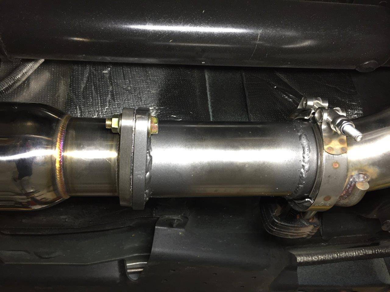

Yes, both the Cobb catback and Mishimoto dp come with adapters to fit the OEM pipe size. So you likely have a 3" dp and a 3" exhaust, with 2-¼" adapters between them, unless your shop did some custom work to eliminate that restriction. And, they're probably not bolted together. The only bolts used are likely connecting the Cobb OEM 2-¼" adapter to the 3" catback. Again, unless custom work was performed.
Here's a photo of the job done by CRD adapting Mishimoto Catted Downpipe to the Cobb V2.
MD18EcoStang
Sep 27, 2019
660
775
MD
2018 Mustang Ecoboost
They did good work. 👍🏼 A few years ago, but it looks like yesterday, assuming that's not an old photo!
