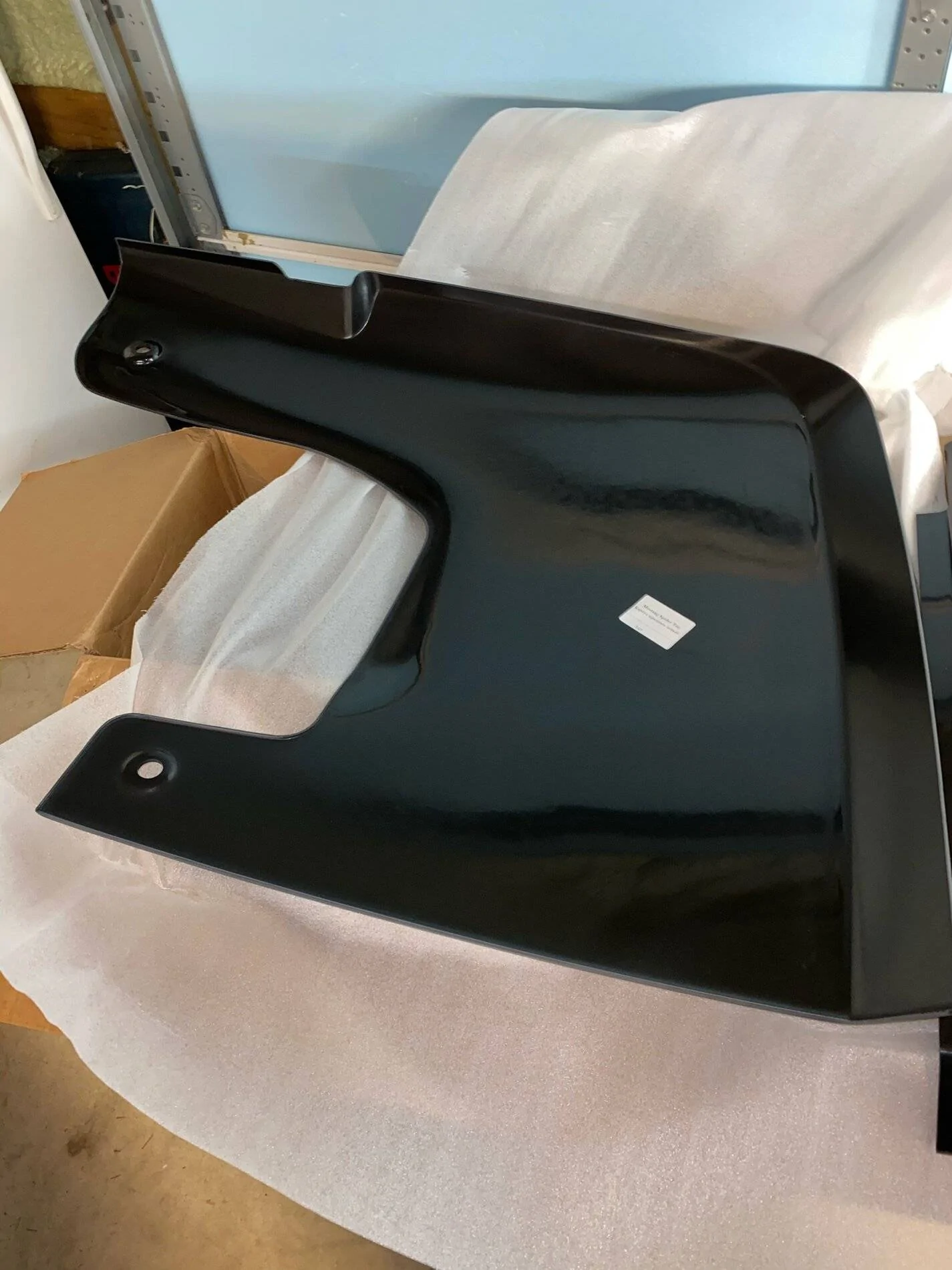

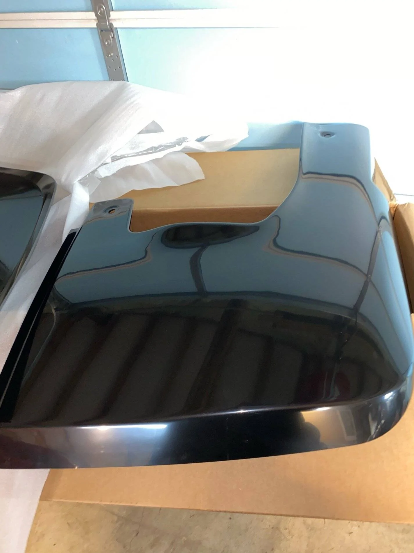

Well, after a slight setback I got the Clinched spider top installed. Got to say, it really is slick. At least my 83 year old mom thinks so!
Here is the box.

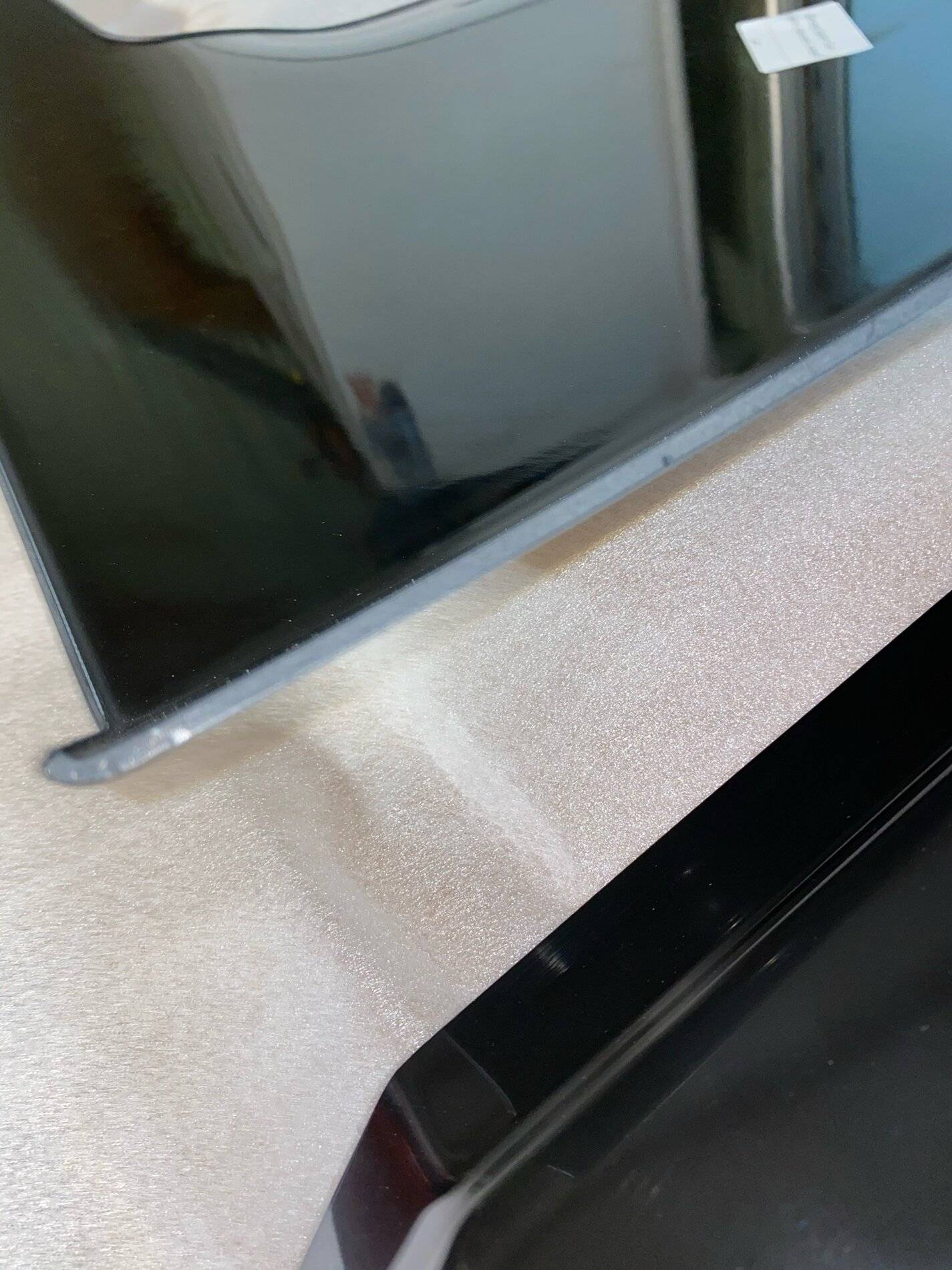

Be careful as each corner has a little surprise under the packing tape. I sliced Hell out of my pinky finger. At least the blood matches the Race Red.
So far so good. The top is very nice. Thick ABS. Fits well. I have to say thought that it really does need paint. It does not have a nice finish. I just need to decide if I paint it black or Race Red PQ to match. Hmmm..

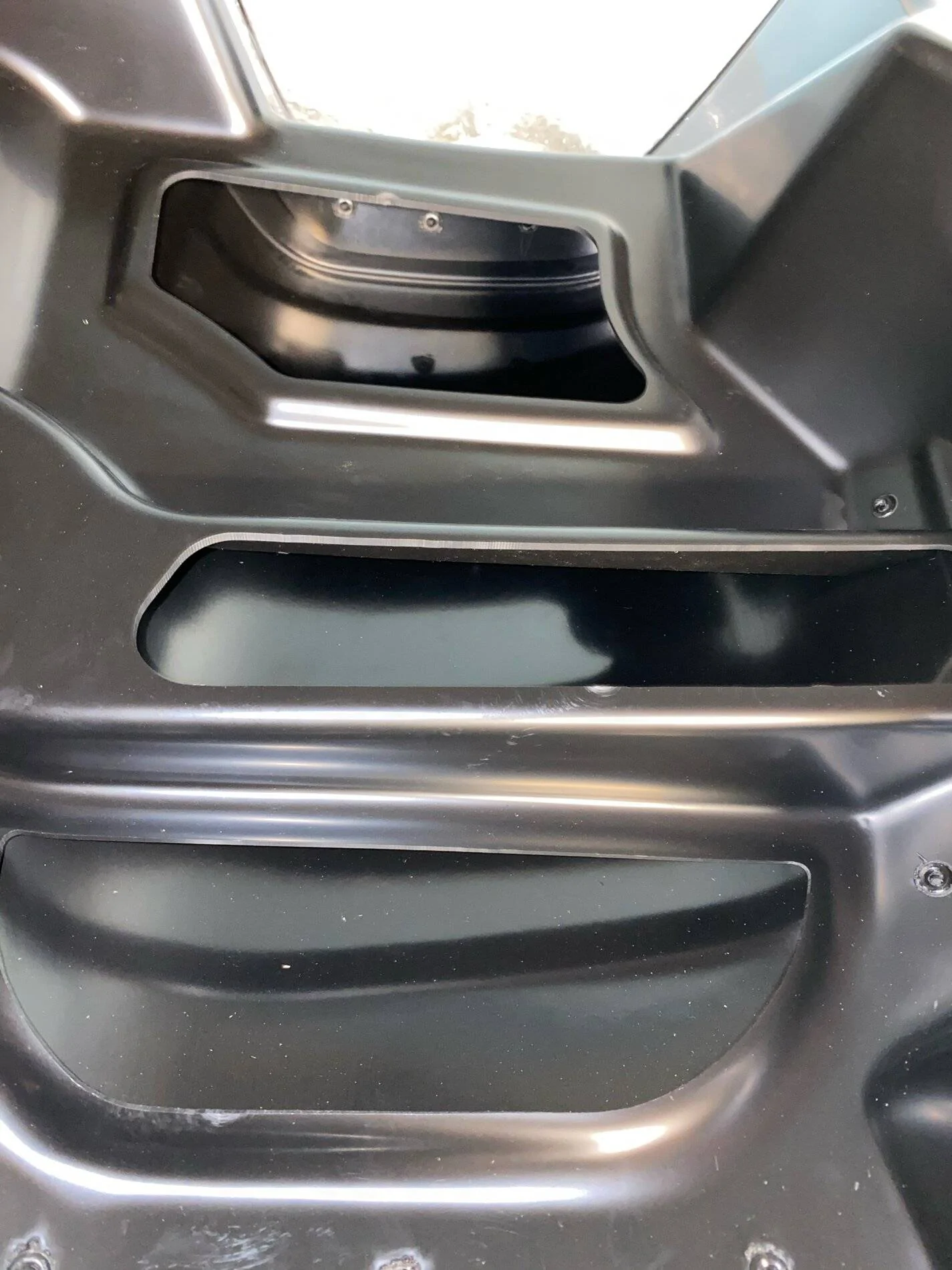

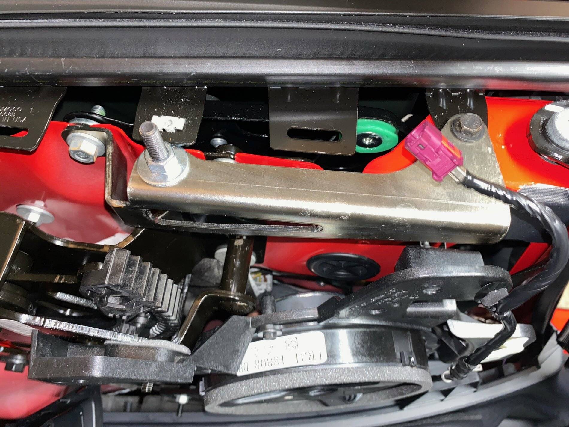

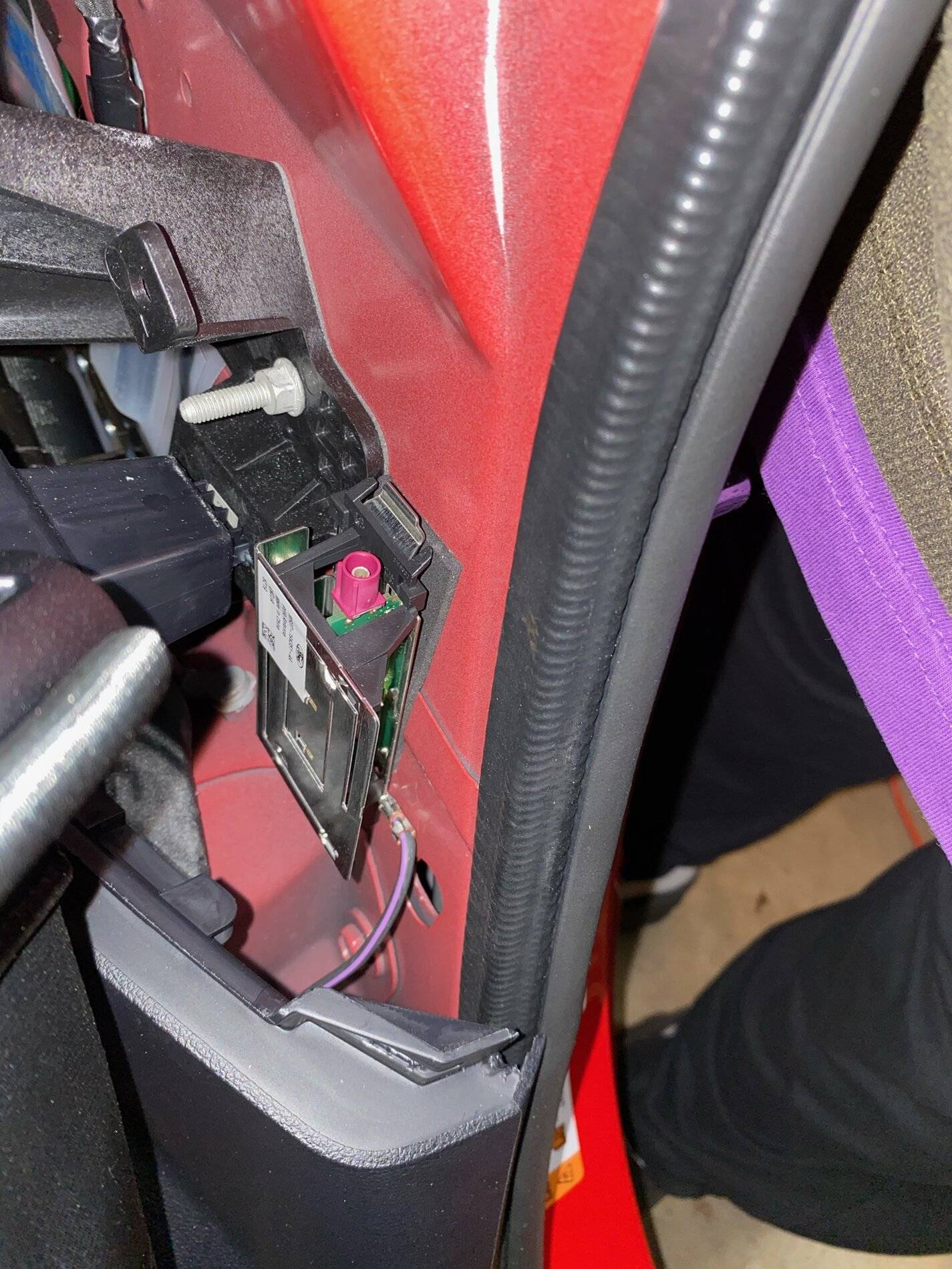

So now the bummer of the install. There were two antennae that were in the exact spot the brackets need to go. The video at Clinched doesn't have them. So, to use the top, I need to relocate them. PITA for sure, but it is doable and they still work after moving them (they are for the Ford Pass that allows remote start, etc). MAKE SURE TO DISCONNECT THE BATTERY BEFORE MONKEYING WITH ANY WIRES!
Here is the bastard (there is one the the passenger side too)
Here is the bracket:
Ain't gonna work...
So you need to pop off the bottom panel to get at the antenna. Here is a shot removed and one of the damnit itself:

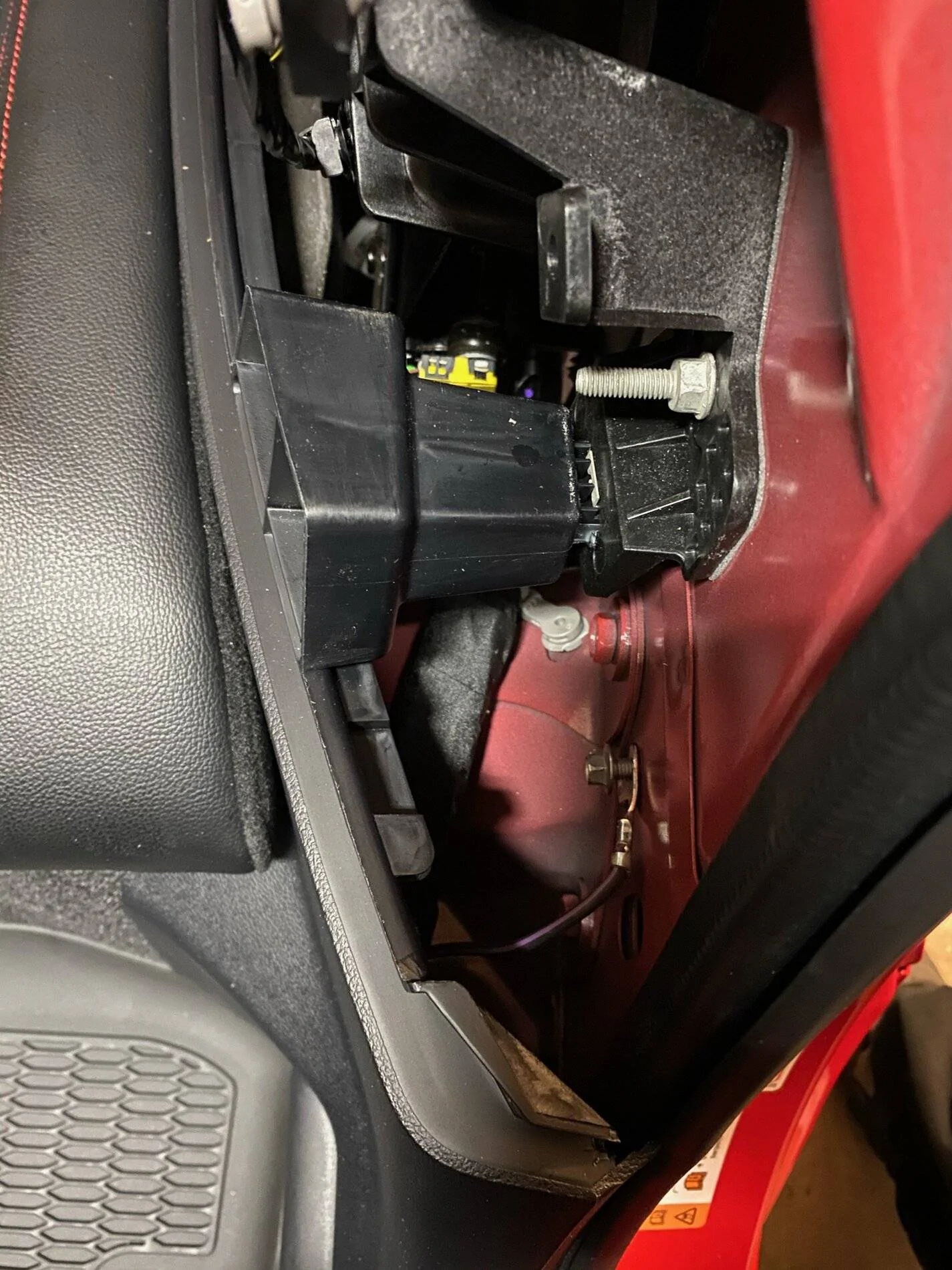

So now I needed to relocate that bugger and I wanted to tie it to ground. There is a ground wire that I was able to use (this is driver side).
There is also a ground wire on passenger side, but there is also some sort of fuse block or something in the way which made it more difficult. Unfortunately, my phone crapped out and I didn't get those shots.
After relocating the antennae the brackets went right in and the rest of the install was easy.
