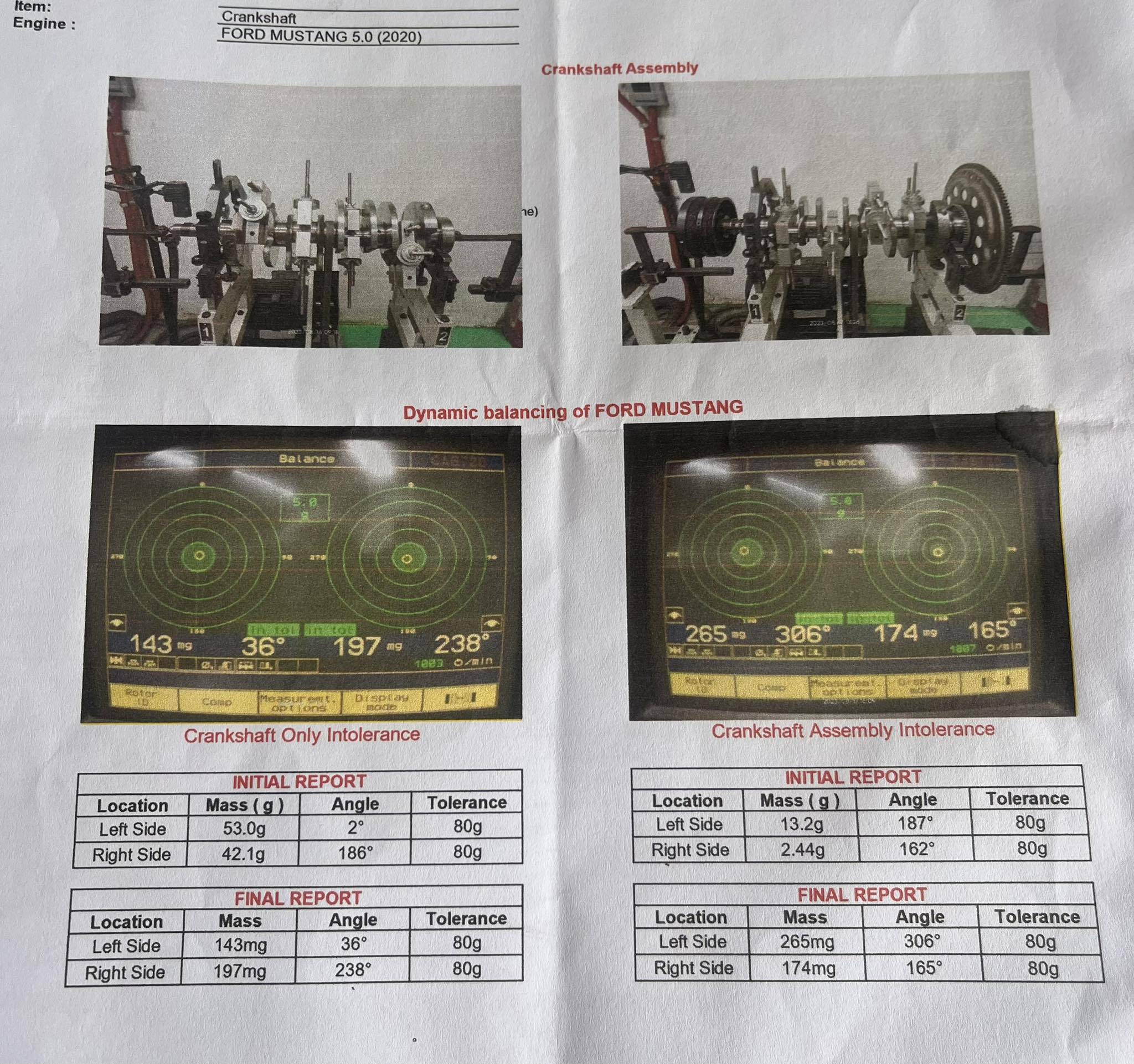

here are the attach image of the spoecs of the engine
