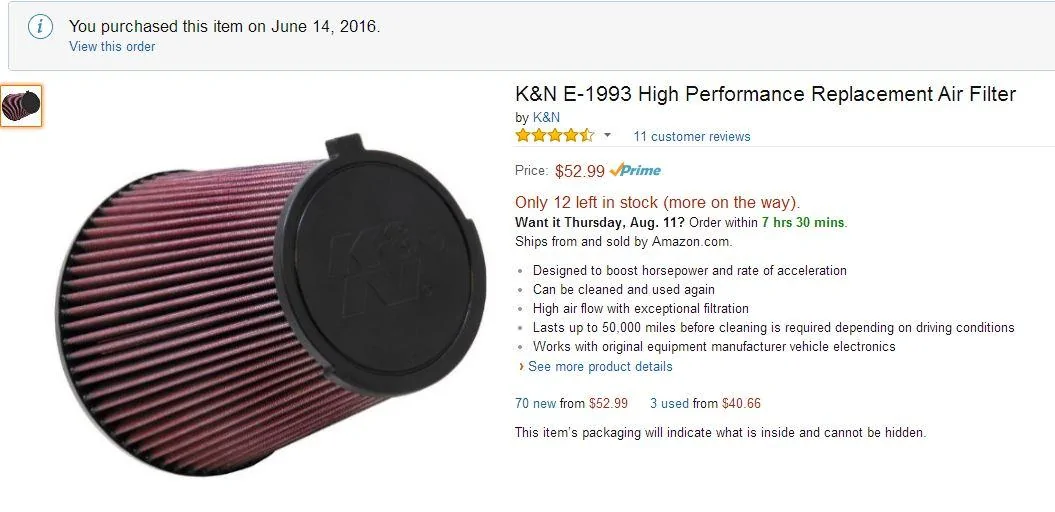

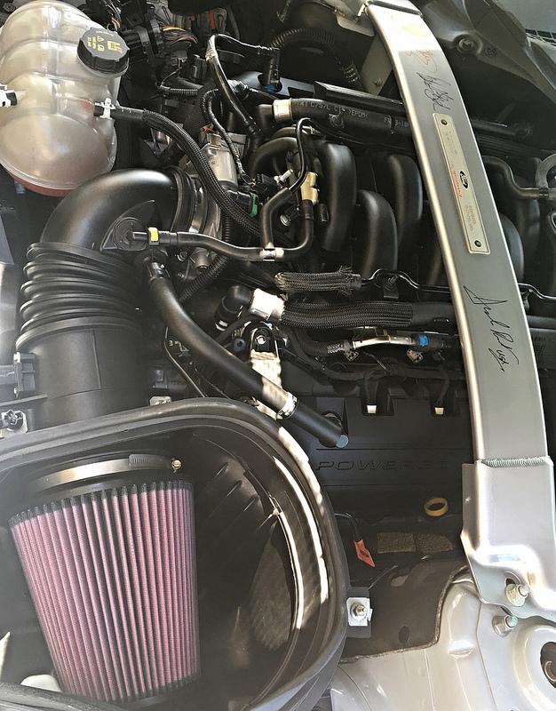

I opted for the non-oiled one since i didn't want to take any chances on possible oil getting inside the throttle body.
...or on the MAF sensor. Over-oiling an oiled air filter will kill a MAF sensor. I have dry aftermarket filters on all of my cars, more for convenience of not having to buy replacement filters than for the negligible performance gains.

the k&n site doesnt list one for the car, how did you know this one fits good? do you notice any difference using it?
Same size-model as 13-14 GT500

^Yup. This is for the latest GT500 versions and it's fine for the 350. Same filter size. Just like the Air-Raid too.
