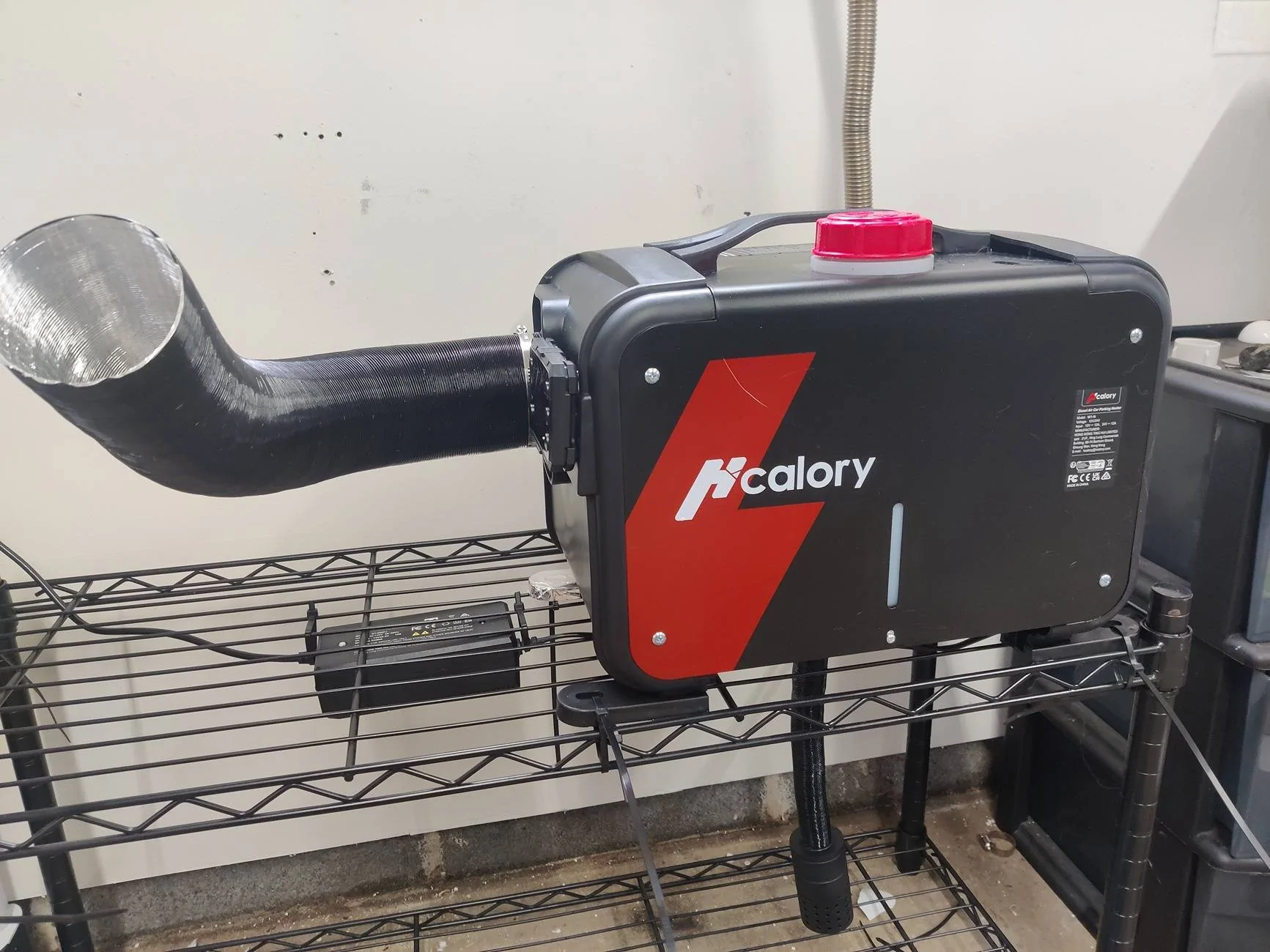

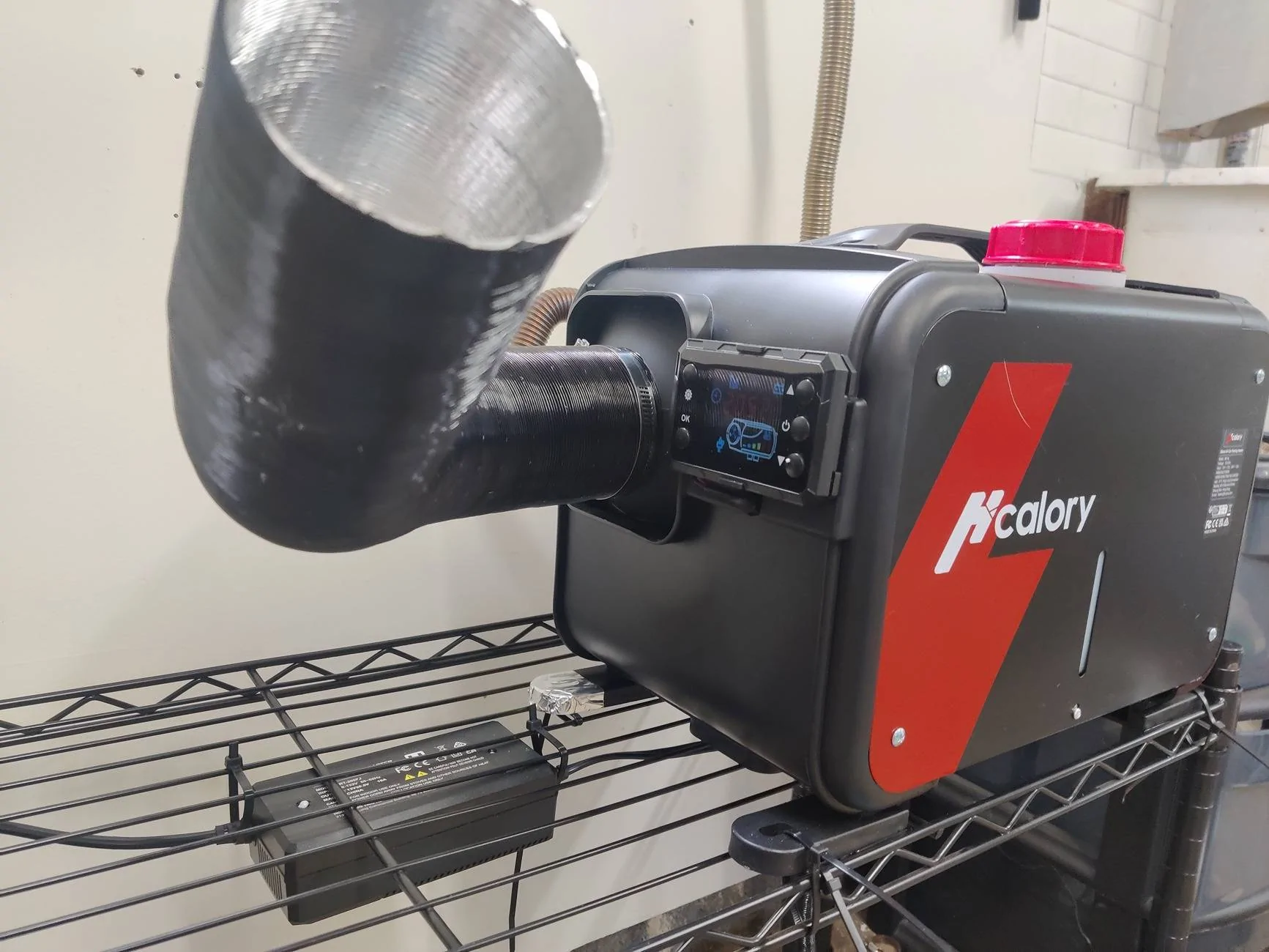

Here is mine
For reference I'm heating an 835 ft² garage with 9 and 1/2 ft ceilings that are insulated. The walls are sheetrocked but not insulated 2 garages doors front and back are not.
Since I've been using it the temperatures have been hovering in the low 30s for a high and low 20s for the low.
Impression: I'm actually very impressed Most of the YouTube hype was actually spot on shockingly. With it running on high it kept the garage at a steady 60° or higher depending on the outside temperature.
Fuel efficiency: The manufacturer claims of running 22 hours or more on 1 gallon of diesel are accurate if run at level two. Running it at level 6, 1 gallon of diesel lasts roughly 13 hours.
Fuel type: manufacturer claimed that these heaters can burn used motor oil, cooking oil ect. I tested this first by mixing half diesel half used motor oil. This system worked just fine. Switching to 75% motor oil 25% diesel I could tell the system wasn't running as efficient but it was still very effective. I did not test 100% motor oil.
Noise: My unit is very quiet when compared to hotdog/jet engine propane heaters.
Placement: I initially planned on placing it outside and piping the heater in. But because I was going to be messing with it and wasn't sure about it at first I wasn't going to drill a 3-in hole through my wall yet.
Exhaust: mounting it inside does result in the problem of exhaust heat. It gets pretty damn hot! So I used a through-the-hull adapter and a 2x4 and an excessive amount of aluminum tape to temporarily exhaust it through the window. I bought the extended exhaust tube for two reasons. One give the exhaust more time to cool before it comes in contact with anything. 2 it makes placement easier. Many people have been using old cast radiators and pipe the exhaust into them and then outside. This also reduces the exit temperature and reclaims a lot of heat making the system more efficient.
Safety: It's combustion! all the typical rules risks and safety apply. Carbon monoxide has not been an issue. My carbon monoxide alarm shows no parts per million. My handheld detector shows a slight amount by the exhaust but registers nothing in the general space.
Compared to some propane solutions this is a benefit. As with hot dawg heaters you should have a window cracked/open to avoid carbon monoxide build up. This also doesn't create the humidity that propane heaters can.

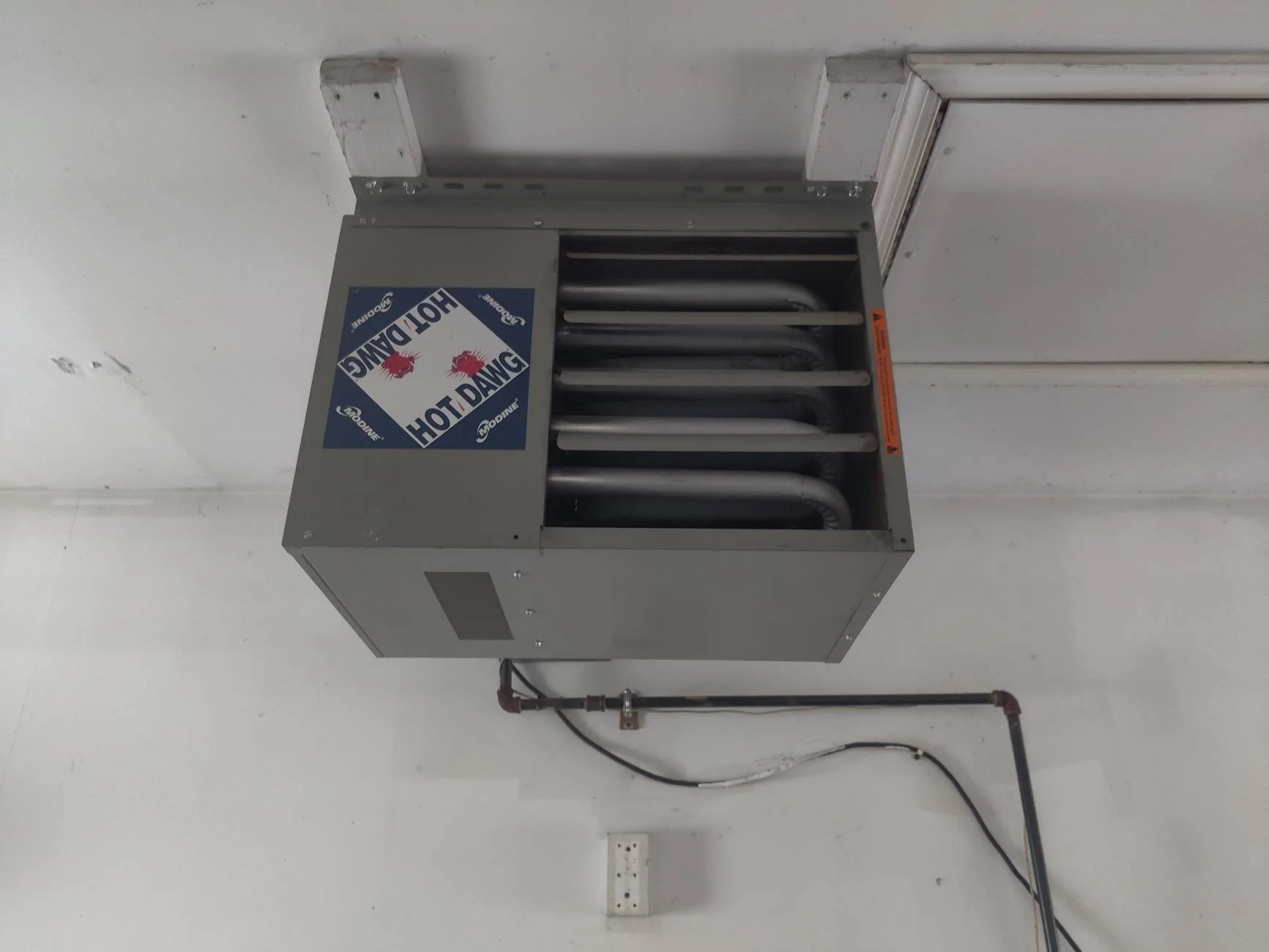

I was comparing its effectiveness and ease of use to my ceiling propane heater.
Obviously the propane heater will bring the garage up to 70-80° very quickly. The Diseal heater takes much longer. The irritating part is im tired of lugging a 100 lb propane tank around. And propane delivery services irritate the s*** out of me. Going to the store and getting 5 gallons of diesel that'll last me a week if I run it 24/7 Easy.(I won't run 24/7)
