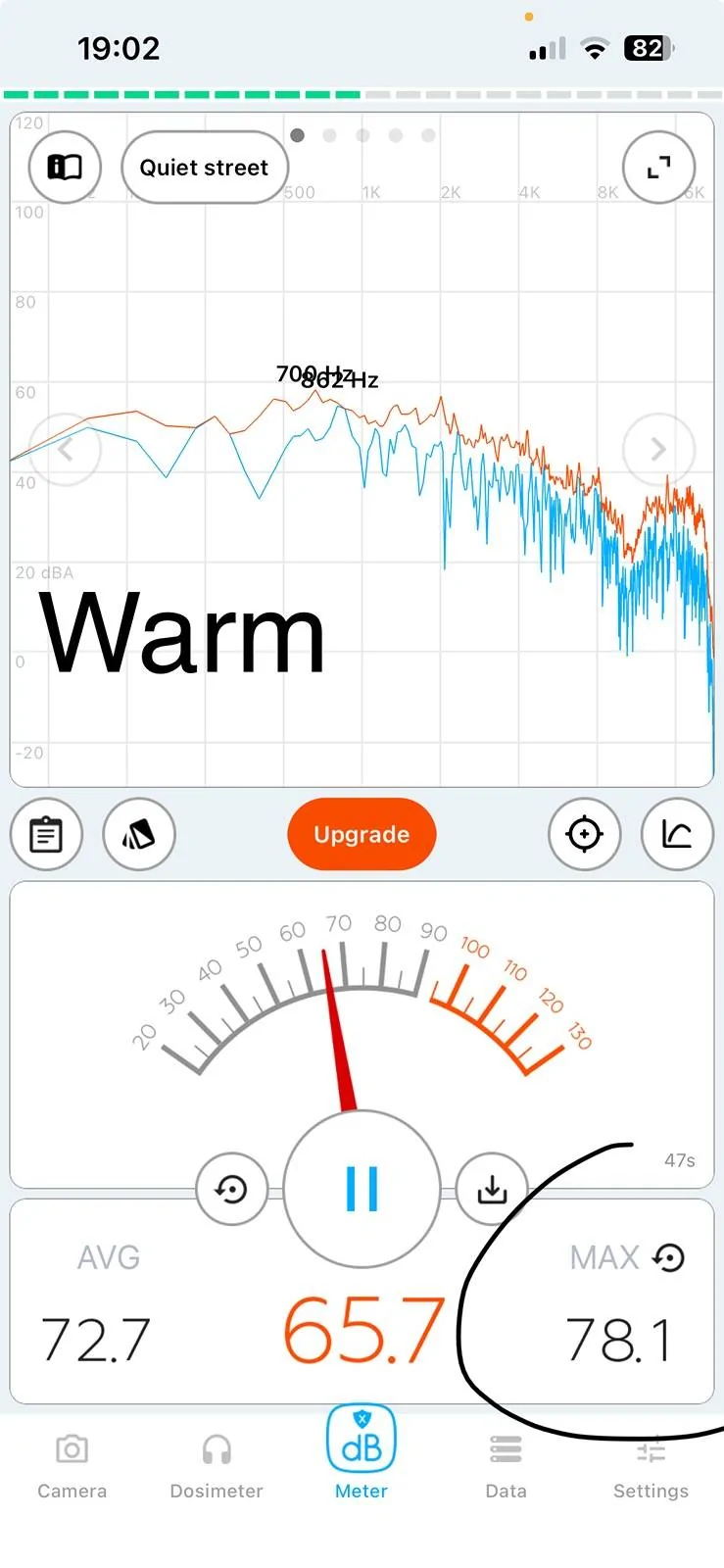

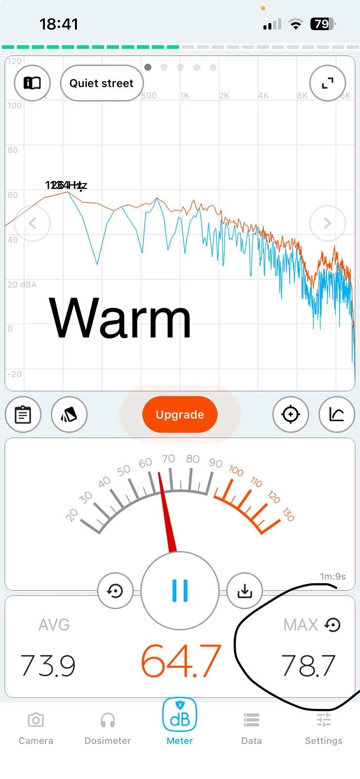

took decibel reading of warm engine before and after cera tec
added 150ml. Cera tec instructions call for 600ml based on 10 liters of oil.
currently running PUP 5w 30
78.7 before
78.1 after.
will check again after more driving to see if it gets quieter

I've had the tick since I can remember, I purchased the car in April 2019.
Apple app store free app Decibel X.
I still need to record the cold start results. I took a decibel reading on the cold start pre cera tec as well. I will post the results when I have time to do it after work in the next few days.

I would be very curious what the measurement error on that app is as you're showing 0.77% difference between your measurements. You're likely observing measurement noise. Looking at a cheapish dedicated DB meter on Amazon those are +/- 2DB over a span of 30 -> 130DB which 1.6% measurement error. I would assume a cell phone app have a higher error threshold as well but that's just a guess.
All this is to say, there is no real measurable difference between cera tec before and after. At least given the data that you've shown here. I personally don't care if it works or not and I'm just speaking entirely based on how you're drawing your experimental conclusions because its what I do for a living.

Yes, I did. Totally agree on the tick being less apparent.
Like I mentioned above I have no skin in weather it works or doesn't. Ford won't tell us what it is, why it happens to some cars and not others or why cera tec does seemingly work to fix it (I even have a bottle on my shelf waiting for it to show up on my 22).
I was just trying to point out the likely measurement error in using the DB meter on your phone app and generating misleading data as a result that cera tec did or didn't cuase that's all. No ill will or anything intended.
