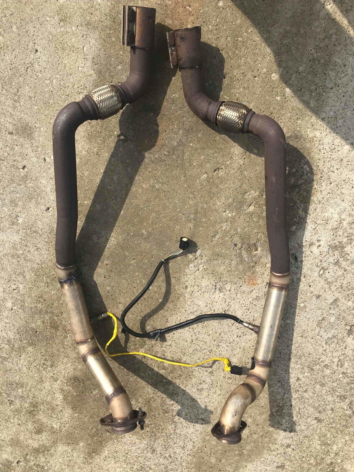

I have included a photo of my custom downpipes that are catless for a turbo application just so you can see the connectors are the same that will bolt up to any catback exhaust application whether GT or V6. These downpipes also have the extensions welded in. Hope this helps.

No man no extensions for what your doing. I have extensions because those downpipes moved the stock location because the turbos moved the location somewhat.
