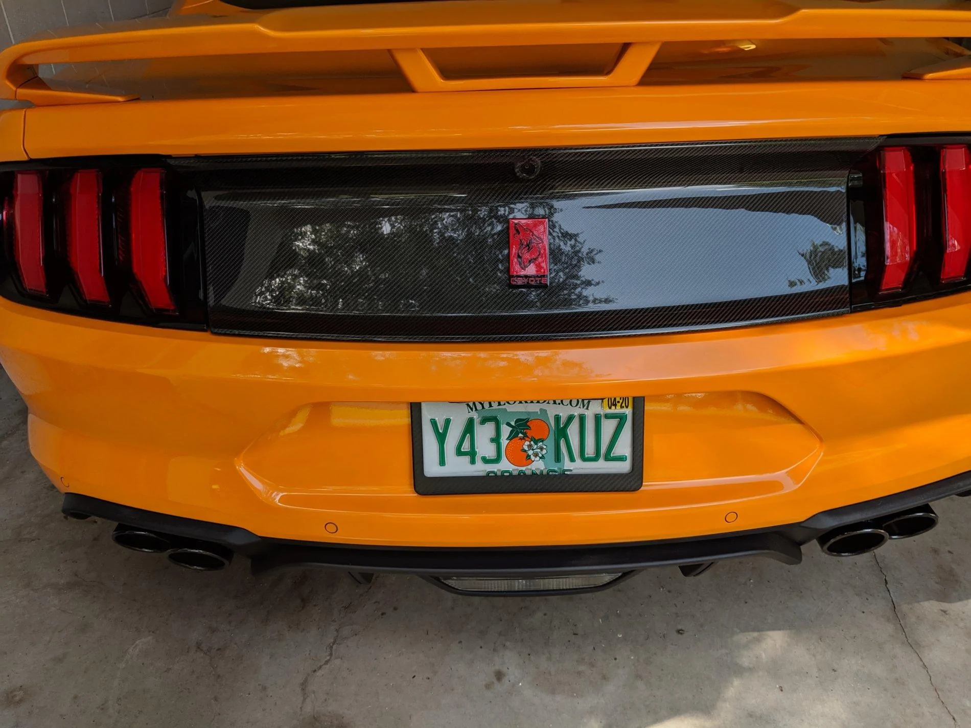

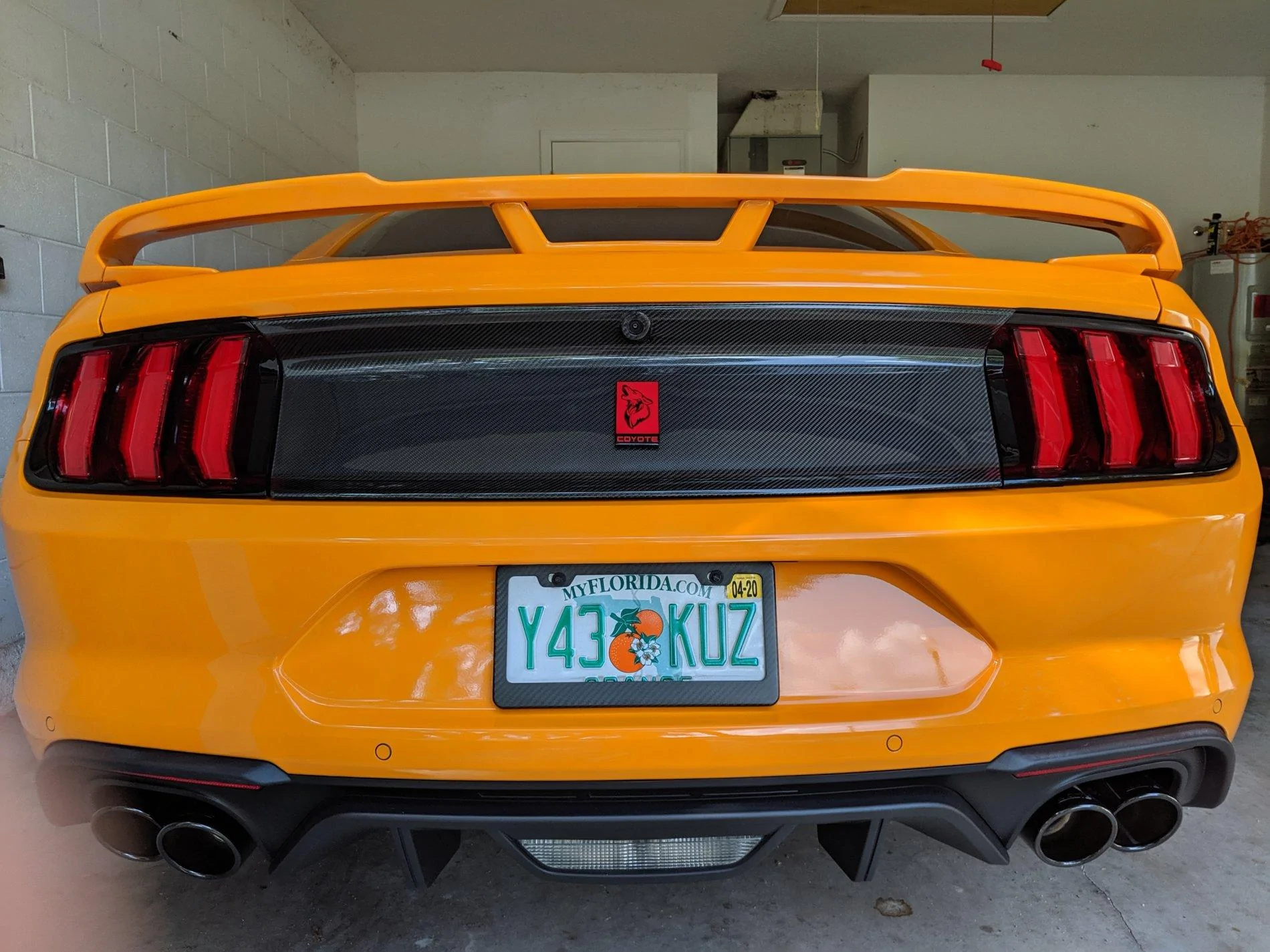

Against my better judgement I gave it a shot. Worst case is I just get a blank decklid after I screwed it up. Amazingly, it went well! You can't even tell unless you're like an inch or two away from it. Also the howler badge I put on really completes the look, for me anyway. Thx for the help
