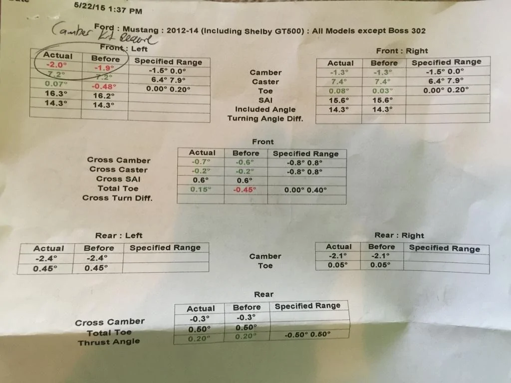

Has anyone else needed a camber kit for proper alignment on Eibach Prokit?
As you can see my front left is off some. I was told by Firestone that i needed a camber kit to correct my alignment.
I have Sportlines installed.
Could someone would chime in with some knowledge

I believe Eibach says the sportlines will require a camber kit, but they also say the prokit is alignable to factory specs. In a momentary lapse of reason, I approved the installation of a rear camber kit, so I own it whether I needed it or not.

It's like a degree or less, maybe barely more off with prokit... it's really not worth bothering about for a lot of us...and it won't pull either way.

I bought a set with my CJ Pony lowering springs. I had So Cal Suspension install the set. Nick the owner told me it really made his job easy with the cambers getting the front end aliened.
