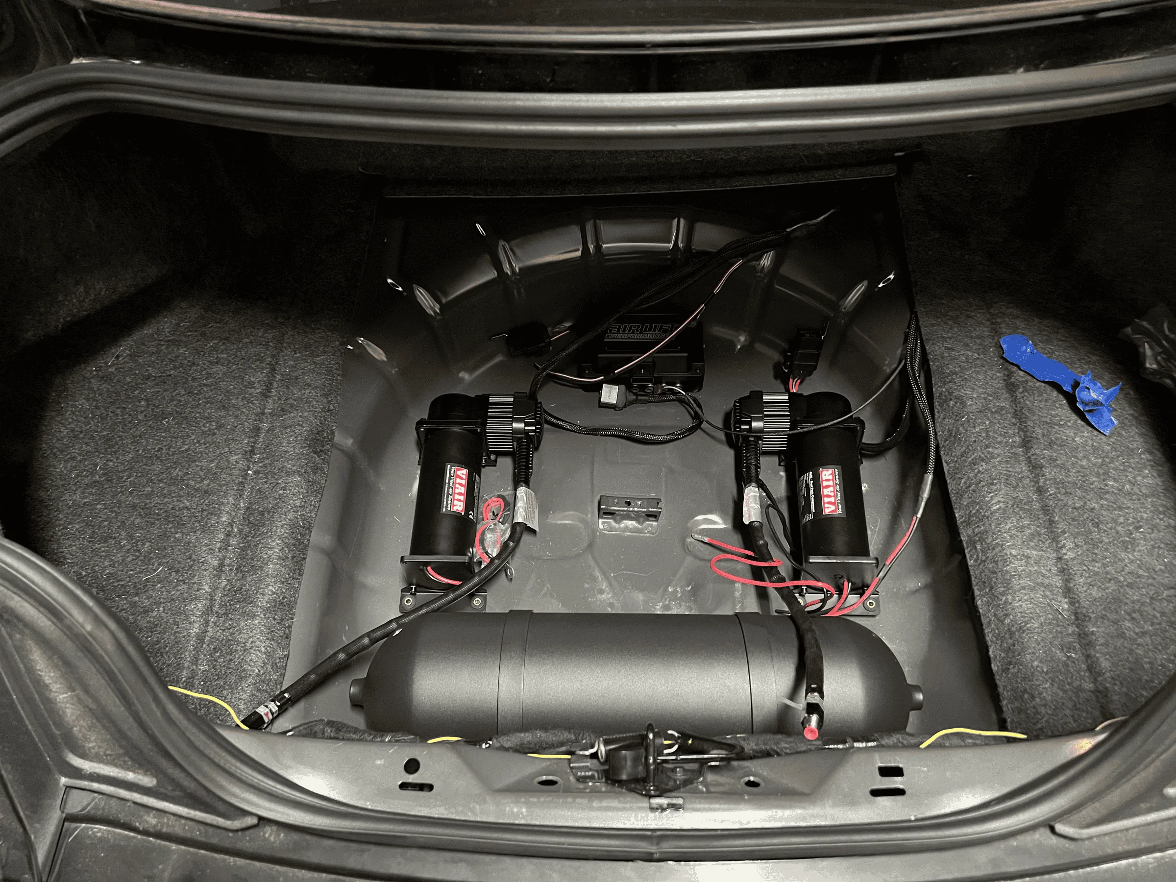

Not just of your bagged Mustang in general, there's already a couple of great threads for that. I would specifically like pictures of the trunk. I'm going stealth install because mine's a daily and I want full use of my trunk, so those'll get bonus points. So how are your harness(es) ran into the well? Where'd you mount your relays? Why am I so indecisive?
I'll attach a mockup of how the layout in the well is going, but I cannot figure out how best to route the Air Lift harnesses. I have them coming from the upper right of the picture after coming through the hole where the rear seat belt spools, but the thickness is causing the carpet to pop up a bit. I figure I can cut the insulation under it and there won't be any issues, but wanted to see what others had done first. Had planned on relays kinda where they're laying, but would like them to be out of sight if possible.
Appreciate your help!

That how I wanna run my setup in the future. Except with a polished tank. Is that a 2.5 tank or 5 gal?
Neither. It's listed as a 4 gallon tank - one of the seamless aluminum ones. Only has 3 gallons of capacity tho.

Do you have to fill up often?
