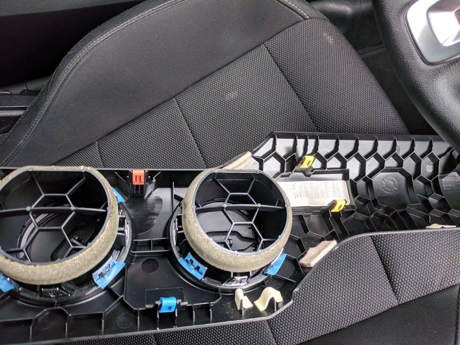

There are lots of clips in there to gorilla off, this isn't the full thing but should give you an idea. If you check the Sync 3 conversion thread you might be able to find the link to the replacement clips. There are some orange ones available on ebay for $12 for a set of like 100.

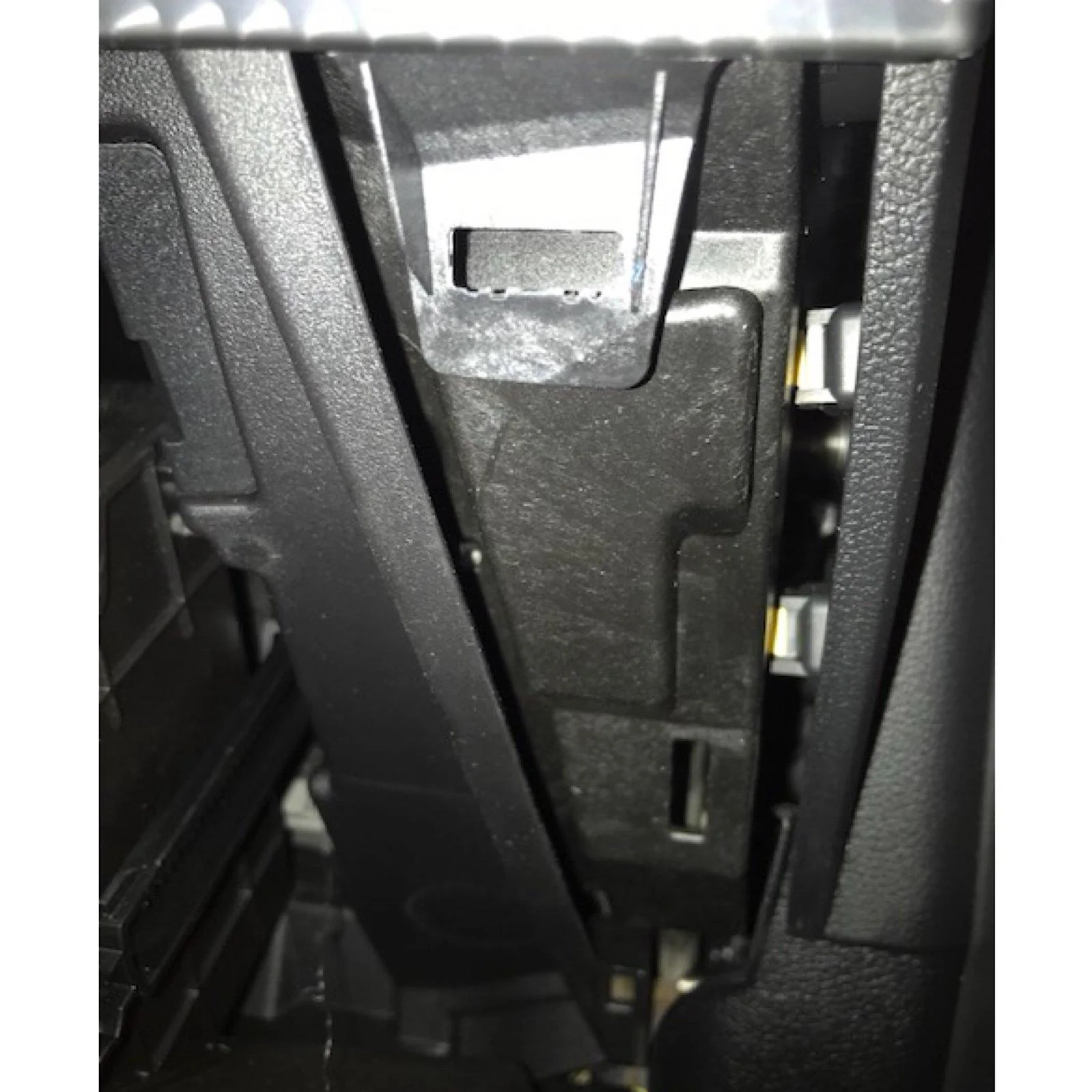

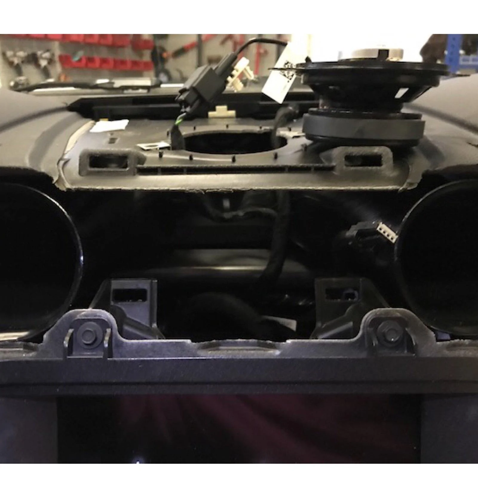

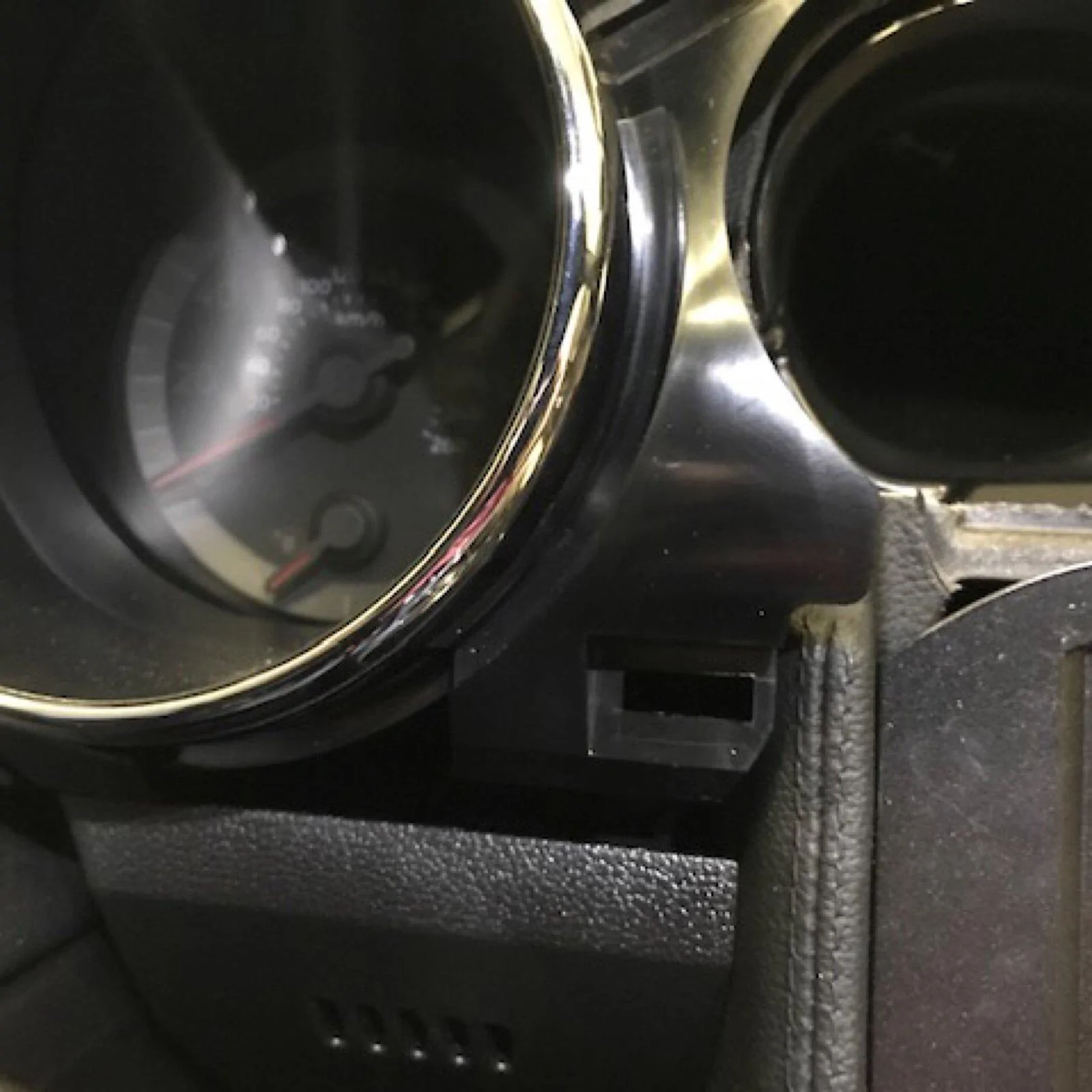

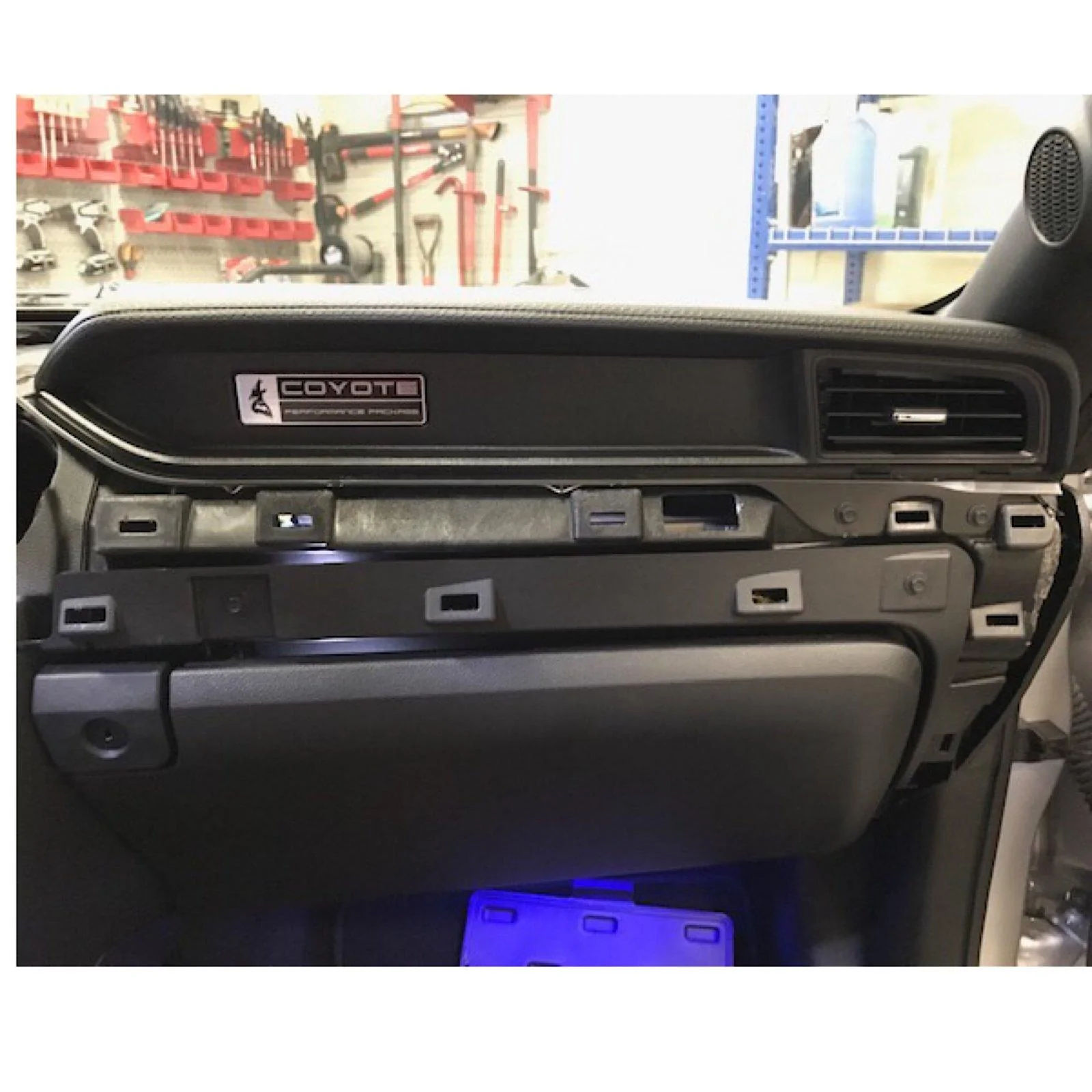

Not sure how much use the trim tools will be. I have a decent set and they did nothing for me. Start on the far right and work your way left back to the wheel. While I didn’t break any of the tabs, 4 of the tab clips came off of which 3 were recovered. Might be handy if you could get the tab clips prior to the project. Good luck with your project. I’ve attached a few pics so you can see where the tabs are and where to apply steady pressure. I’m interested in seeing how this turns out.
