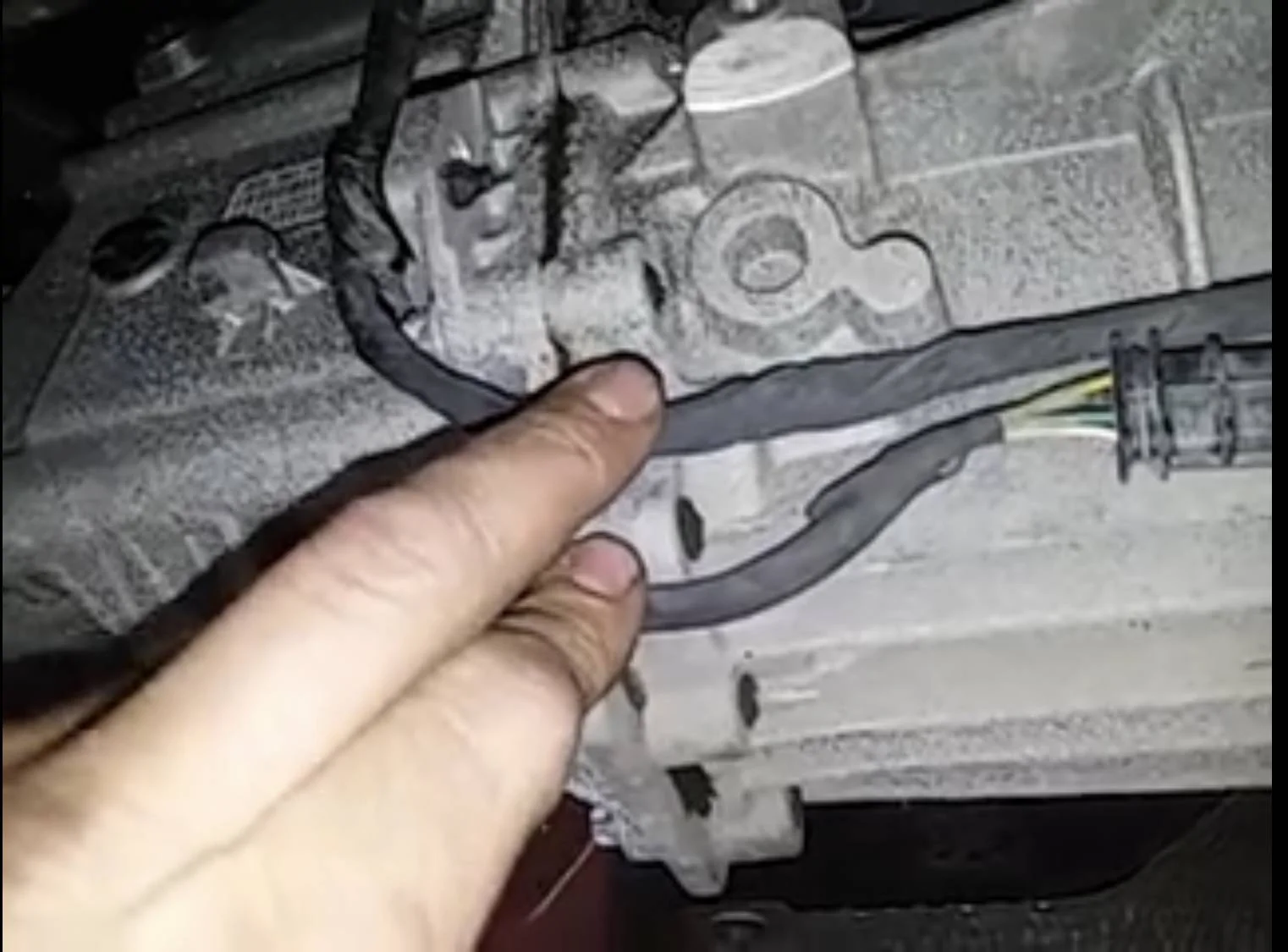

Nothing too specific, was hoping for a location/view on the trans. I’ve seen a few pictures, but still not too clear on where it’s supposed to be.
Attaching an image of my trans where the sensor is “supposed to be” (per the one Ford dealer)
granted this isnt my car however its exactly the same as mine but its this part right here
