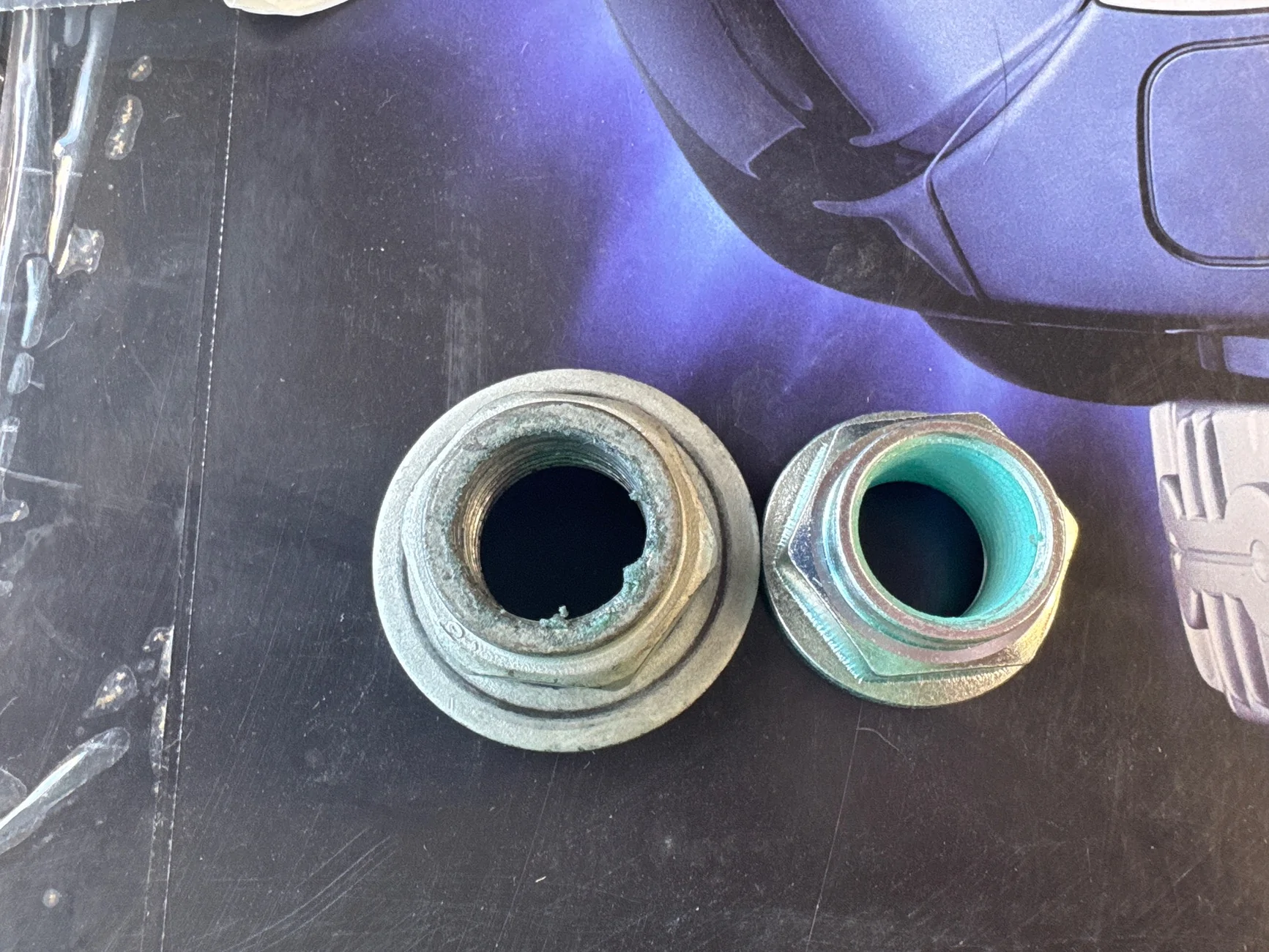

I have a 2016 Mustang GT with Brembo brakes. I’m changing pretty much everything in the front suspension, arms, brakes, lines, etc.
I ordered front spindle nuts but they are too small. Is there any difference from the Brembo and non-Brembo spindle nuts?
maybe they accidentally sent me the rear axle nuts? I’m unsure at this point if any one could help I would appreciate it.

The right one looks like a rear axle nut to me.
Front should be FR3Z-3B477-B

I believe you’re right. Thanks for the P/N, I was looking them up and it was just throwing me off in the descriptions stating non- Brembo.
