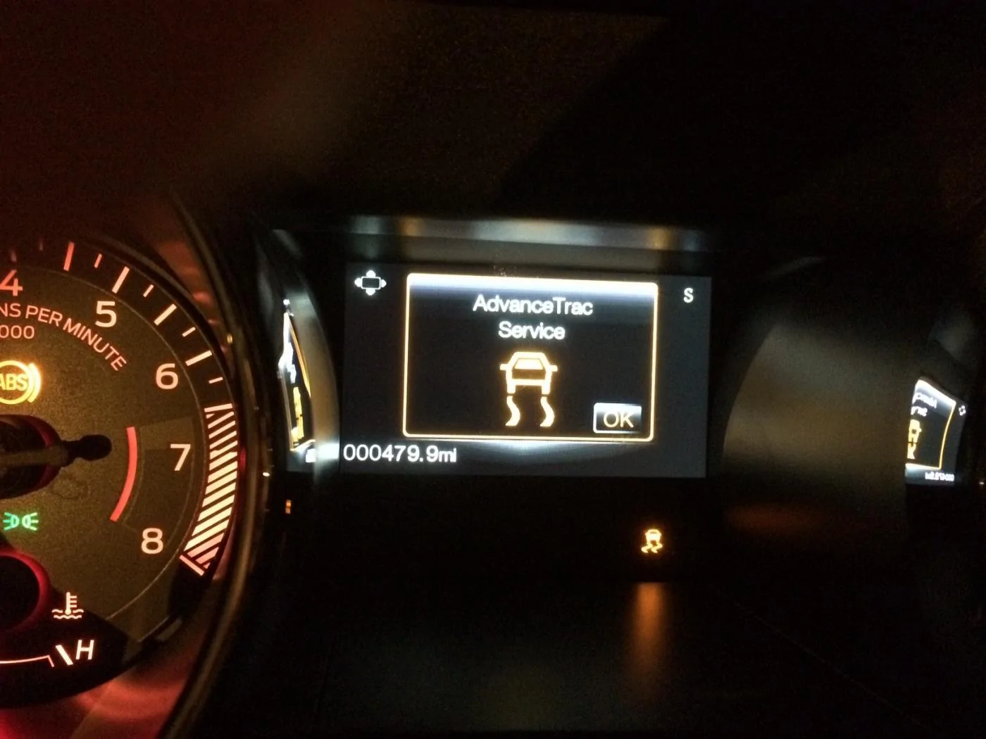

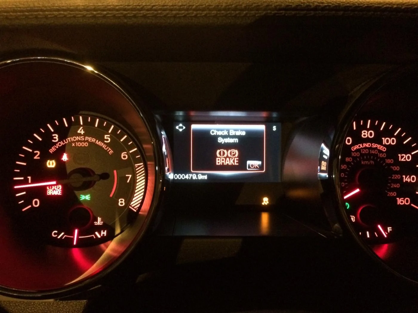

I parked after coming home from work earlier today and had to move the car.
When I fired her back up; the center screen lit up like a Christmas tree.
TPMS light is on because I don't have sensors in my winter wheels.
Any ideas?
My owners manual says that I should panic immediately and give my Ford dealer money!

Well, I just started the car again and there was no change from last night.
I pumped the brake pedal a few times, got under way and everything went back to normal.
Weird! First year car I guess!

No... easy fix had same issue. Systems affected include abs, hand brake engaged, cruise control, driving modes, steering modes, hill assist, tmps. Ford painted over bottom ground contact area beneath air box and used painted bolt to secure grounding wire. Fix sanded ground contact area to metal and replaced with nonpainted bolt.
