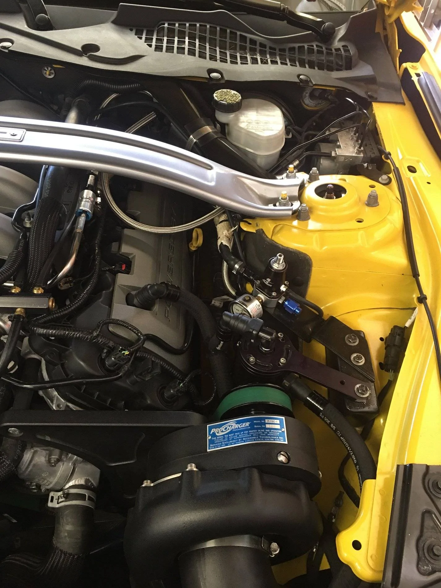

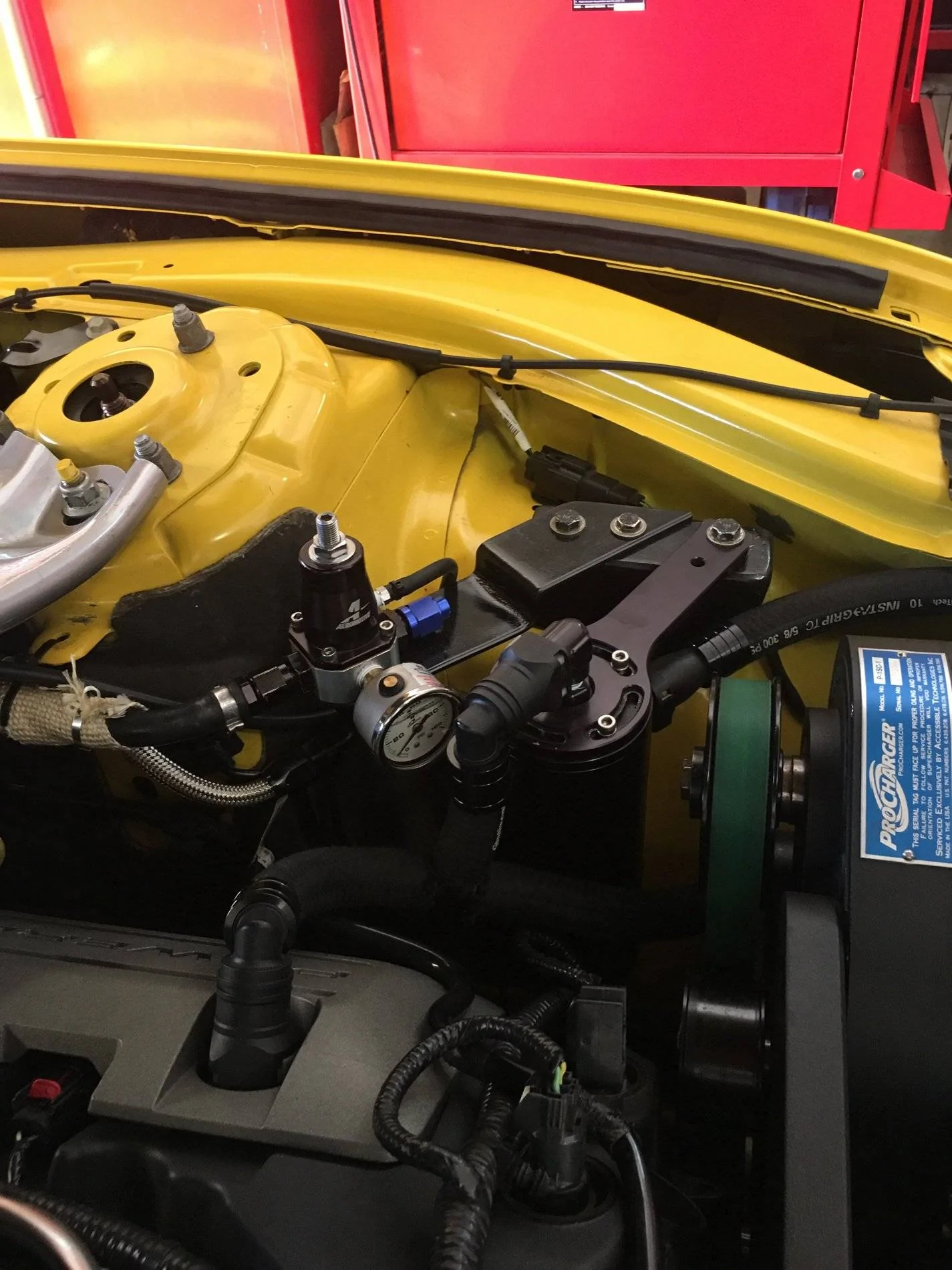

I thought I would show you guys a quick bracket fab I made up for mounting the upr catch can and regulator in my car. Hard to find a good spot without drilling holes in something (which I refused to do)
so I think this works really well. It just bolts through pre existing holes with a couple fender washers behind the wheel well liner so you’d never see them. Top bracket holes are tapped for easy uninstallation/installation. Super rigid as well.

Nice job! What are they bolted to? Is that an big chunk of plastic bolted to the inner fender?

No it’s steel.. a hollow standoff, with captured nuts internally, so you can just thread in the mounting bolts from the bottom.
