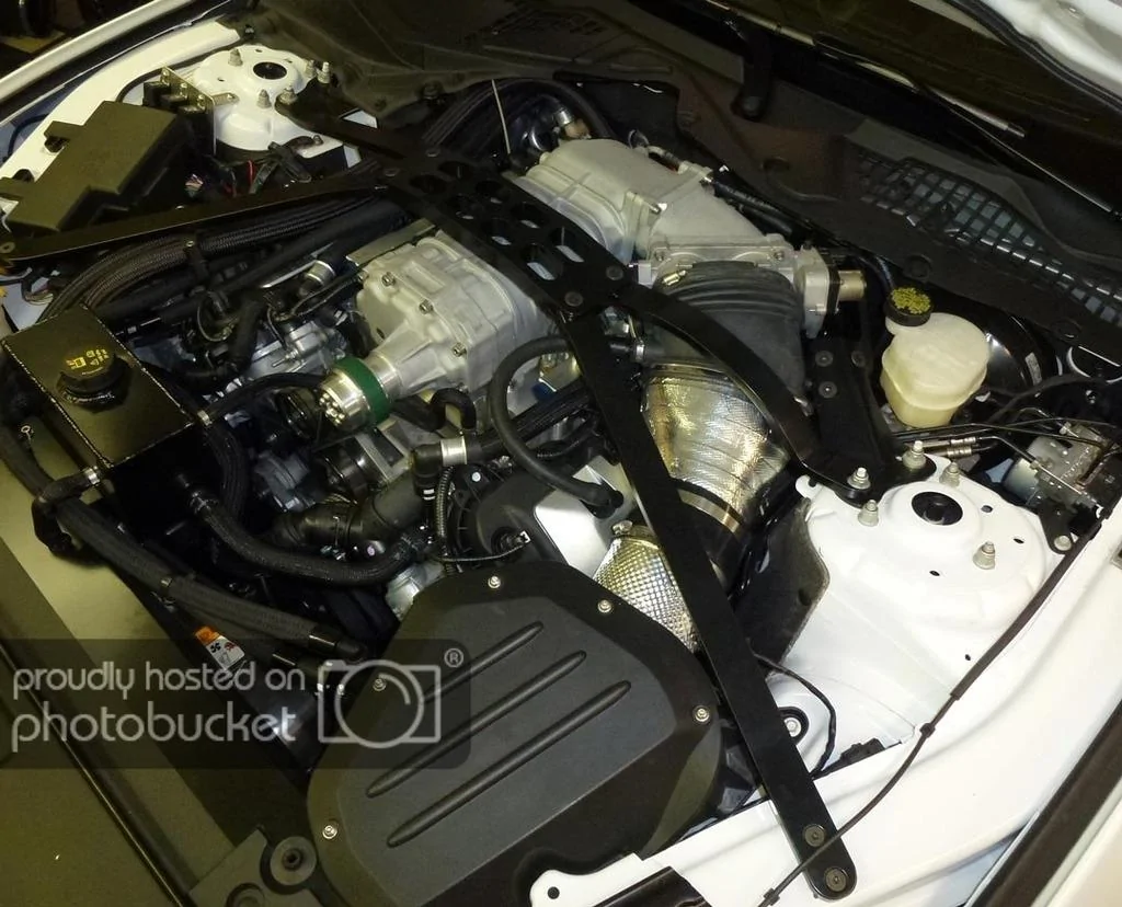

2015 GT/PP white
While the M122 blower is hardly state of the art it makes 550 RWHP for relatively little money compared to all the other PD blowers out there. And runs cool as you could want when running the 1 1/4 inch lines the manifold is designed to run. I have that setup on my 2015 and am perfectly happy with the system and the power. That price for the blower seems high unless he is including a host of other parts.

^^^ Looks good. I waited forever for them to release their oversized HE several years ago. I gave up on them and bought a triple pass VMP. Looks like they have FINALLY gotten passed their love for 3 valves and entered the Coyote market johnny come lately. I speak out of frustration because I waited and waited and waited. DOB has awesome articles and done tons of research of various models. I'm glad they are finally FINALLY in the game on the Coyote engines. Aside from frustration of promises of release and then crickets I have no qualm with this place. They are state of the art. The setup looks nice. And if it's like the 3V intake you have several options that can sit on it.

Best thing of all about that kit is ANY direct fit GT500 blower upgrade would also work. Which has always made me wonder why this kit hasnt caught on more!!
