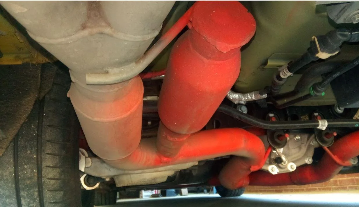

I posted in another thread that I welded in a Helmholtz resonator to kill the drone on my full Outlaw exhaust. LT's and 3" O/R catbacks and no drone, It's stoopid loud.
You can waste time and money doing other stuff but that is the only thing that will eliminate drone from the Outlaws.
