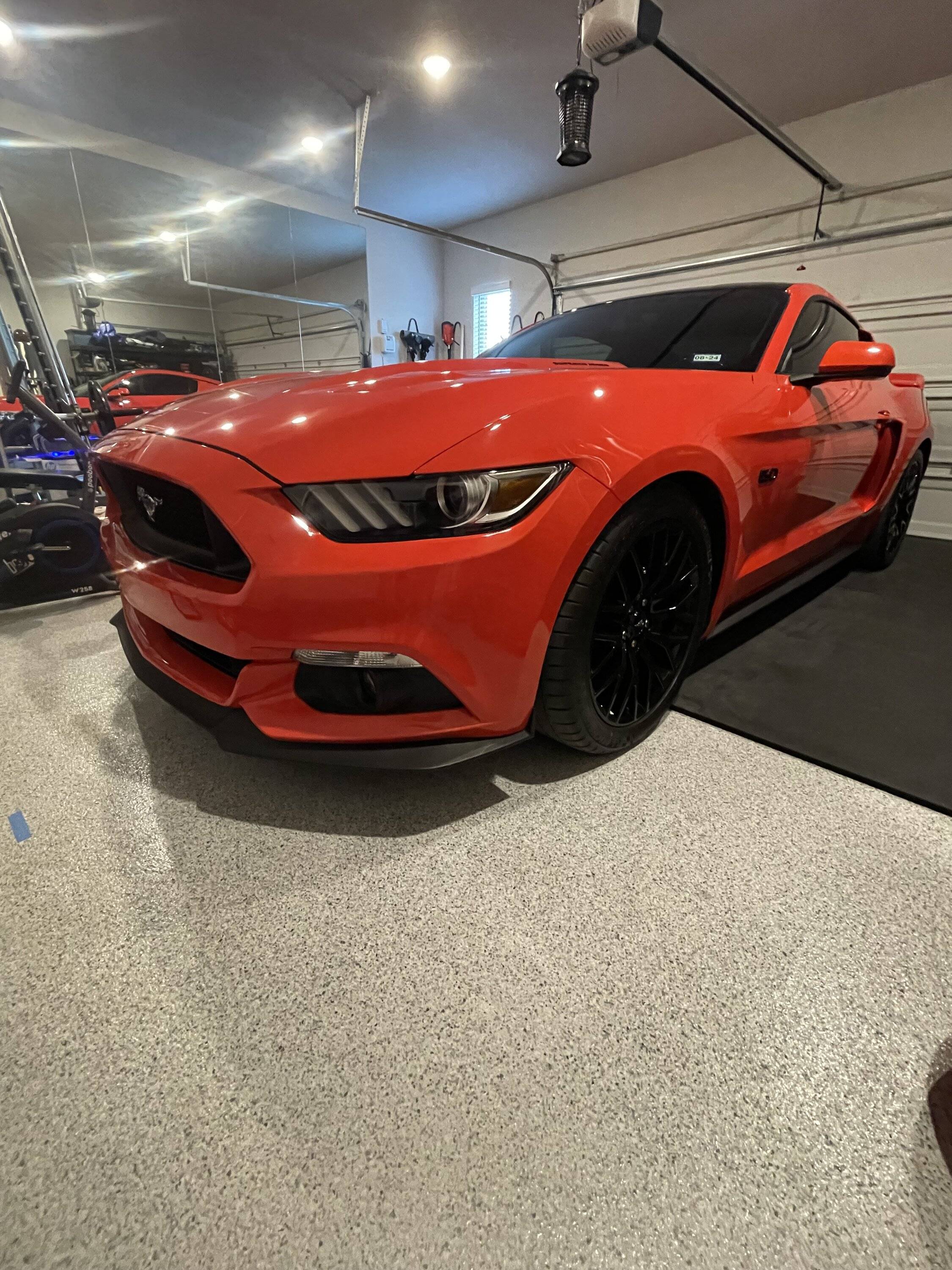

Hey there,
So I’m finally back in the Mustang family after a 17 year break. I recently picked up a 2016 Mustang GT Hennessey HPE700 with 4975 miles. So I’ve been researching details regarding the 2.9 twin screw supercharger the original owner had installed. I’m wondering what upgrades I should look into. Also it has the 4.00 pulley, are they any gains if I go to a smaller pulley. Any assistance/feedback would be greatly appreciated.
