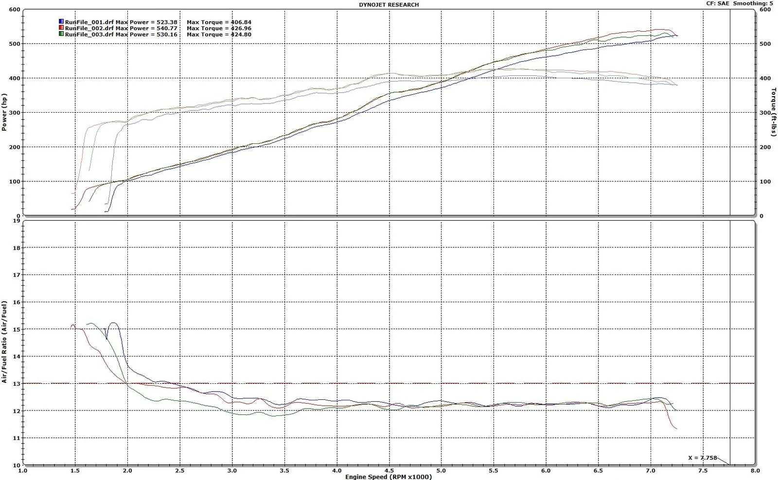

Thats the biggest factor.It may be a little low on power because Lund was trying to get rid of my knock on 91 octane (garbage AZ gas), before I eventually found some 95 to put in. Maybe a tune targeting 95 will net me some better results.
The power levels on these cars can vary SO much with fuel quality.
Since the motors are so sensitive to knock due to the CR
