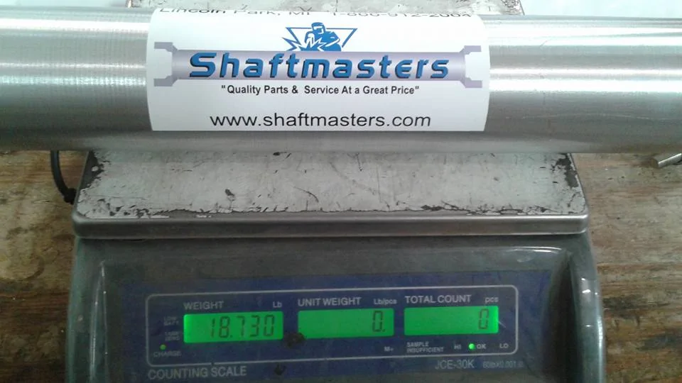

I just got mine in, and first thing I did was weigh it.
18.73lbs....for a weight savings of 17.4lbs. THAT is awesome if you ask me!
