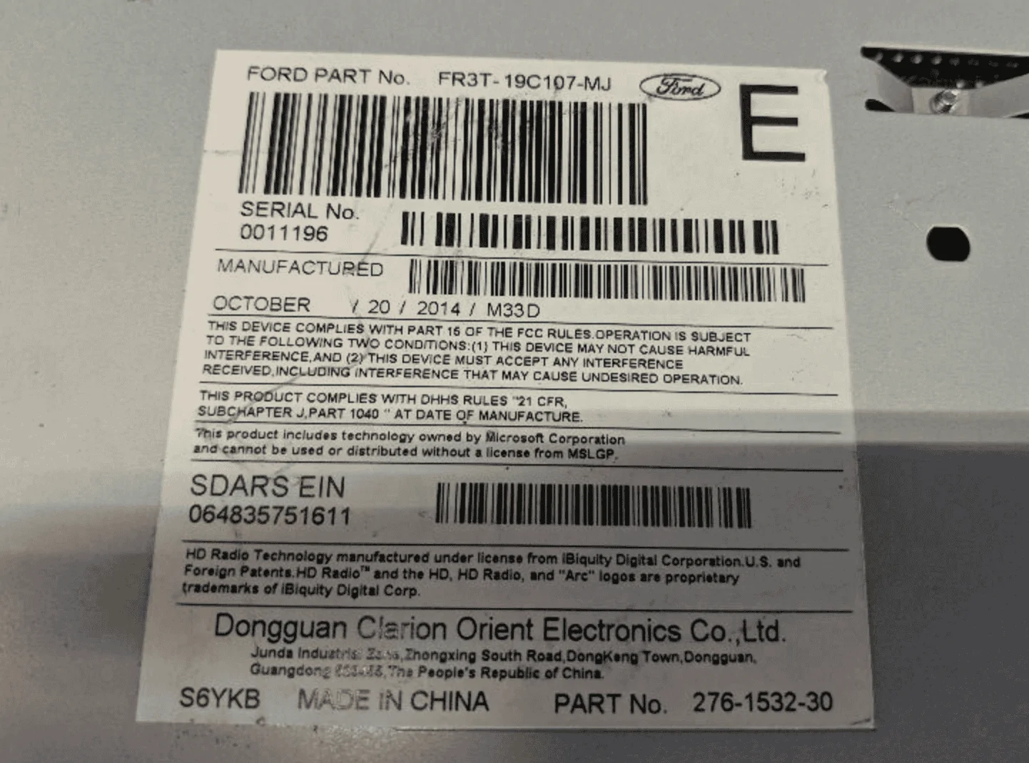

Just bought it here, if the ACM has the little tag on bottom "HD RADIO tech", if it does NOT have that sticker, it is not an HD acm. end of story. but yeah, got it with 15% off. I guess it came out to 152 correction.
Then all I did was install it, took a few minutes, you pop off the top dash trim silver thing that goes above radio, pull a few screws, pull radio faceplate off, bam, swap out the acm. I did it with help left everything else intact, small hands helped reclip the connections.
After that, you have to change a couple lines of code using forescan, like Enable HD radio. think there was one or two codes. took a minute no more. Heres the codes
HD radio enabling 2 codes below
APIM 7D0-01-01 xxxx xxxX xxxx 2= HD No 3= HD Yes
ACM 727-01-01 xXxx xxxx xxxx 8= HD No 0= HD Yes
+ I would also toss this code in it. It made my stock radio sound SOO much better.
Disables factory EQ -bass roll off disabled, active noise cancelation disabled, and also disables fake engine noise for ecoboost. It just made the speakers sound clean, louder, clearer and crisper.
ACM 727-01-02 xXxx xx 0=EQ Off
This is the ACM I bought, you can see on the picture of the backside on the bottom
https://www.ebay.com/itm/2015-2016-2017-Ford-Mustang-GT-HD-Audio-Equipment-Radio-Receiver-FR3T-19C107-MJ/254120570543?ssPageName=STRK:MEBIDX:IT&_trksid=p2057872.m2749.l2649
Does the HD ACM have to be from an S550 of the same year, or can it be an ACM from any Ford? I’m just asking because I noticed the date on the sticker reads 2014?
the 14 sticker came out of a 15 car, so as long as its from a 2015+ its fine. The amp I pulled out of my 2017 car, said 2016 production date. funny.
the seller I bought from, list the vehicles they came from, mustang year and mileage and posted pics.
at least the one I bought and the ones I looked at did, but not all of them had HD, you really need to do due diligence research and make sure the sticker that says HD is on it.
I'd call the part place if you find an ACM listing, have them verify it has a HD radio sticker on the acm. golden if so, and probably MJ last digits of code. I am pretty sure the 15-19 cars all have the same ACM's considering mine came from a 15 and worked in my 17.
I just looked through their listed store, I dont see any mustang ACM's with HD label on the back of them. DO NOT BUY ANY ACM THAT DOESNT SAY HD LIKE THE PICTURE ABOVE I POSTED. They will have words, or be blank, but unless it states HD radio etc trademark etc, it is NOT HD radio. thats all I can say, I was a nervous wreck buying an acm off because I was trying to understand the lettering/signatures like JJ/CJ/MJ etc. But the real indicator is that HD has that trademark label. Then it probably will say MJ as last 2 digits possibly on the build code thingy.
EDIT. again here you go buddy. Went to the parts farm website, here is same model I have, says HD and has 2 digits MJ at end. Mine is same as this, this will work, but its 199. but still, I think its worth it. but look around for best price- came out of a car with 7k miles. so brand new basically.
Id buy it if you are wanting HD I say that because mine came perfectly fine. If it didn't work the people on phone assured me they'd make it right before I ordered. Had no issues with them. I had a 15% off coupon on eBay though, so we still only pay 30-40 bucks apart, via coupon.
https://thepartsfarm.com/products/2...audio-equipment-radio-receiver-fr3t-19c107-mj
Even the giant E on the sticker etc all those sub models of ACM's match the one I bought that I am using that has HD. You do need to change the 2 codes I posted though via forescan, but that takes 10 minutes to register and set up, and bam 1 minute to change the values and be done.
Edit 1 more time, you should check to make sure 17/18 dont have physically different ACM's (Im sure 99% that they are the same) but I only say that because you have a Diff gen I guess
