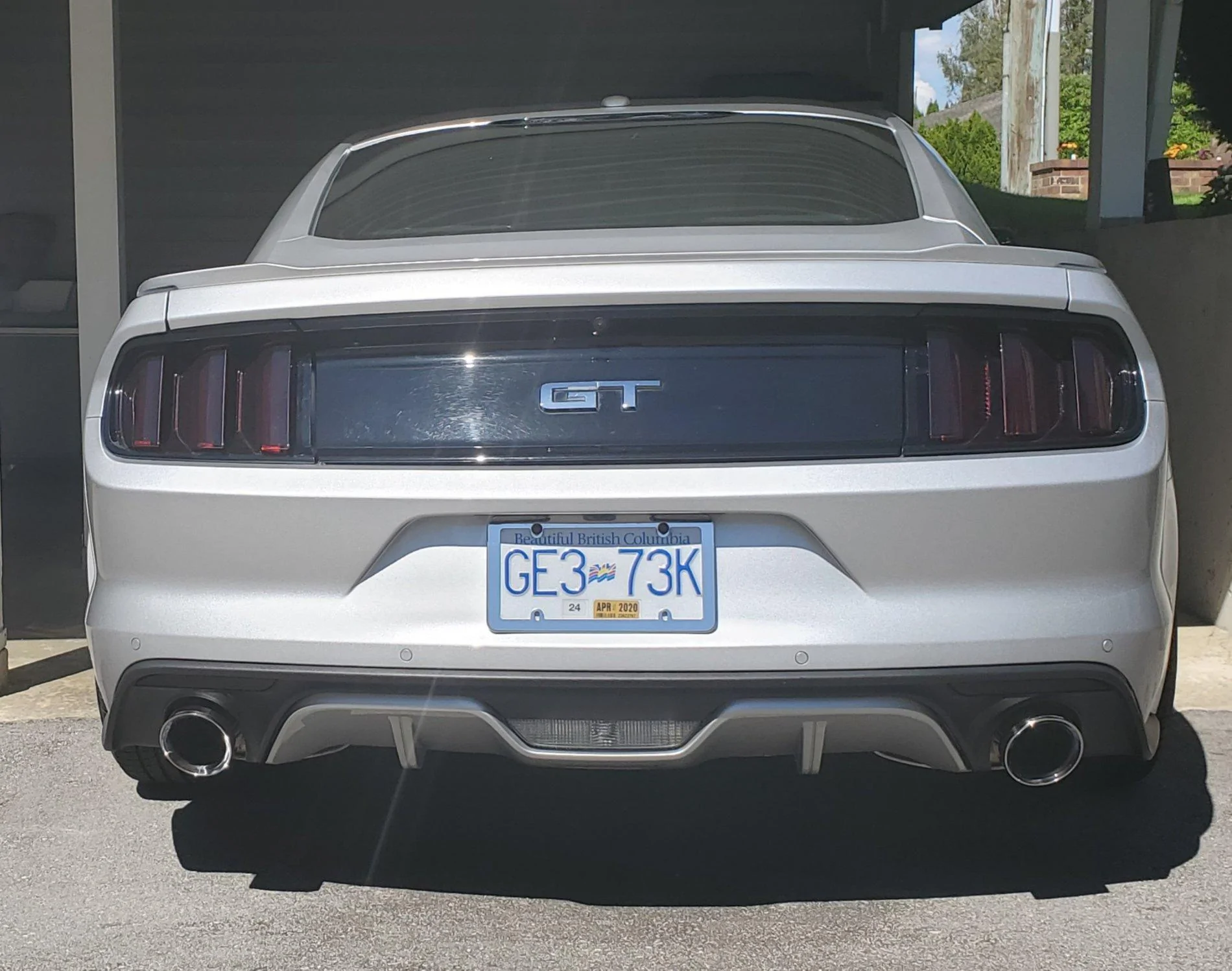

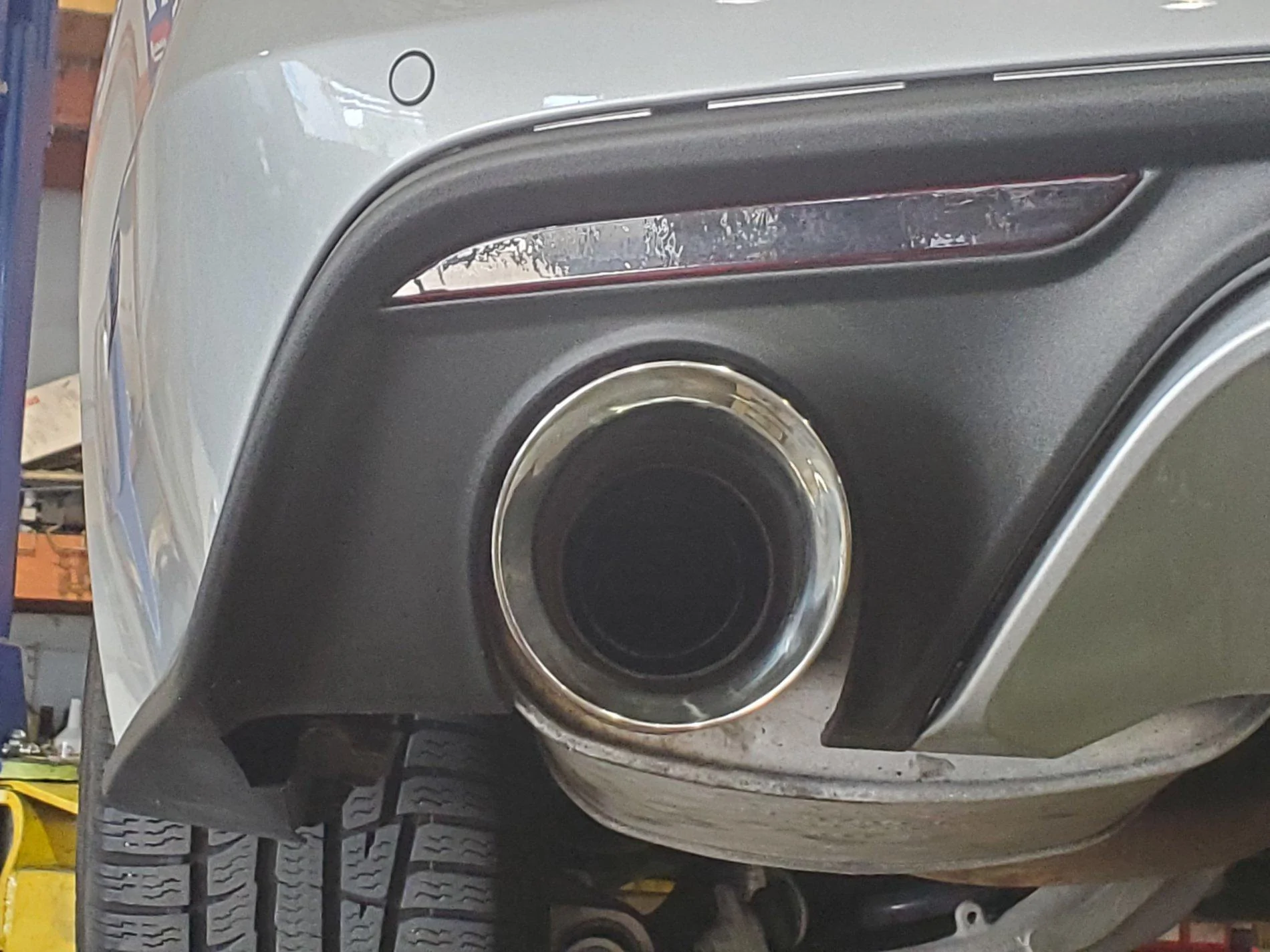

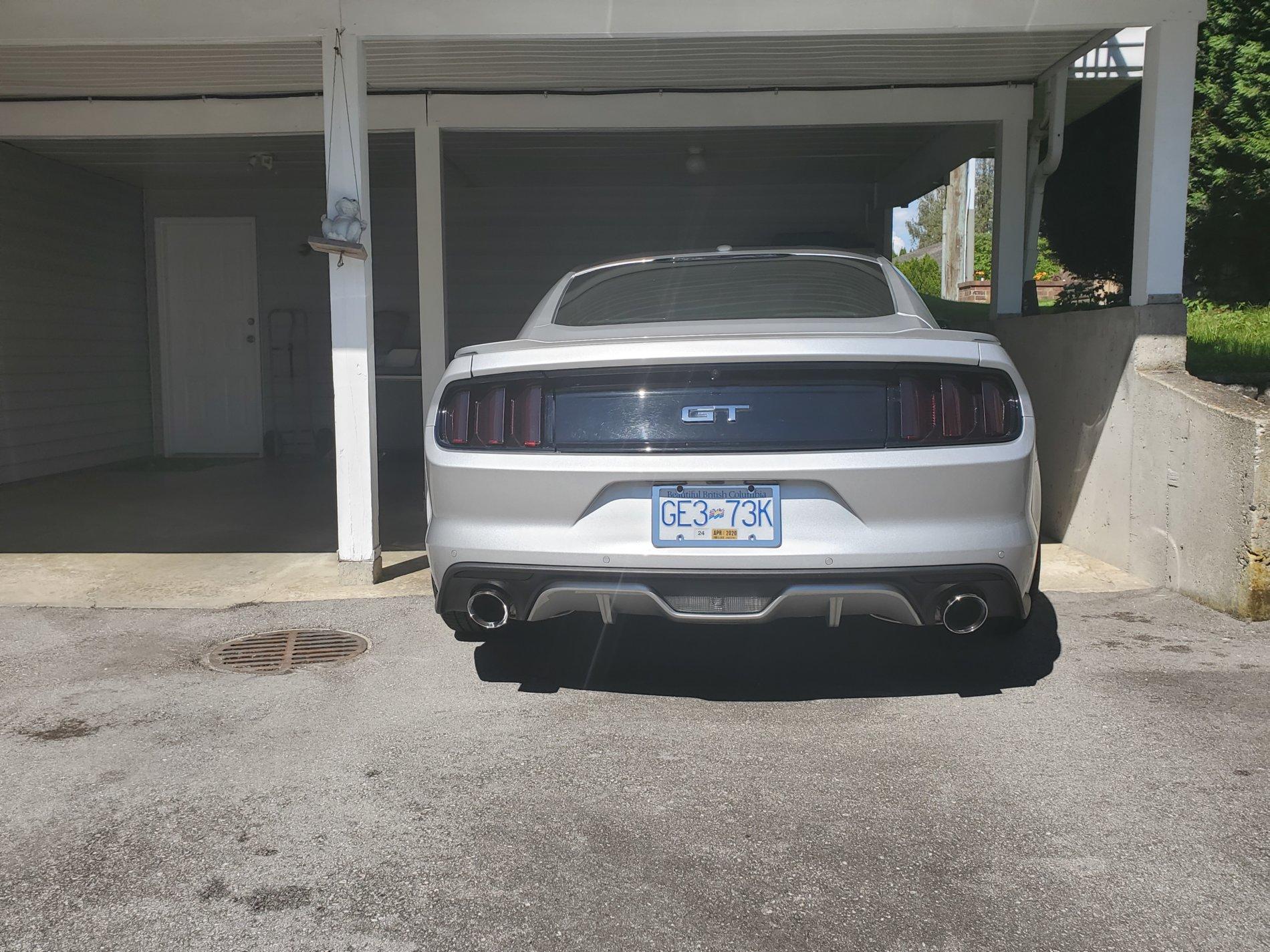

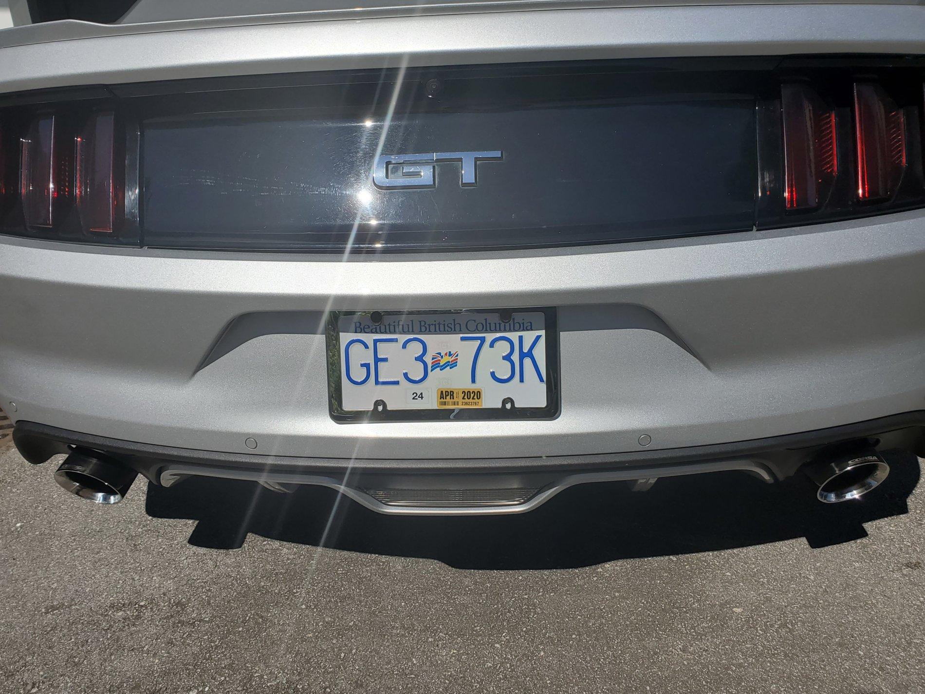

I searched and didn't come up with a good thread for this on my '17 GT Premium. So I thought I would do a post with mine. [GALLERY=][/GALLERY]Adding Corsa 4.5" tips outlet, 3" inlet, overall length approximately 9".

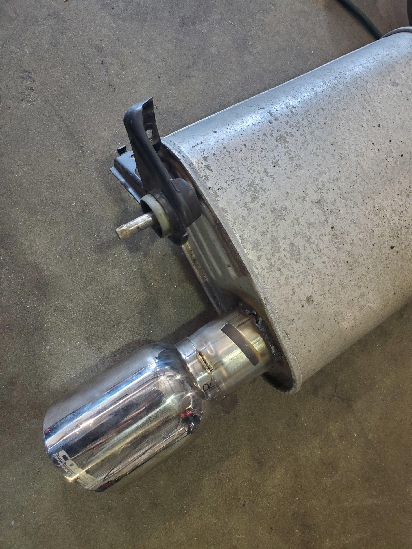

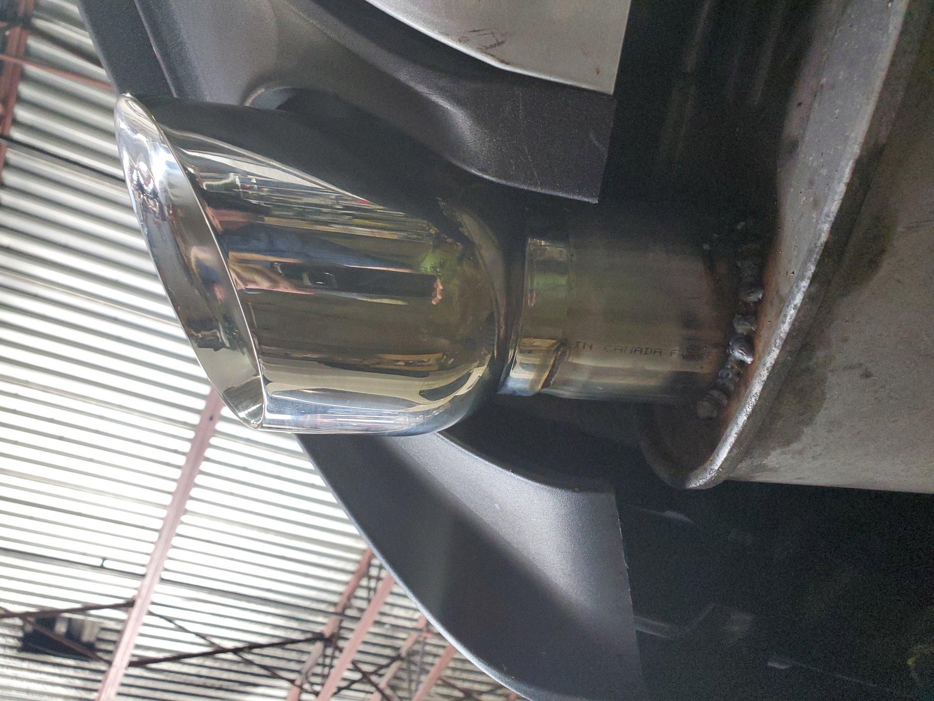

Cut off stock tips flush with mufflers.
Welded 3 inch inlet to stock mufflers. Cut off length of inlet for desired fitment. I have mine about 3/4" protrusion from Fascia. Was no problem getting the right angle of fitment. Not much difference in sound
(maybe a little) except when driving you can hear the noise more clearly because the tips are wider and protrude further out than stock. I am impressed so far with only an MRT H-pipe. I have headers in mind is why I kept stock and do not want overly loud. Pics do not do the look justice.
