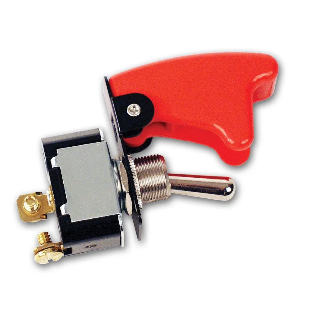

I imagine it would be difficult to separate the ignition from the starter under the dash or under the hood, but it should be easily possible to put in a spring-loaded to off switch that operates the starter (solid-state relay) without the ignition being enabled. All I SHOULD have to do is get battery current to the starter, separate from the start button. That way, I can operate the starter until I see normal oil pressure and, then, start it normally. The engine parts will then have oil film protection at startup. It stood me in good stead for many racing years to do that and my engines showed less than average wear when I disassembled them after a racing season. Last season was a few years back, but I like the idea of oil pressure in my GT before startup. Also, starters are WAY cheaper than engine rebuilds.
So … my car is not here yet. Can any of the 2019 GT owners tell me if there is a good place on the dash for an owner-added switch? I mean actually IN the dash. I can always drill a hole and add one, but it would be much better if it looked like a factory switch.
