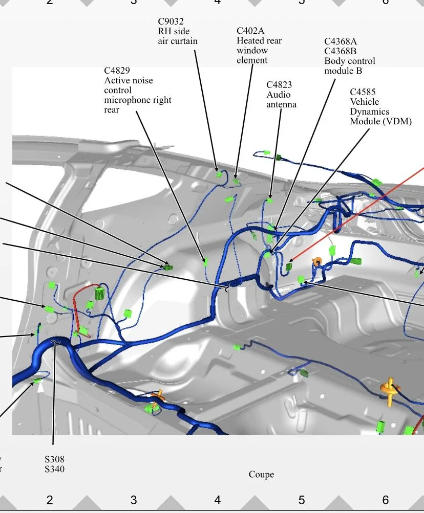

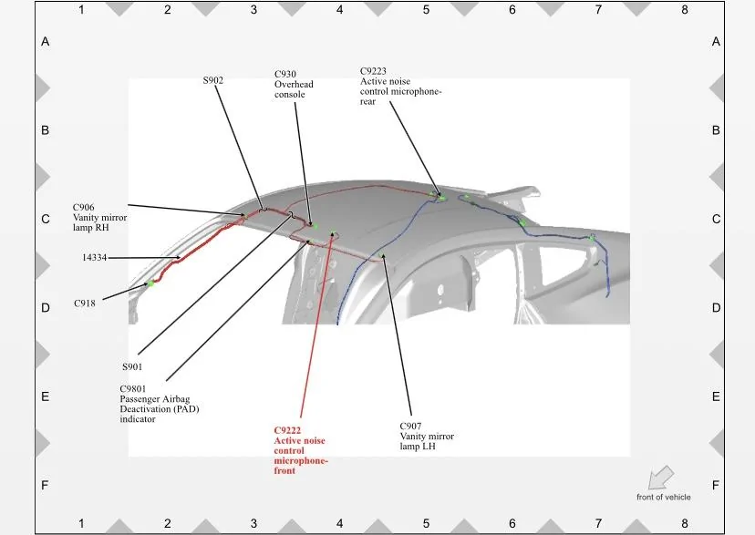

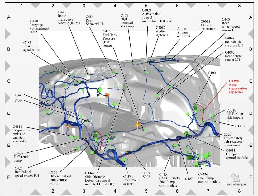

If the Active Noise module is disconnected at the top center rear headliner (as discussed in multiple threads on here), does that also kill the L and R Active Noise Mics? See images below. It does not look like the L & R mics are tied into the roof module, or is that incorrect? Unless they are and it’s just not clearly documented.
Also, what is the role of the “Noise Supression Capacitor”? Again see below image.
