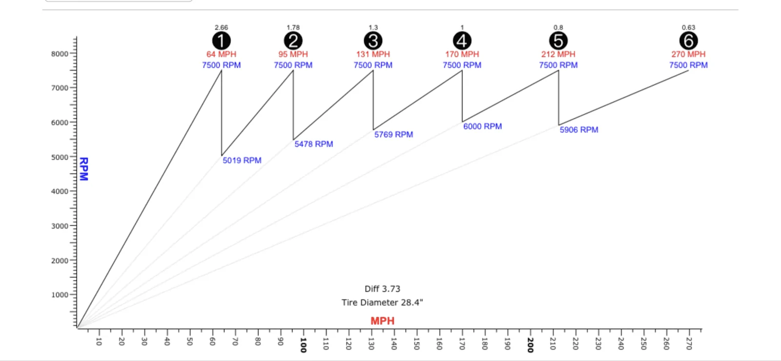

6th is pretty useless except for highway fuel economy. A re-gear to 3.31 would help run out 5th, but will neuter your around-town game. I don't know what aftermarket gearsets are offered for the MT-82, but for a boosted application the Magnum XL is a good choice since 1st - 3rd are a little taller and more useable, 4th is your 1:1 and 5th is either a 0.80 or 0.74 vs the MT82's 6th of 0.65. Then you have a double OD 6th either 0.63 or 0.50 depending on what gearset you choose. I borrowed this graph from the thread linked below, this is with a 3.73 rear. He's also using a custom 2.66 gearset with the OD gears from the 2.97 gearset.
https://www.mustang6g.com/forums/threads/installed-a-tremec-magnum-xl-in-my-s550.115797/
