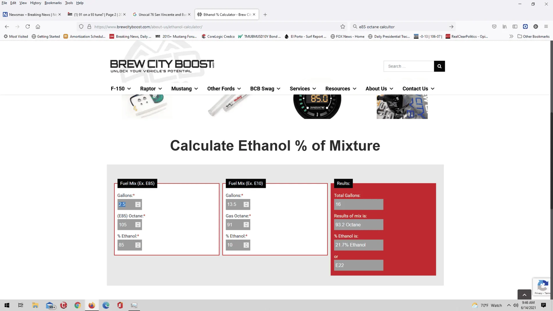

The issue with E85 on the 2015-2017 is you really can't go above E15 with issues. I know your car is modded so it may have the injector bandwith to run more E85 even without an E85 tune. My 2020 I can run up to 4 gallons before I start to see some issues mainly with cold start.
Also as Biggus mentioned. Cali has the best E85 in the country. If its not pure E85 it will be taxed like regular gasoline. Our E85 is closer to 105 octane than 100. Here is a chart that will get you to E21 but right at 93 octane.
I would bring a 5 gallon fuel jug with you to load up on VP101 after your fill up. Most Western states don't have 93 octane anymore. They have pretty much gone with the Cali model.
I am not a fan of octane boosters, or race fuel concentrate. They make a mess of the combustion chambers. Short term is fine but wouldn't use it all the time.
