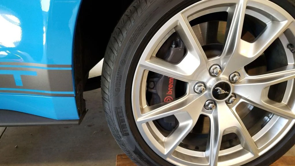

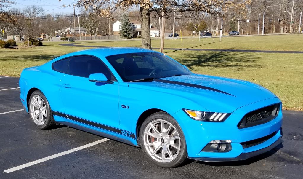

Didn't find anything on here in a couple quick searches, figured I'd post pictures as proof...

So no 19's interfere with the caliper width? I thought this was an issue with many wheels.

A 19" wheel drum should clear, in most cases, but there is no guarantee that the spokes will clear the outside face of the caliper, so YMMV. Fit isn't just diameter.

Sorry to resurrect an old thread but are these the 50th anniversary 'appearance package' wheels (19x8.5 all around) or are these the larger 50th anniversary package wheels (19x9, 19x9.5)?
I'm considering purchasing a set of the 19x8.5 sized wheels on 255/40/19 for my GT PP but am trying to confirm if they'd fit prior to making the drive out to purchase them.

19x8.5's. Fit like a glove.
