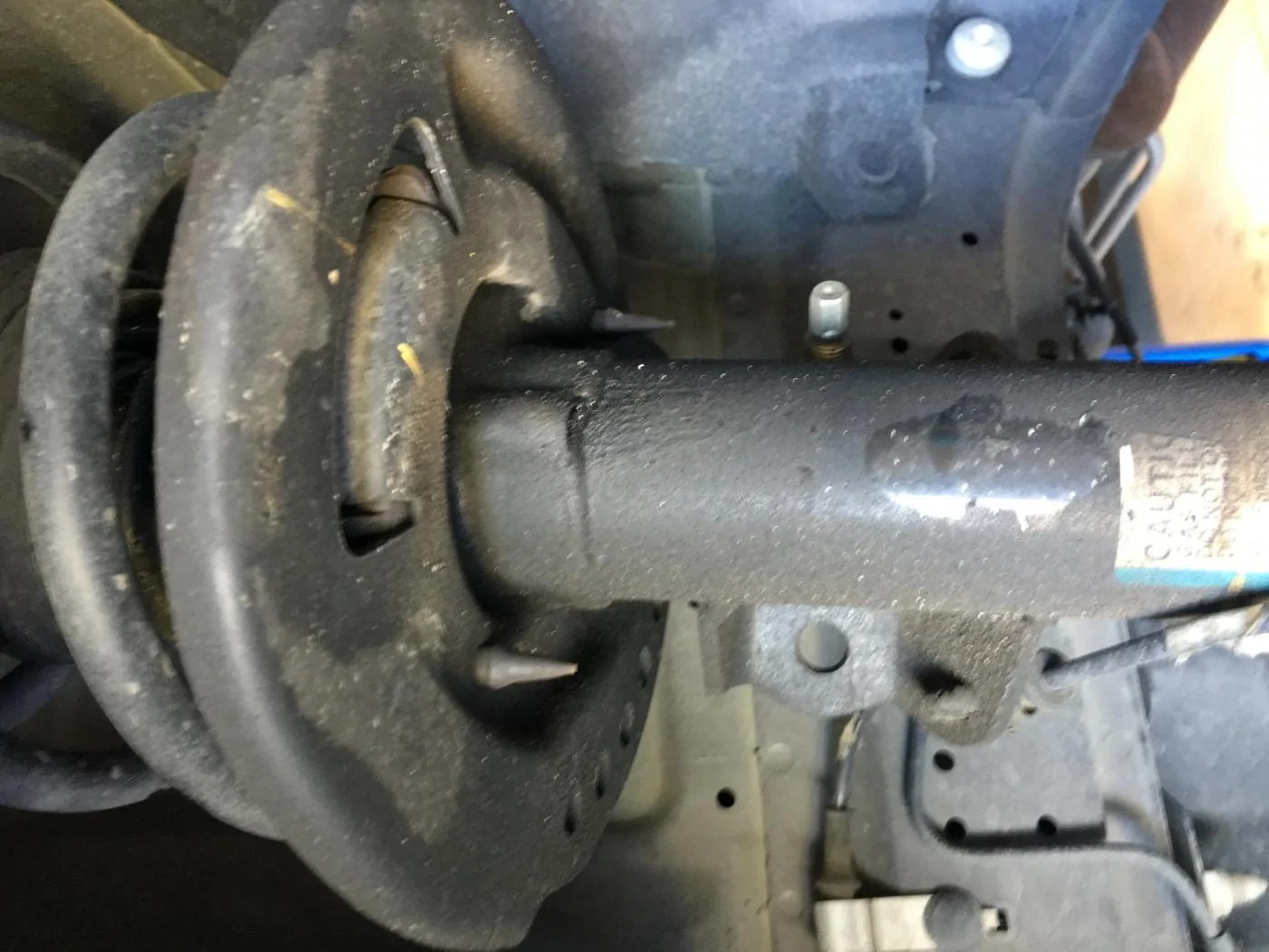

Decided to turn this car into a road course car.
After one track day just to get certified at my local track the car blew all 4 struts. The initial plan was to get some swift R springs, but now I am going straight to coilovers.
Note this car only had 7,000 miles on it.. Smh

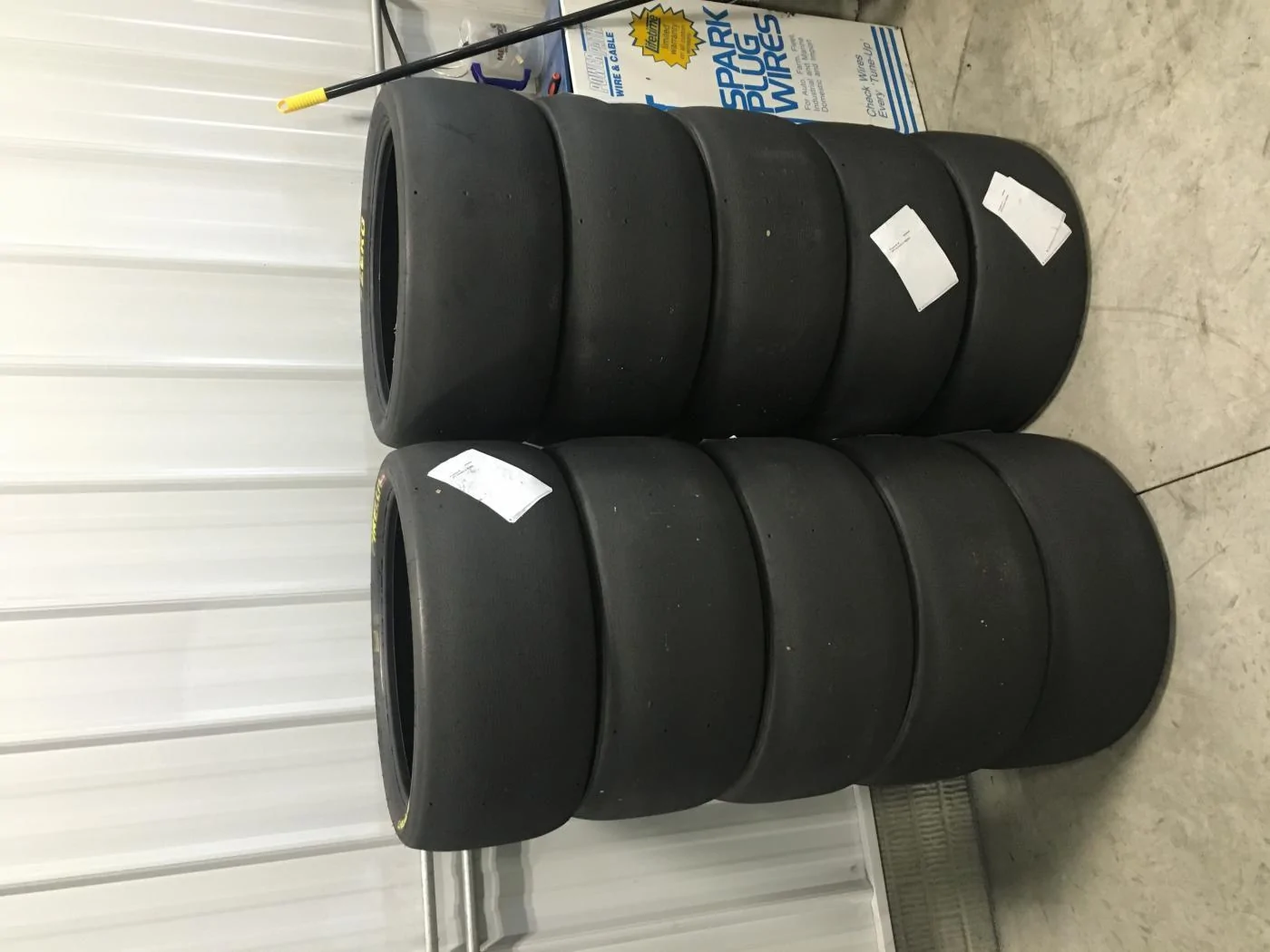

Picked up 10 19" pzero slicks off a Ferrari challenge car to use on my factory wheels, one one heat cycle. 255/650/19
BUT I am changing plans and going with a enkei nt03 wheels 18x9.5.

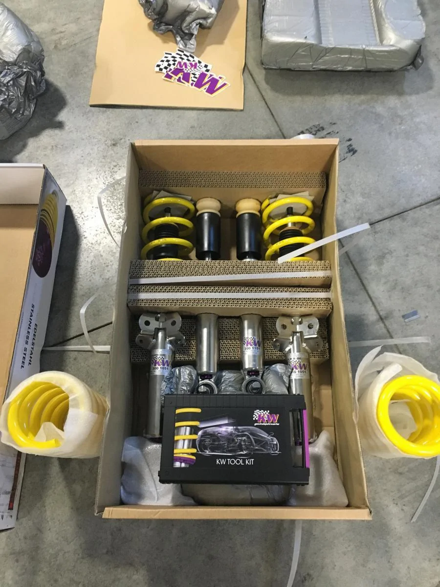

My KW v3s showed up today! Cant wait to complement them with a set of J&M Caster/Camber Plates!

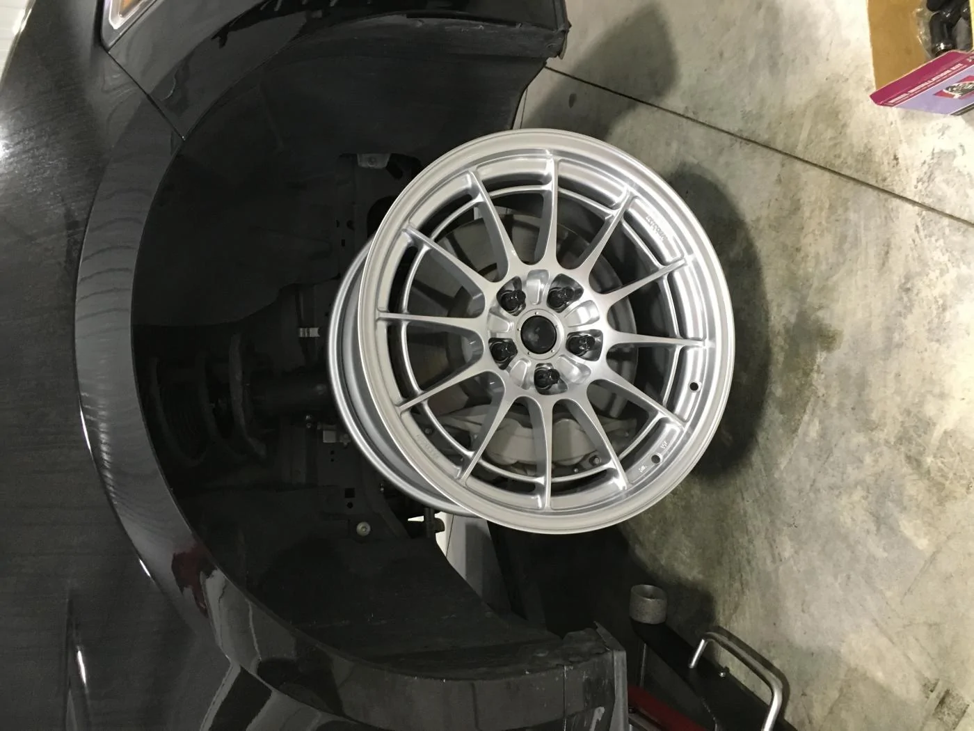

Otherwise my wheels came in today!
Going with a square setup. Enkei 18x9.5 nto3+m. Super lightweight.

I am running the same coilovers. You will love it.
I hope so! Went back and forth with the club sports. But I think these will work just fine.
