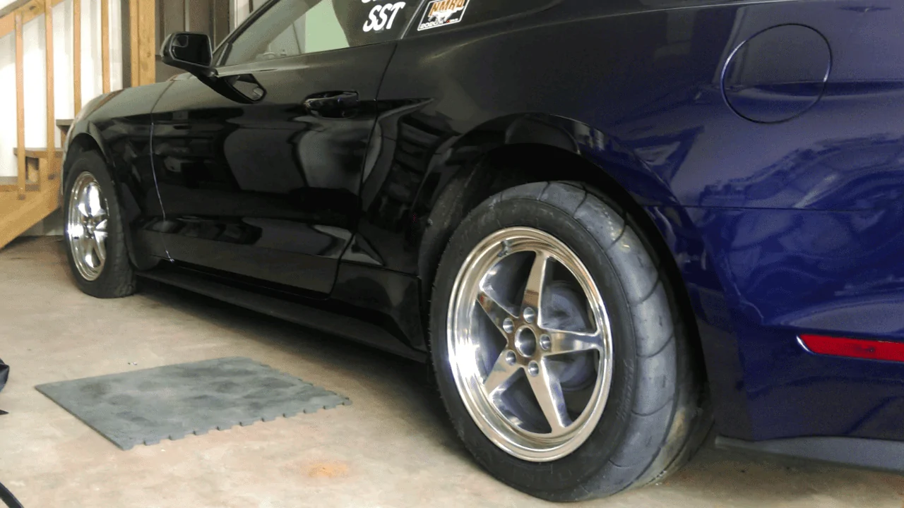

Forgestar D5 wrapped in MT Street SS 305/45/17

I run 26" with 3.15 gears... Only complaint... I don't like the way they look, more wheel well than tire!

If roll racing at those speeds and not worrying about launch, 26" would give you a bit higher gear ratio and less weight than a 28" which are both pluses and shouldn't be an issue with traction (even from a dig at the right pressure) as long as you stay N/A with basic Bolton/time setup.
Like Don said, it will worsen the fender gap but that is only cosmetic. I have some 17x9 bullets with a 26" bias ply tires from a prior car and they do make the gap worse. Haven't run them at the track yet.
