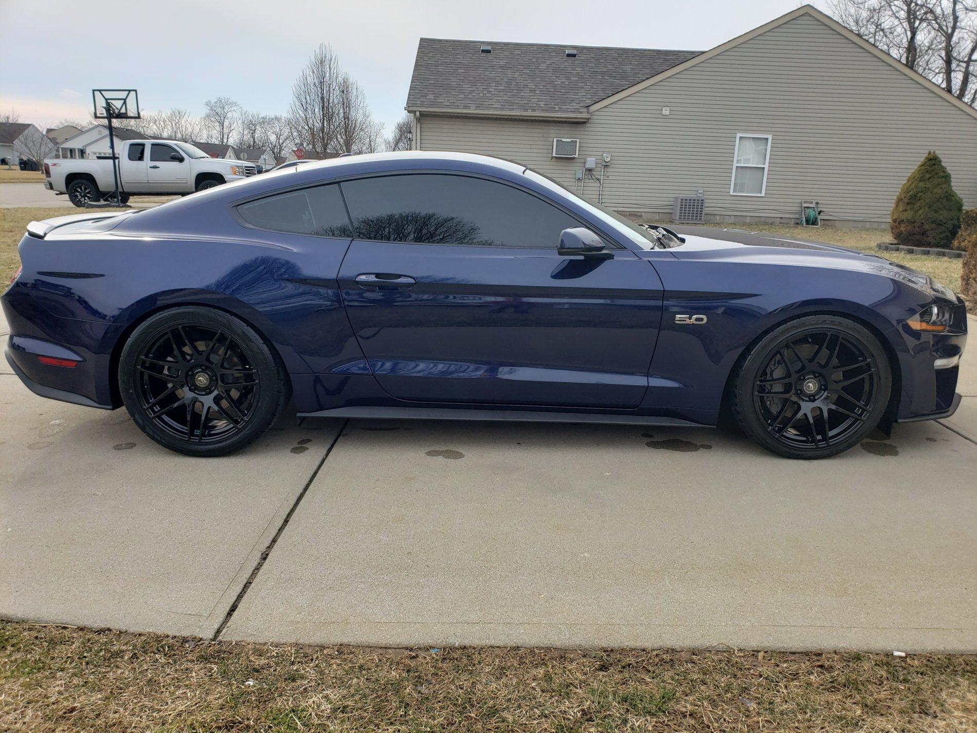

SpectorV
New Member
Feb 24, 2019
Birmingham, AL
Brandon
2017 Mustang GT
with a 20x11 a backspacing of 7.25 would be about right, that would mean the offset is 1.75 inches or 45mm~ this is based on a 20mm spacer on a 9.5 17GT PP wheel being fender flush as 25 pokes a bit.
The front spacing (width - backspacing) needs to be 3.75 inches on the rear... if you have a lowered car this may need to be MORE as the wheel tucks inward as the suspension travels up (or so I believe) I have no idea how much though.
