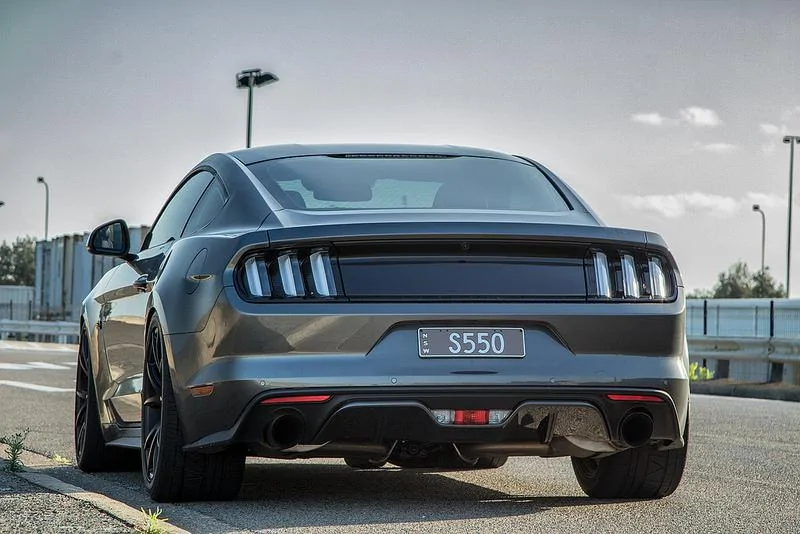

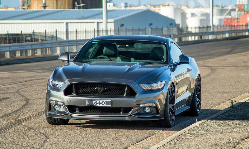

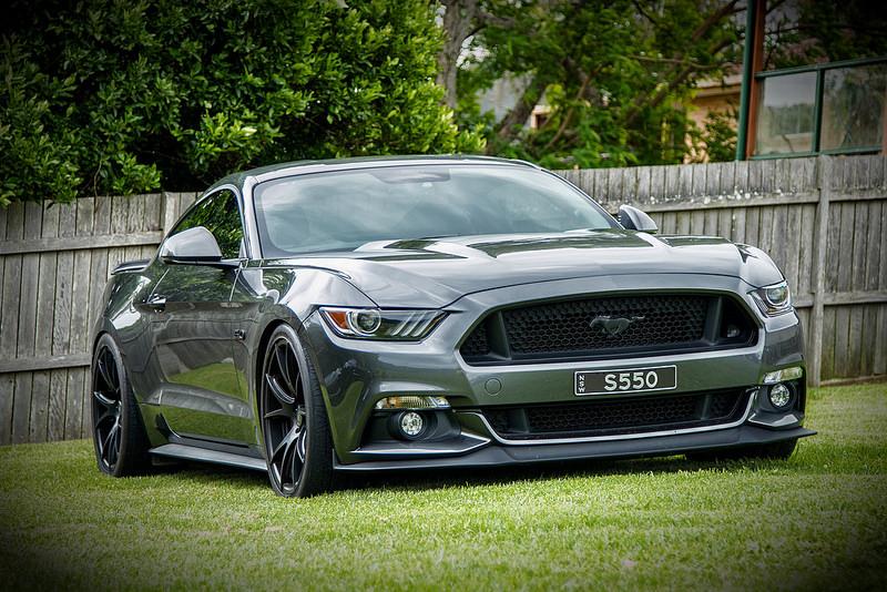

This was my old car. Forgestar CF5V Deep Concave 20x9.5 +30 20x11 +55, 275/35 and 315/35 Nitto Invos on BC Coilovers, quite low. Camber was -2.2 front, -1.6 rear
Looked awesome, needed better tyres and a shorter rear

Nah, only at the front. Honestly though, I wouldn't go that combination again. My next set of tyres was going to be 265/35 and 305/30 MPSS. 315/35r20 is just too tall, and the invos handled horribly.

Any reason you picked +55 over +50, im torn between 50 and 55 as the options seems to increase when you go +50
Also that setup looks mint

At the time I wanted to fit a big fat 315 back there without too much camber. With a +50 I would’ve needed another half a degree of negative.
+50 with 305/30 would be my choice now

Yup, +55 is the way to go for less camber then. I originally wanted 305/35, but for the life of me I couldn't find anything in AUS, except for P zeros and they were ~$700 each.
I was perfectly happy with the amount of camber I had with that setup, it's just the COG was way too high at the back, and the invos are shit. If you get the 305/30 in michelin or continental they run pretty wide anyway, 311mm section width on an 11" from memory.
