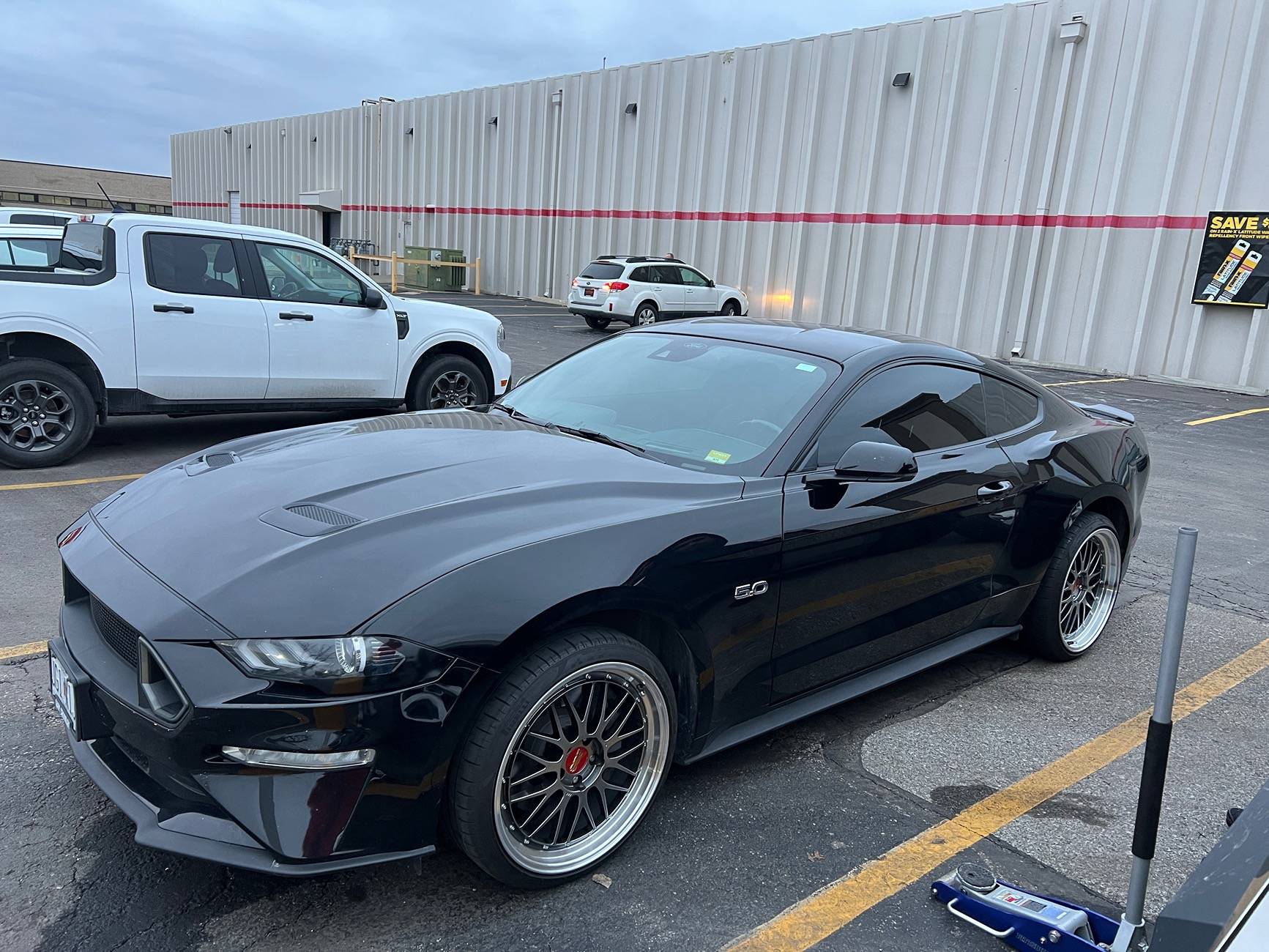

Hey all,
I have seen the specs called out in the title on a XXR wheel specific thread but not too clearly as there were differing offsets being discussed. I purchased a set of staggered BBS LM’s in:
20x9 +28
20x10.5 +35
From what I have read about fitments, the front spec shouldn’t be an issue. Where I have seen some alternating opinions on is the rear fitment. If I were to lower the car an inch would this be an issue? I am also curious what kind of tire would work here. The included 275/30 looks very small for the car and am wondering if a 285/35 or even 295/35 would work. From what I have gathered I would be very close to rubbing the fender, but wanted to see if anyone else had experience with this wheel spec!
Thanks.

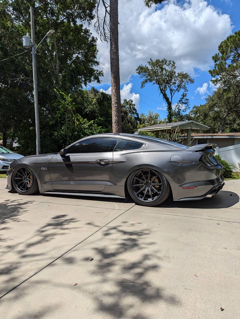

So I have the same set up in the rear but I’m 19 inch. I have a 285/35/19 tire and roughly at 1.6 degree camber.

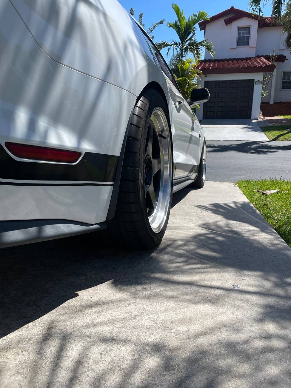

Man after my own heart. My favourite wheel, I would do anything within your power to make them fit. I run a +45 with a 305/30 MPS4s and i have a little poke but i am stock magneride height, if I lowered it they would tuck in. I suspect with that set up you could get away with a 285 or even 295/30 depending on the type of tire you use.
