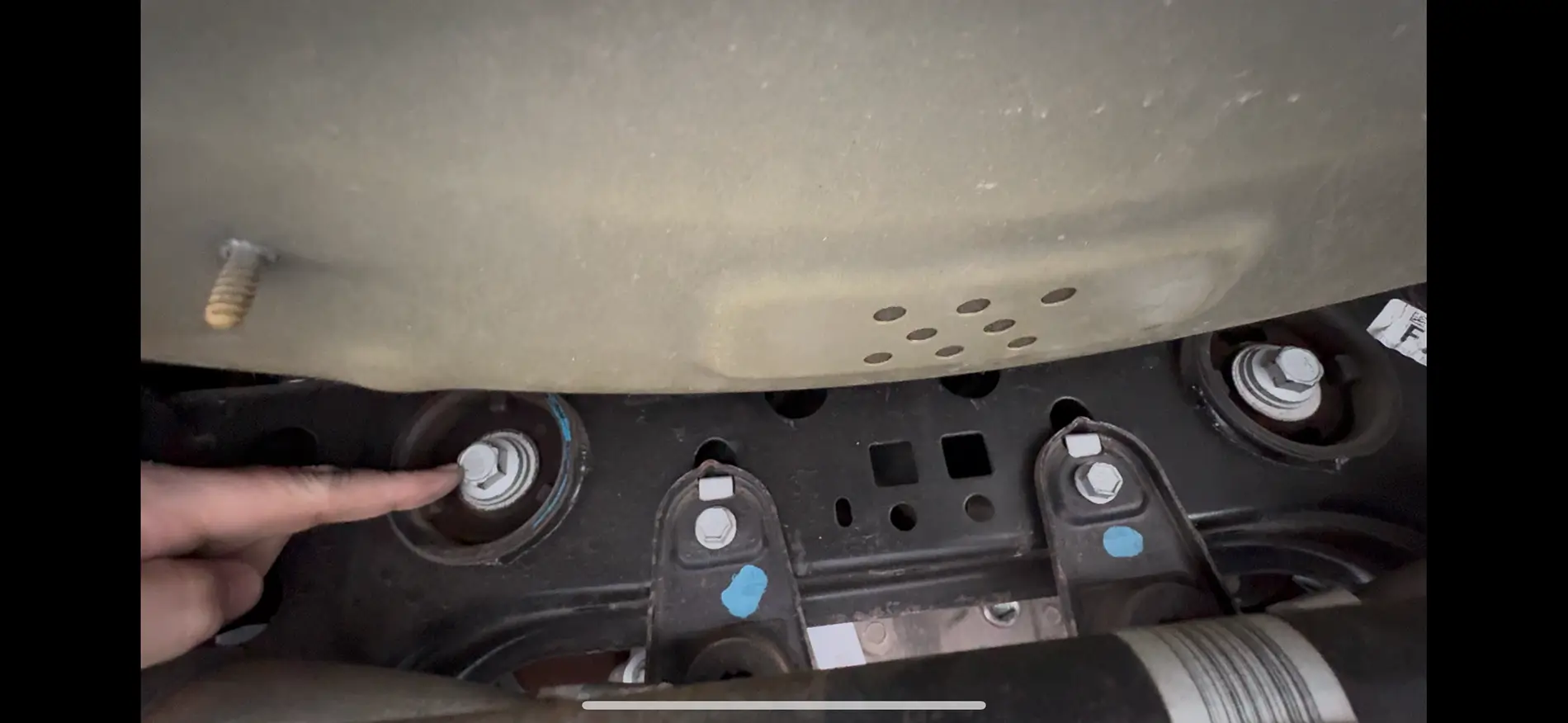

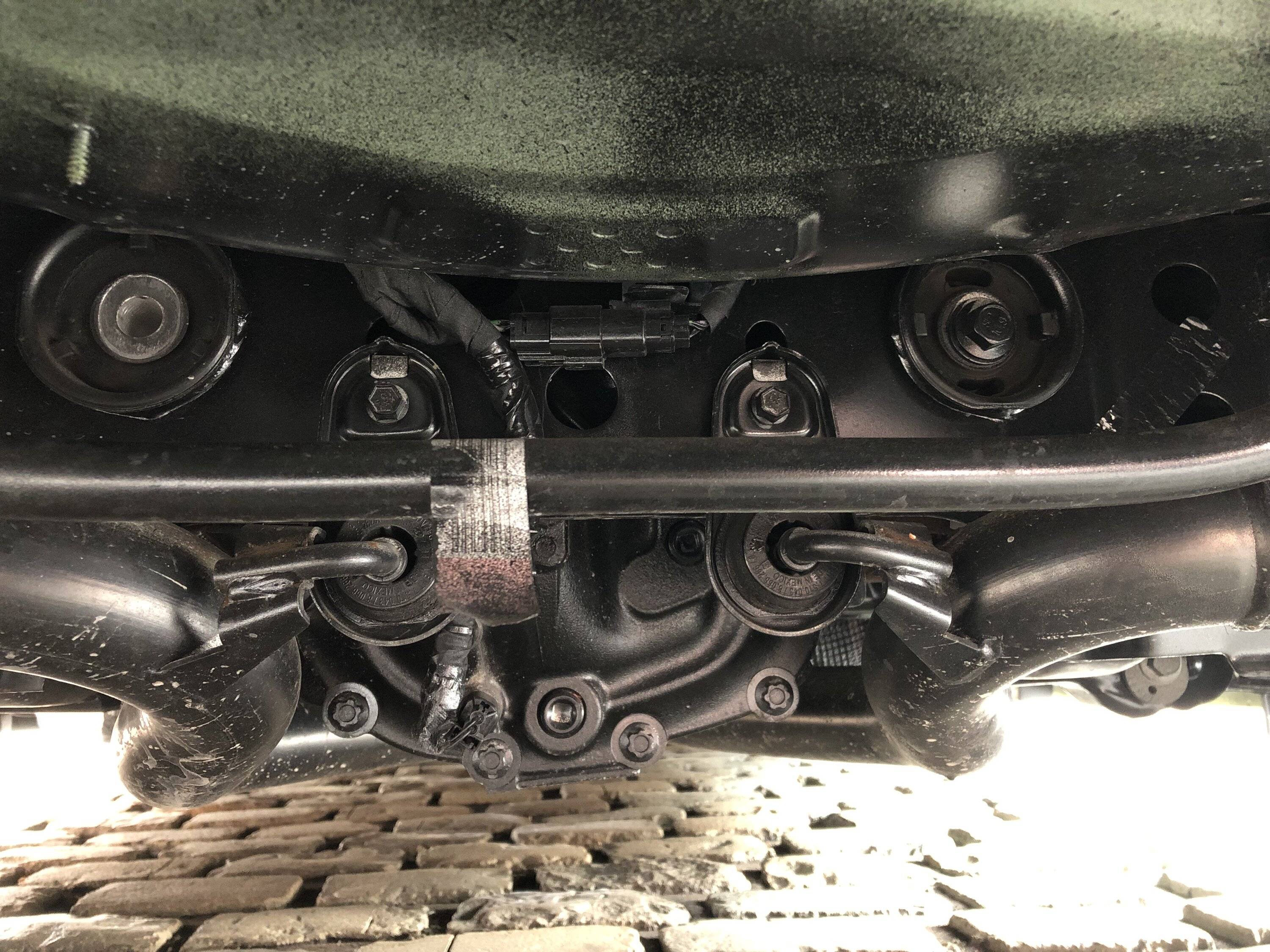

When driving next to other vehicles or walls, I could hear a slight rattle. Hitting bumps, the same. Tonight I got the car up on jack stands and started tapping with a rubber mallet all under the car. As I got toward the back, I could hear it lightly. Finally, I narrowed it to the washer on the rear differential carrier bolt.
The bolt is extremely tight, but is not holding the washer tight. The passenger side bolt I'm able to loosen and torque back down. But not the driver side. I'm afraid of breaking the bolt off. I really think the assembly plant cross threaded the carrier hole.
I am planning to call the dealer, I'm still under the 5year power train warranty. But thought I'd post here.
Anyone seen this before?
here is a video too:

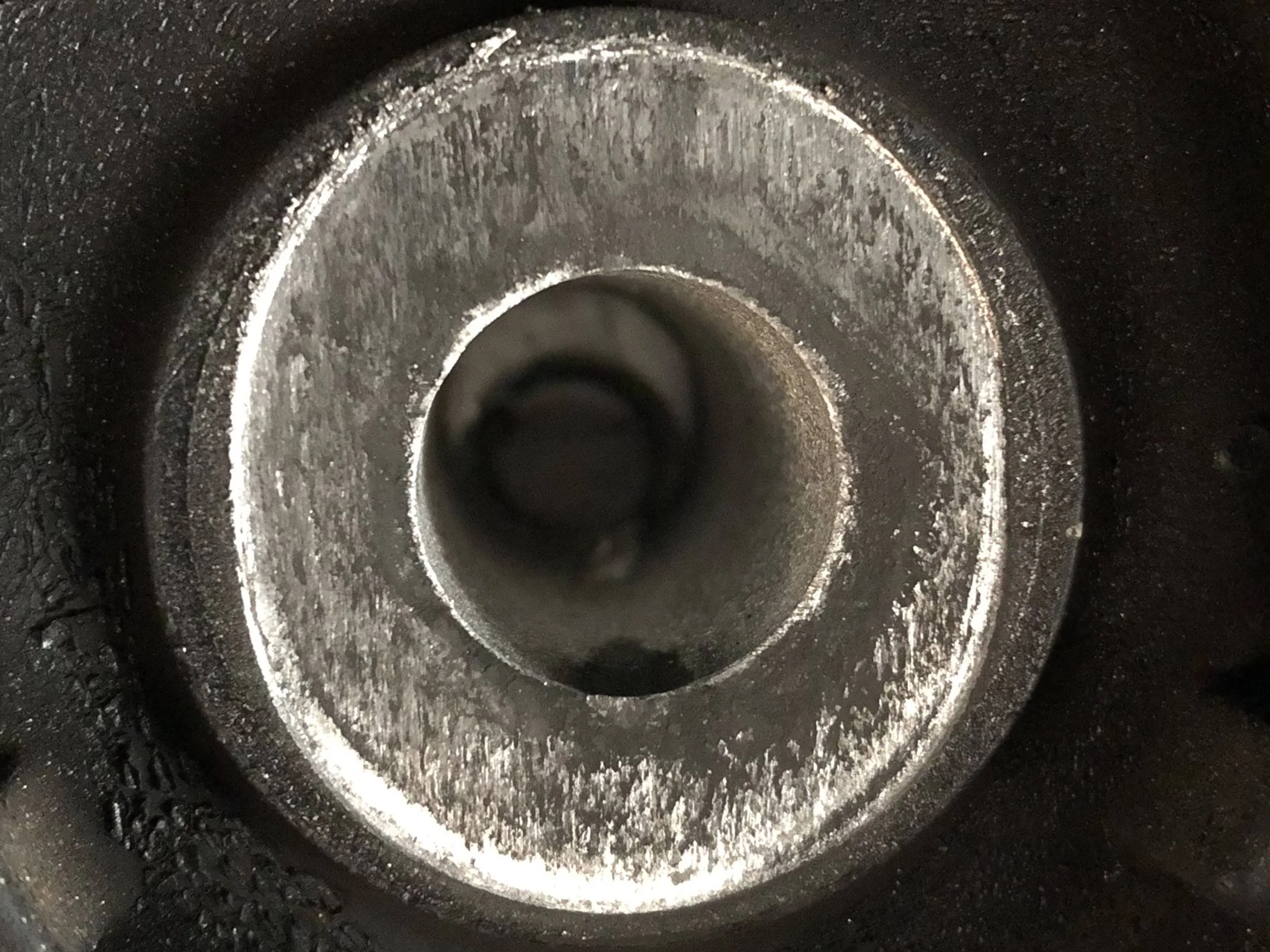

The witness in the euro underseal is the first thing that drew my attention (left mount / missing bolt head) :
A closer look, note the vertical wear pattern from the bolt head :
On the picture above, also note the wear on the bush from the bolt shank (bottom edge, closest to the camera).
Here are some more photos of the bush wear from the shank of the bolt :

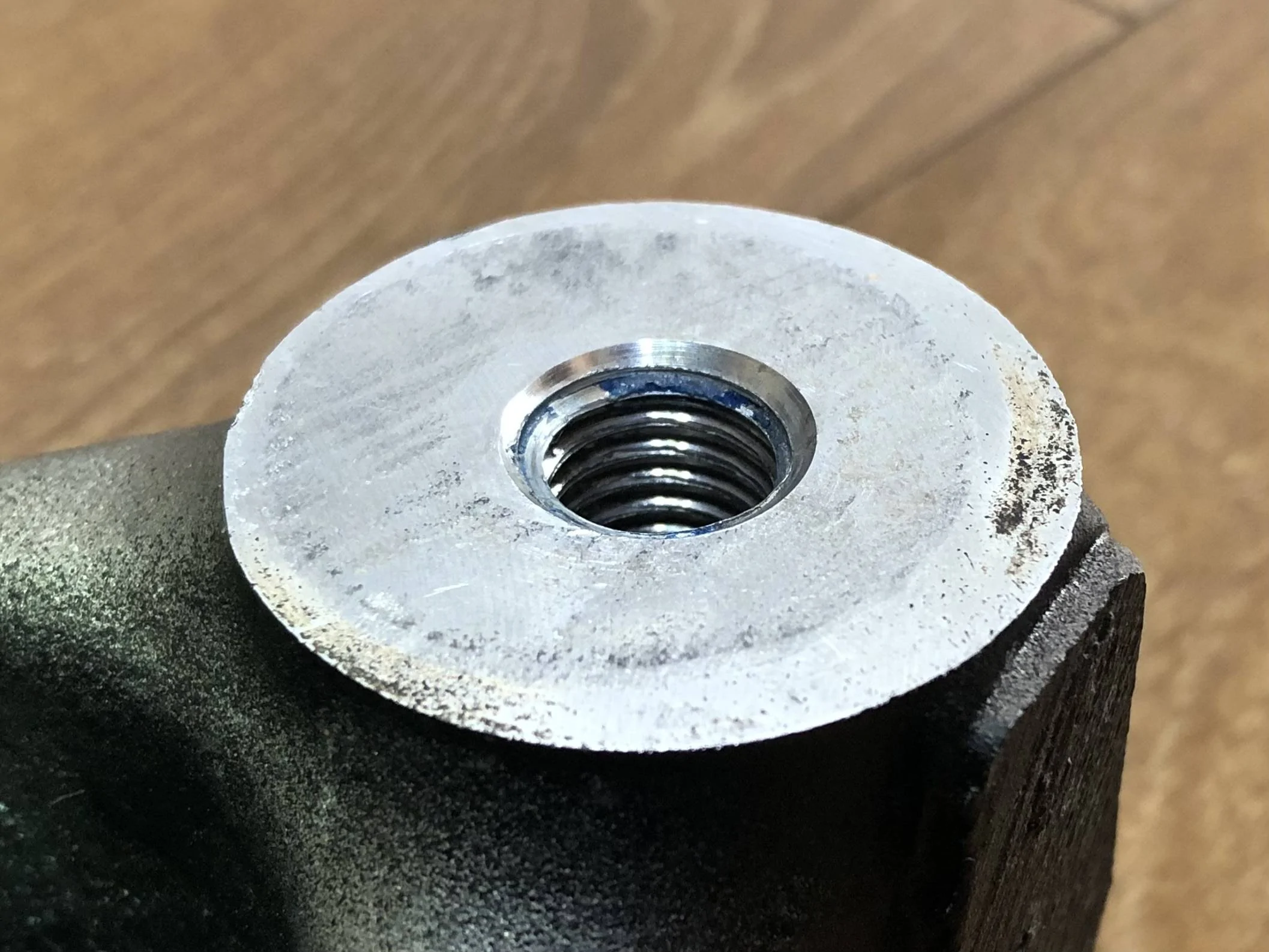

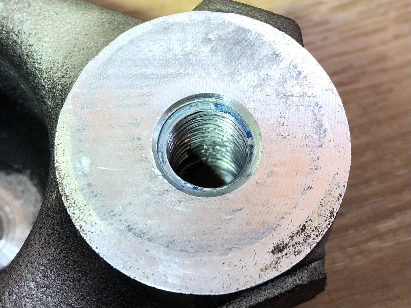

Now the Ford tech said that the remaining right hand bolt was really tight to remove, and he feared breaking that during the strip down.

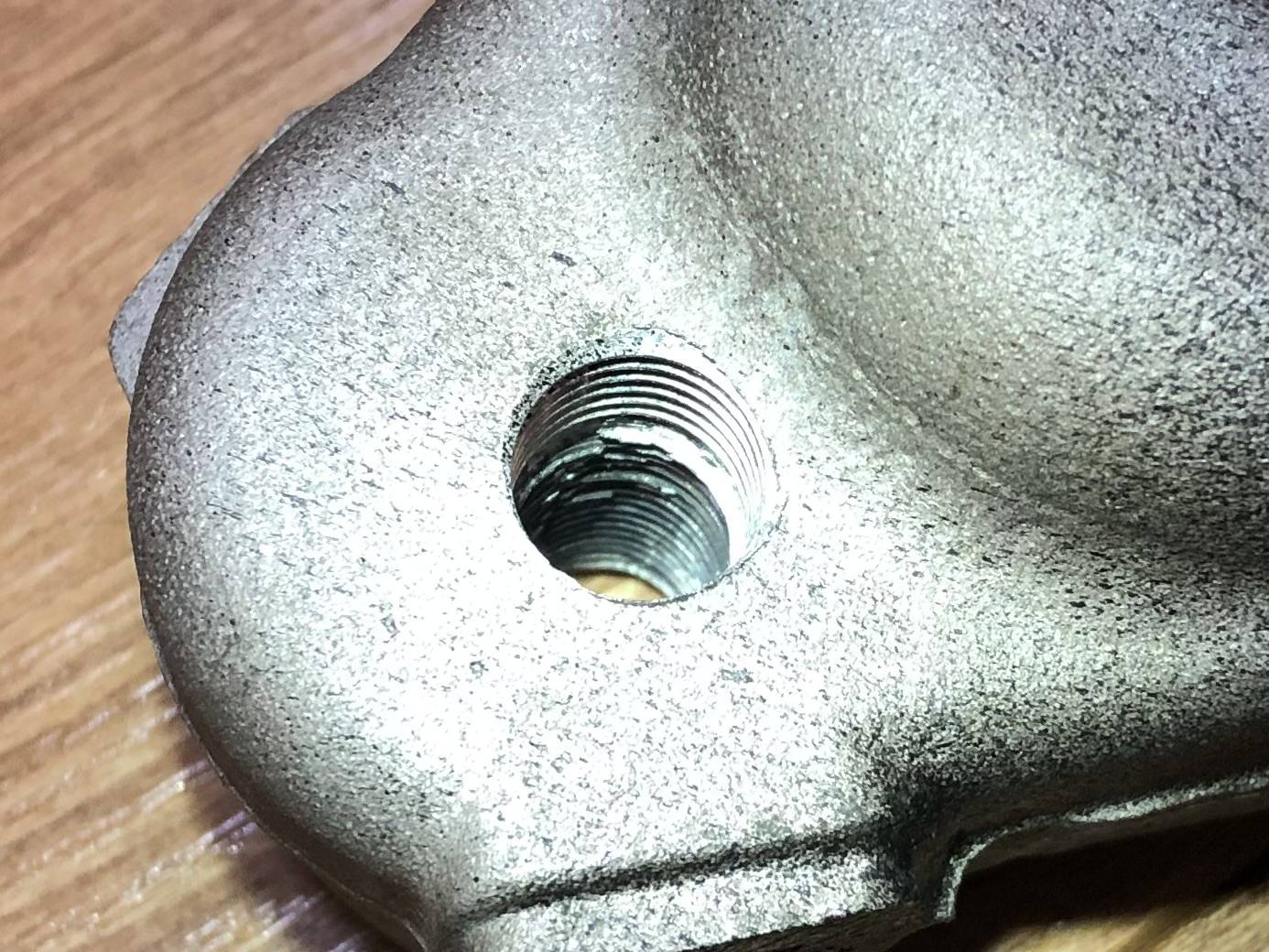

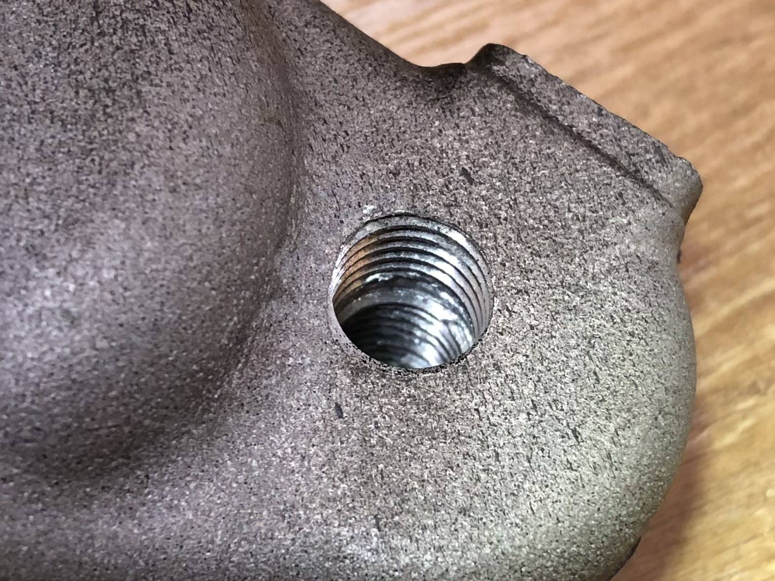

This is the right hand thread in the diff cover, remembering that this thread has only had a bolt inserted and removed once, it clearly has a damaged / cross threaded thread form :

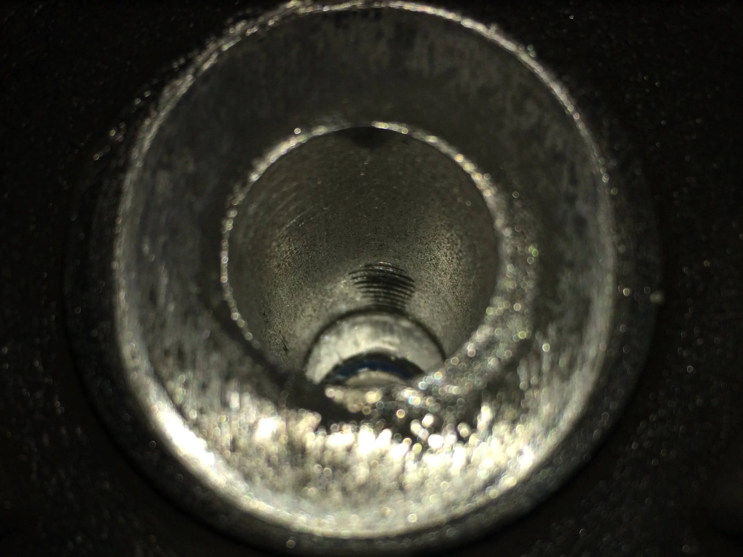

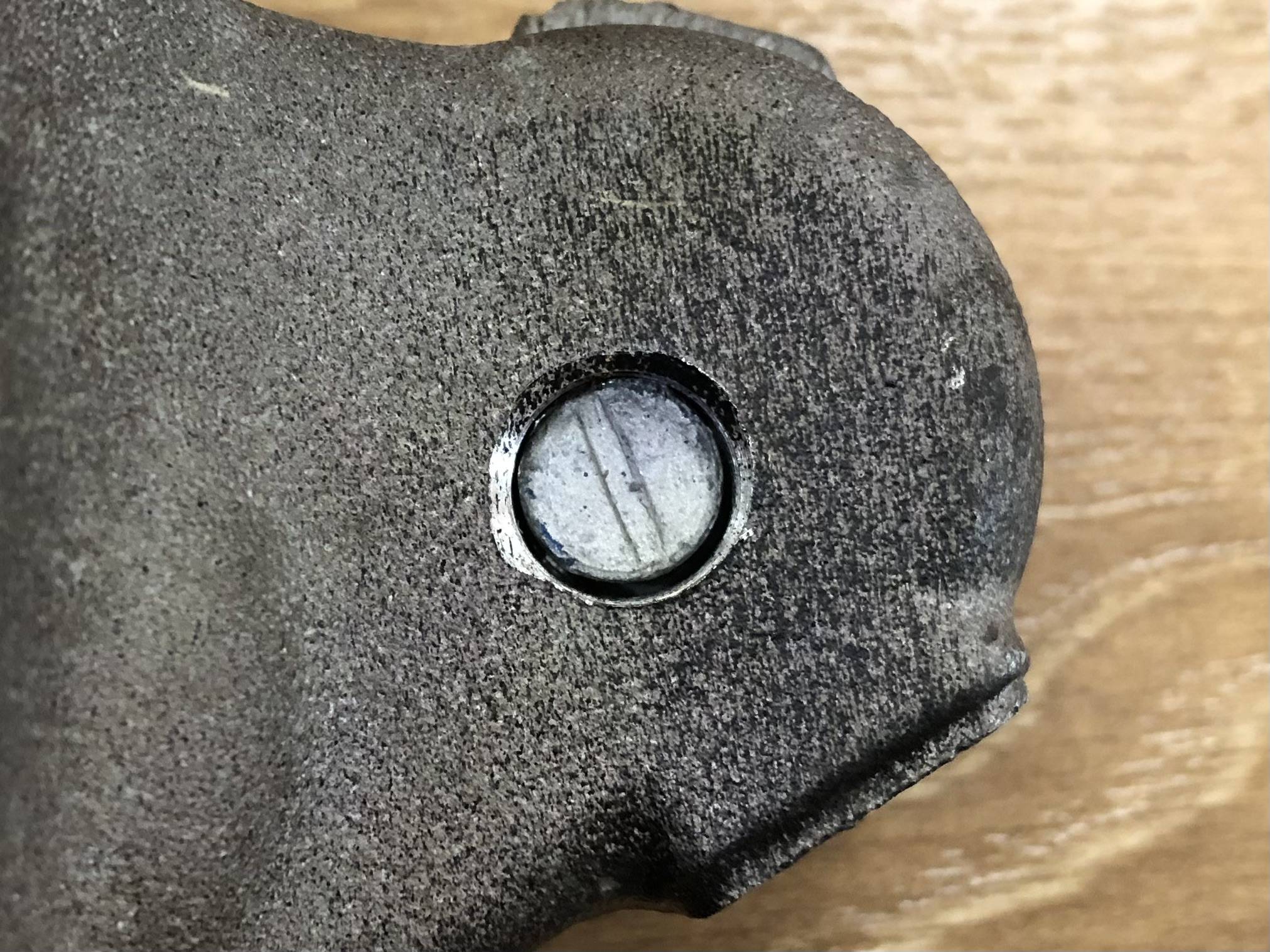

Which is really difficult to photo, but very apparent from the other side of the mount :
What I can’t capture on photo, is that the first 2/3rds of the thread, appear to run at a slightly different angle to the last 1/3rd.

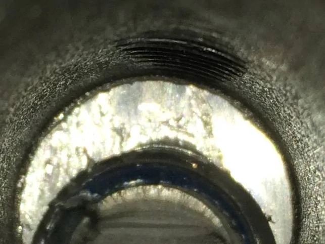

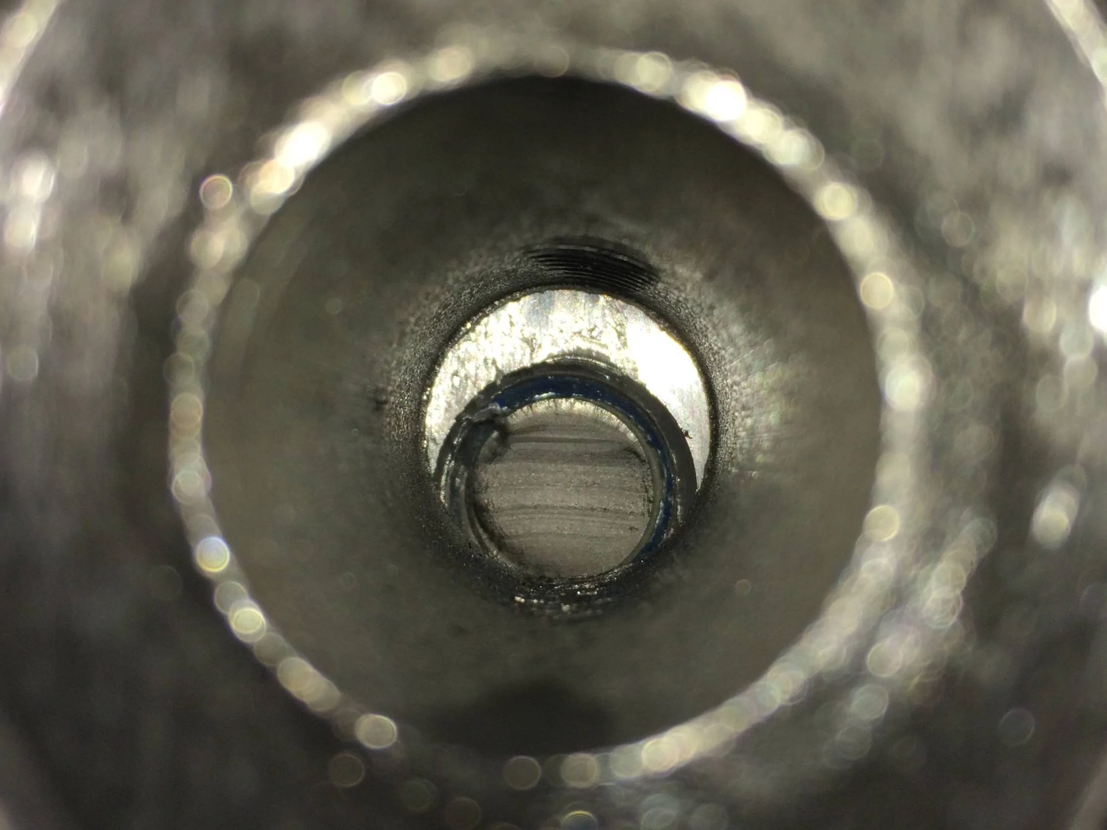

Again not easy to capture on a photo, but the broken bolt looks offset in the bore, almost like it’s really being driven skewed into one side of the thread :

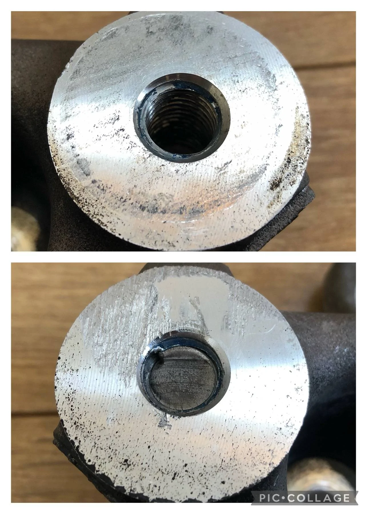

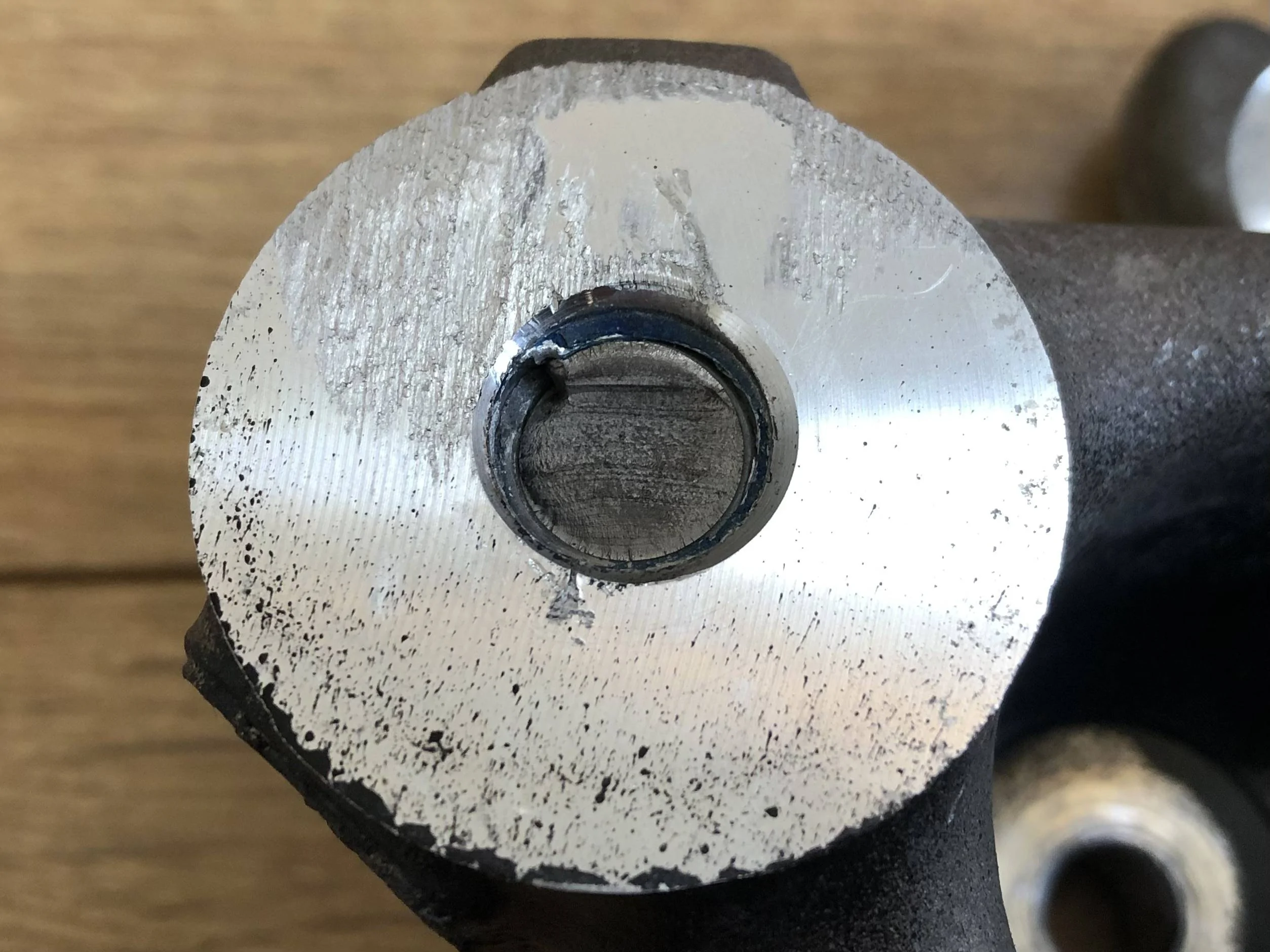

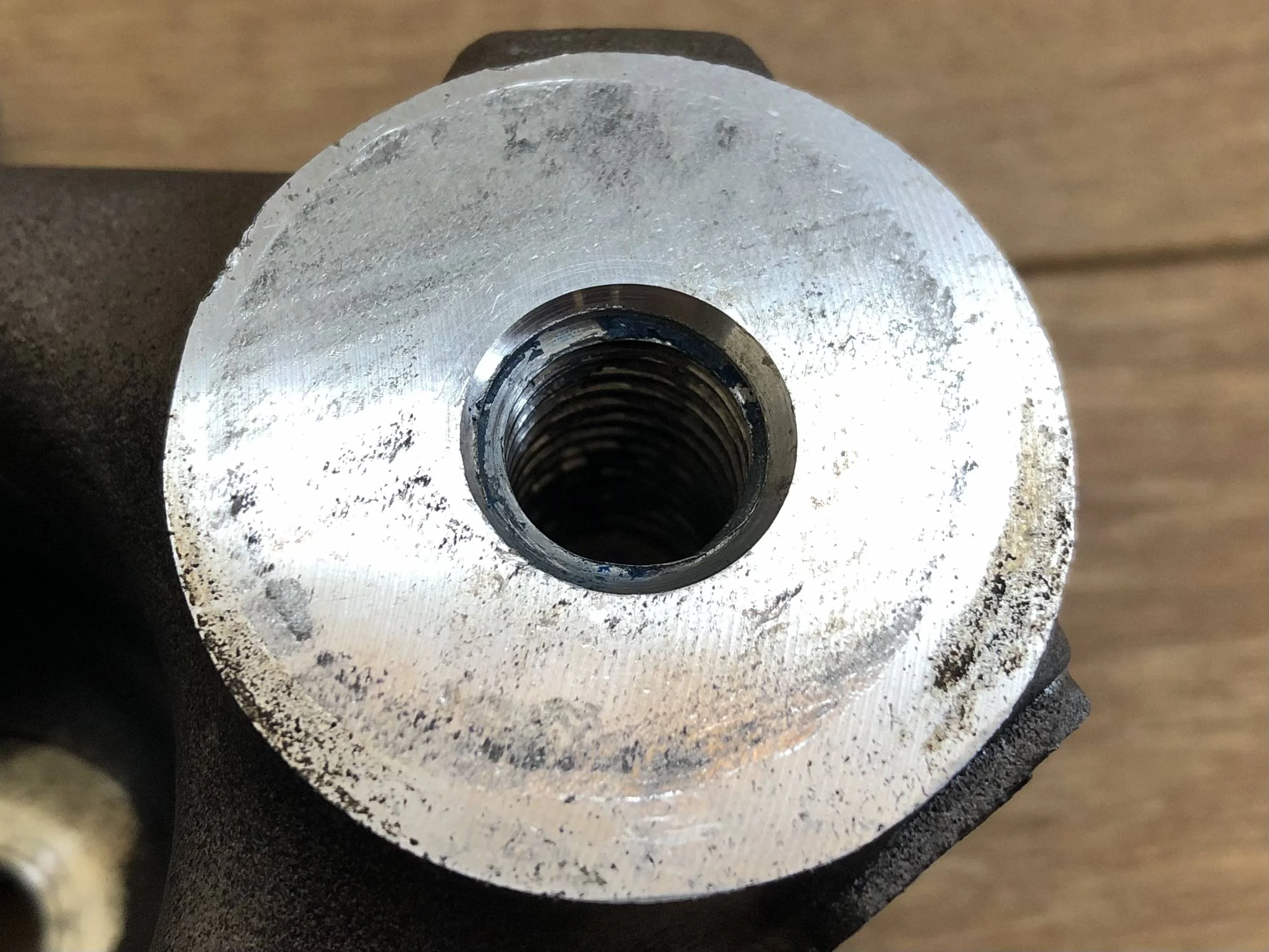

To me, these next two are the most telling photos …
Here is the mounting face on the ‘good’ side (even though we know this side still had a suspect thread), note the witness mark where it’s been clamped tight against the subframe bush :
Now compare that to the failed side, that has zero witness to being clamped, AND even has euro underseal overspray on the mating face, even though the underseal is applied after assembly :
It’s very obvious on this comparison :
So my unprofessional armchair conclusion :
  • Neither right or left threads were good from the factory.
  • The right thread allowed for some clamping force to the mating faces.
  • The left thread provided no clamping force to the mating faces.
  • No clamping force = all the stress through the shank of the bolt = bolt failure due to fatigue.
I’m open to, and interested in other opinions / theories, so please feel free to chime in with any alternatives :like:

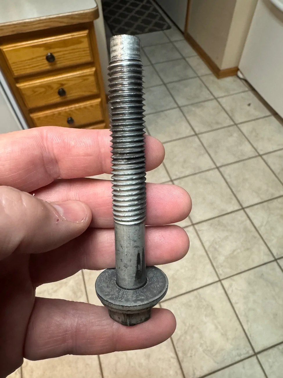

Update - Had an initial appointment with the dealer on October 2nd where they saw what I saw and also couldn't tighten the bolt. They were afraid of breaking the bolt so they ordered a replacement bolt and sent me on my way.
The new bolt came in and I took the car in today. They got it back up on the rack and supported the differential and gently removed it with an impact and a lil heat from those induction heaters. They inspected the threads on the rear differential cover and they appeared ok. There was a ton of lock tite on the original bolt and he thinks it got stuck in the threads and caused the bolt to not seat all the way. The very last thread on the bolt is a little mangled, but nothing crazy. I also see some tool marks or something on the threads.
The new bolt went in super easy and torqued right down. No issues.
The only sorta issue was that the bolt was not covered by warranty. If it had broken and caused issues with the differential, it would have been covered. If I would have tried to fix it and broken it, warranty probably would have been voided.
It only cost $115 for the bolt and repair. So I'll count that as a win. @WD Pro - Thought you might like to hear the update.
Here's the old bolt:
