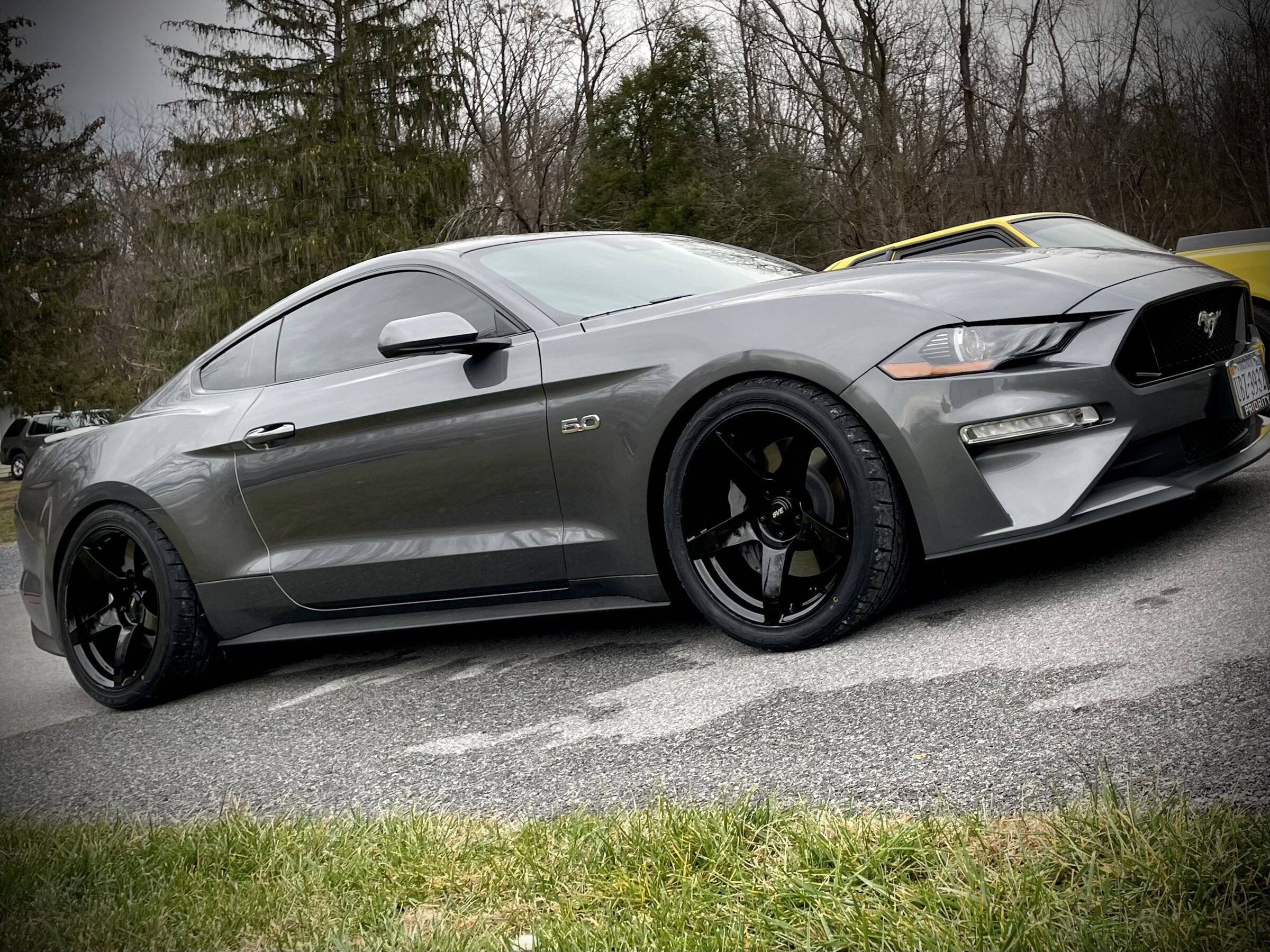

This is 19x10 front 19x11 rear wheel and tire kit from lmr no rubbing at all. I’m on eibach sport line springs
Tire sizes please? If it's R355 staggered kit, those should be 305/35/19 rear & 285/35/19 front. Is that correct?
yes that’s rights
