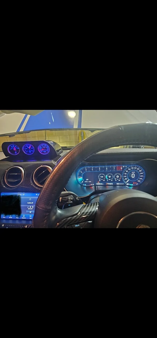

Hi everyone👋 i have a 2018 mustang gt (Australia) and was just playing around with forescan before which i enabled the following features-
- Line lock.
- rear diff temp gauge.
- Ford performance Cobra splash screen on both turn car on and turn car off.
- Autolock when over 25kmh (16mph).
- vacuum/boost gauge.
- performance shift.
- Oil pressure gauge.
What i was wondering is the oil pressure gauge is enabled on the digital dash cluster BUT it isnt active- QUESTION- is there a way to make it work (maybe through a tune because forescan wont activate it) or does anyone know the part number for the actual oil pressure sender to make it work?

yep sure did, when i got my wengerd tune sent to me i asked if he could activate it also on the tune which is the only way you can get it done, forescan you cant, but all works now🤟🤟

mine is also from Australia and i didnt change any wiring or anything but got it activated by my Wengerd tune👌
Sorry I’m a little confused here. The photo you posted shows the gauges in the digital cluster that I’m talking about still reading zero.
Does the Wengerd tune get them working or are we talking about the three gauge pod you have?.
Yes, (disregard the triple gauge pod on top of the dash) The actual oil pressure gauge is turned on through forescan (appears on the dash BUT wont work) and the wengerd tune got the oil pressure gauge actually activated on the digital dash which reads in bar, the trans temp is already an option from factory on there and the diff oil temp is activated through forescan, i had just started the car at the time i took that photo and the oil pressure one is on and working but the diff oil temp and the trans oil temp were still at zero because i hadnt gone anywhere yet.

yes, (disregard the triple gauge pod on top of the dash) the wengerd tune got the oil pressure gauge activated on the digital dash which reads in bar, the trans temp is already an option from factory on there and the diff oil temp is activated through forescan, i had just started the car at the time i took that photo and the oil pressure one is on and working but the diff oil temp and the trans oil temp were still at zero because i hadnt gone anywhere yet.
You’re a bloody legend!
you have single handedly been more helpful then all of the mustang specific performance shops and my local stealership.
I really appreciate it
