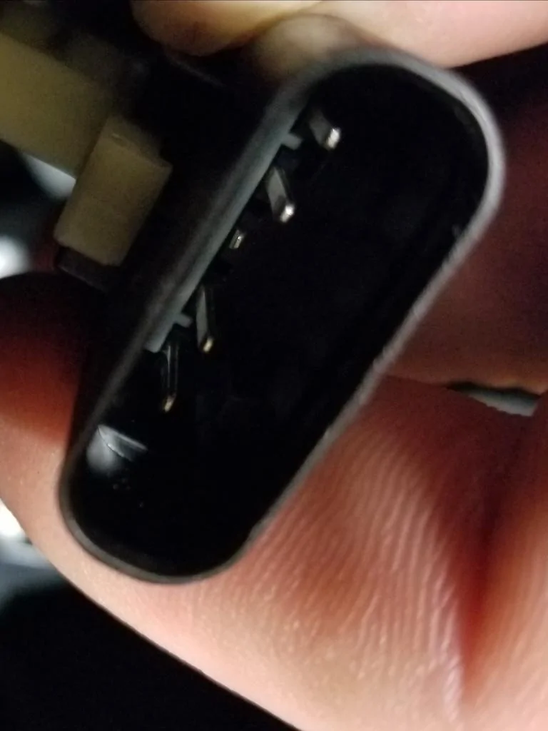

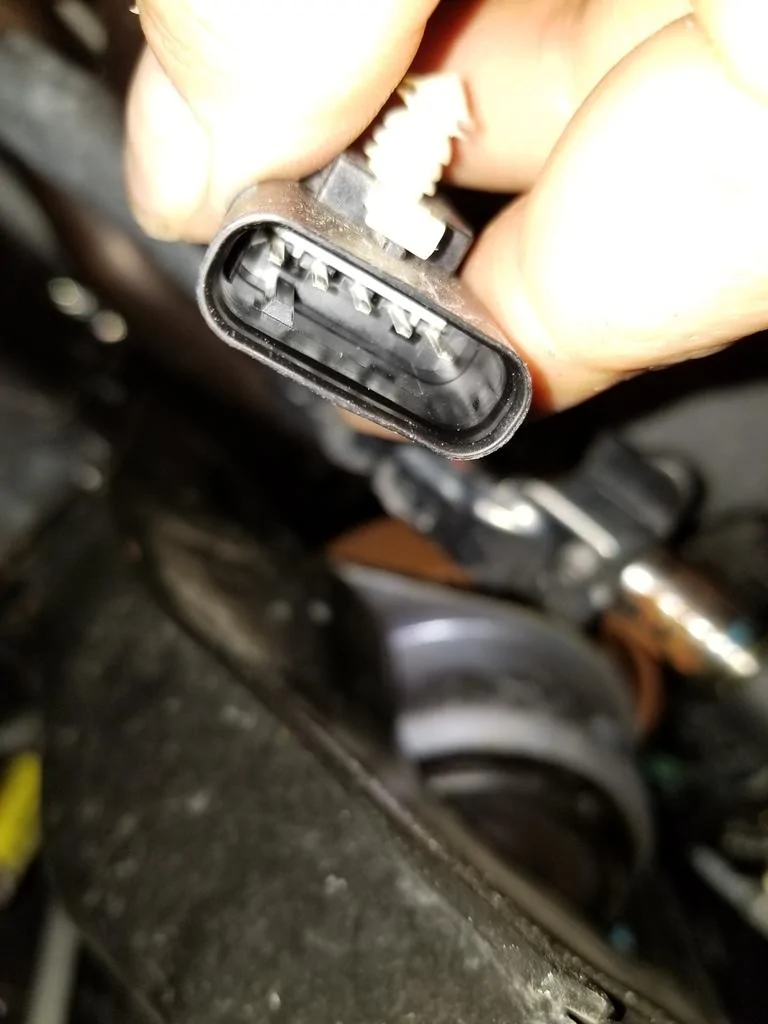

I had a wiring issue I posted yesterday in which nobody commented shit because I understand it is a difficult topic, but I think I've chased down my problem...
CAN SOMEBODY PLEASE DO THIS FOR ME?? I would reeeeally really appreciate it if someone could look at their passenger side FEMALE O2 sensor prongs to see if all 5 prongs are the same length. I think my wiring issue is a broken prong. Below you will find 2 pics, the first will be the passenger female O2 connection port where the middle prong is short and the second pic will be the driver's side in which all 5 are long and equal length. Really hoping i found my issue idk wtf else it would be. Thanks gentlemen!!!

Thanks for asking! No I didn't ever figure out if that was truly the case. I just went ahead and bought an entire new wiring harness. Thankfully it splits up into pieces to where it's pretty much just for the O2s and a few other things. Was only 129$ I just don't get how the middle prong would snap and none other would be bent or snapped or anything especially since you slip the male end far inside the female LOL

Update!!!
Just got a new harness because I couldn't get any pigtails and also wanted to have non fucked up wiring and a fresh start if you will and SUCCESS!!! No more CELs, car idles smooth and is PERFECT. FUCK YES! I guess I was the ginuea pig on this one
Side note: the prongs are all supposed to be the same damn length lmao...
