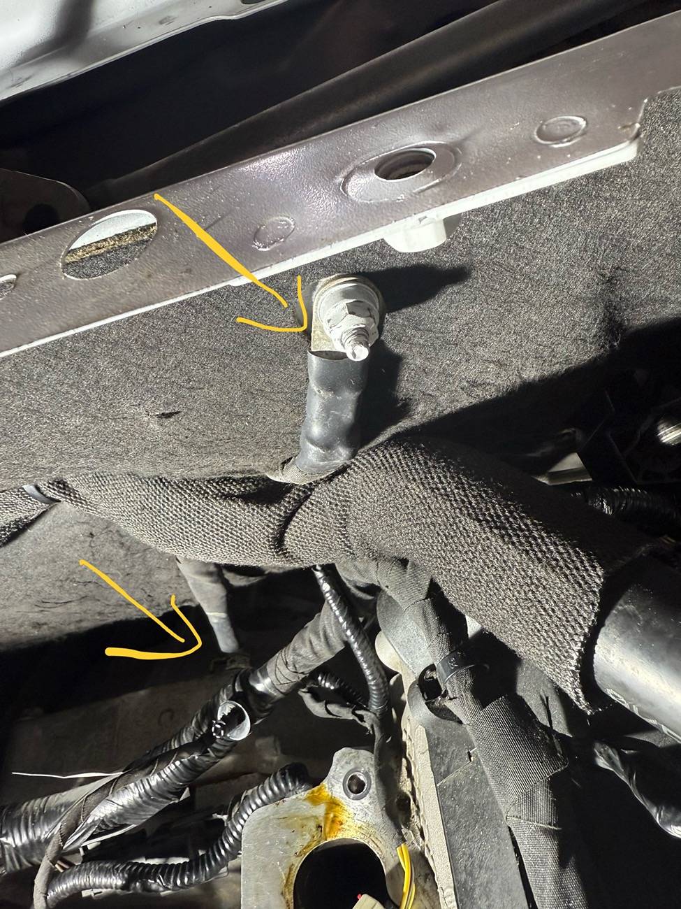

I think I have the engine firewall ground wire connected to the wrong location. Can someone tell me where this attaches? I currently have it connected to the top of the transmission.

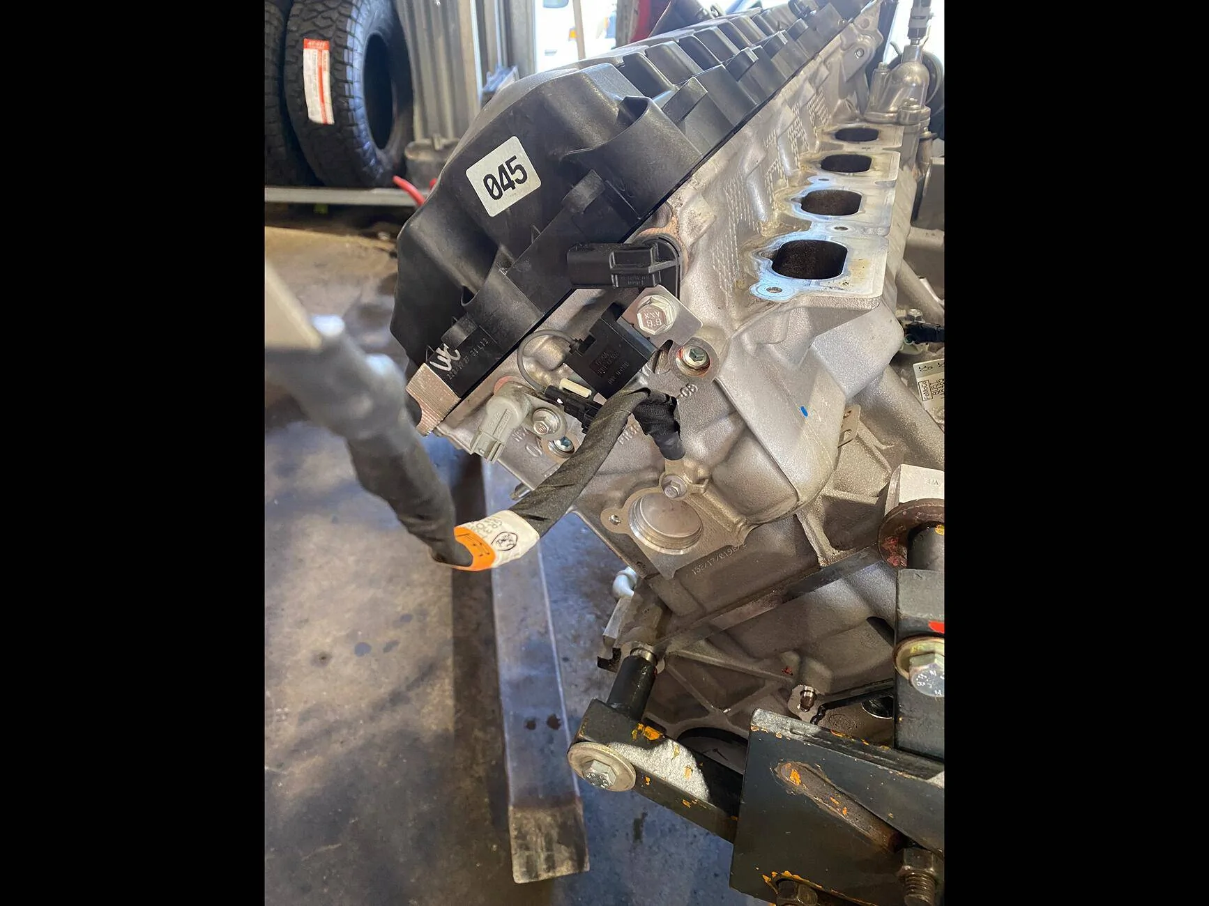

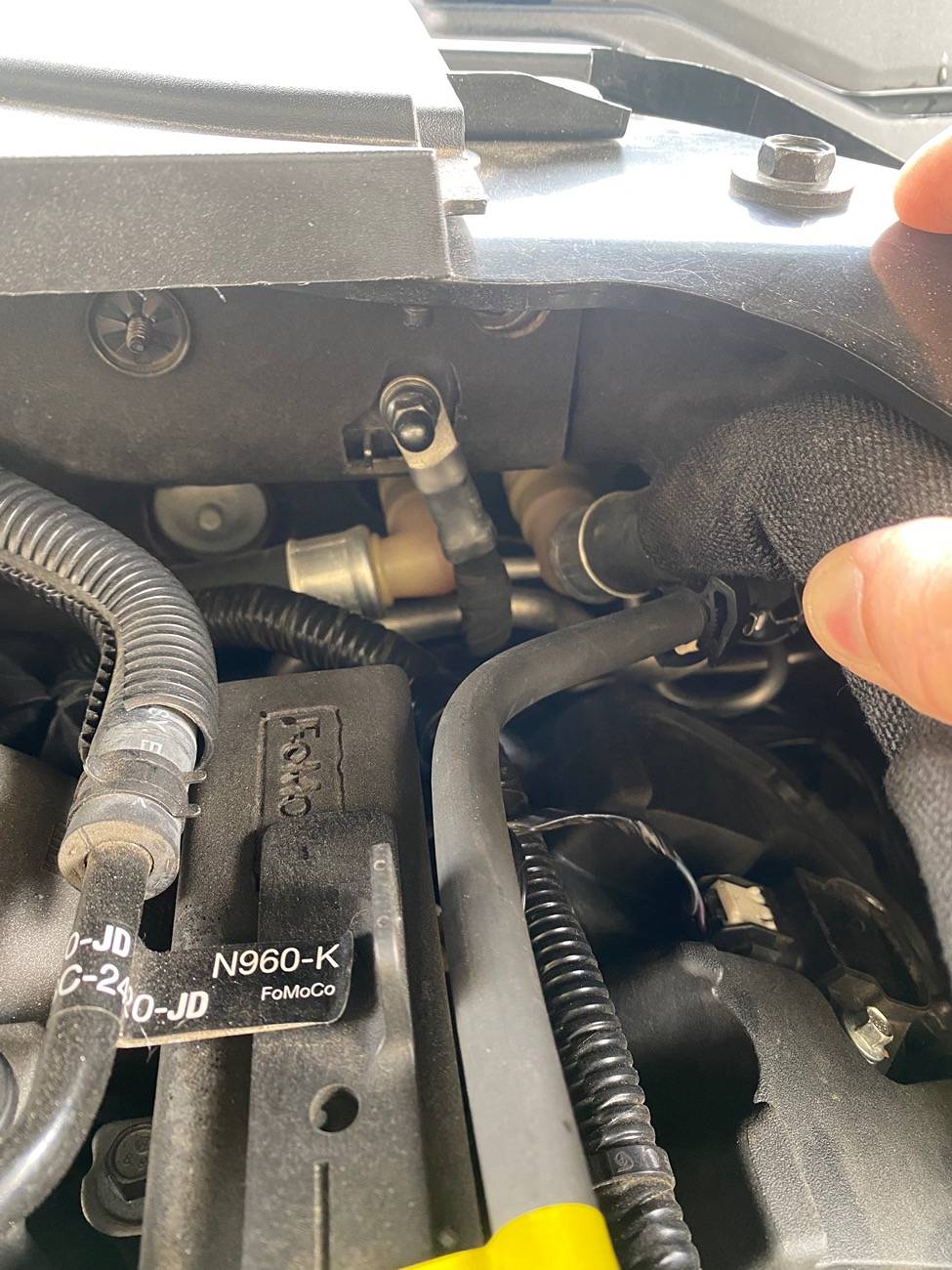

Yep. Mine is 2017 Australian build , but it’s the same top location by the looks.
edit. 2nd pic. As I was pulling engine out of car Bottom attached near water jacket.
at the end of the day , as long as it a good ground it shouldn’t matter.

Does it attach to the transmission on yours?

Sorry. I edited my post with 2nd picture As you posted.
