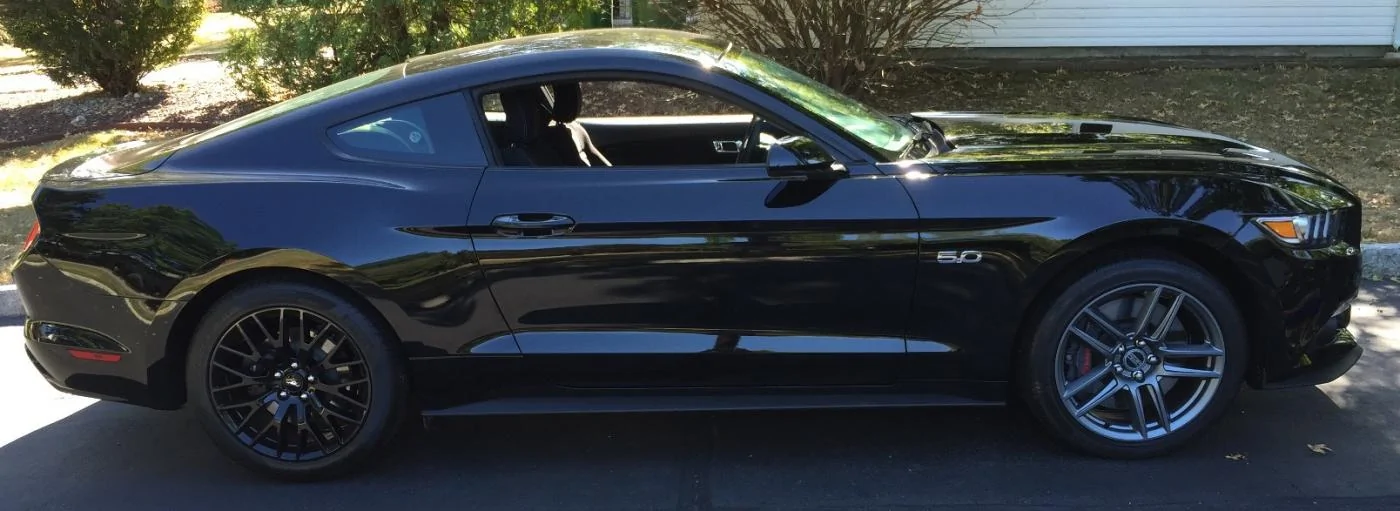

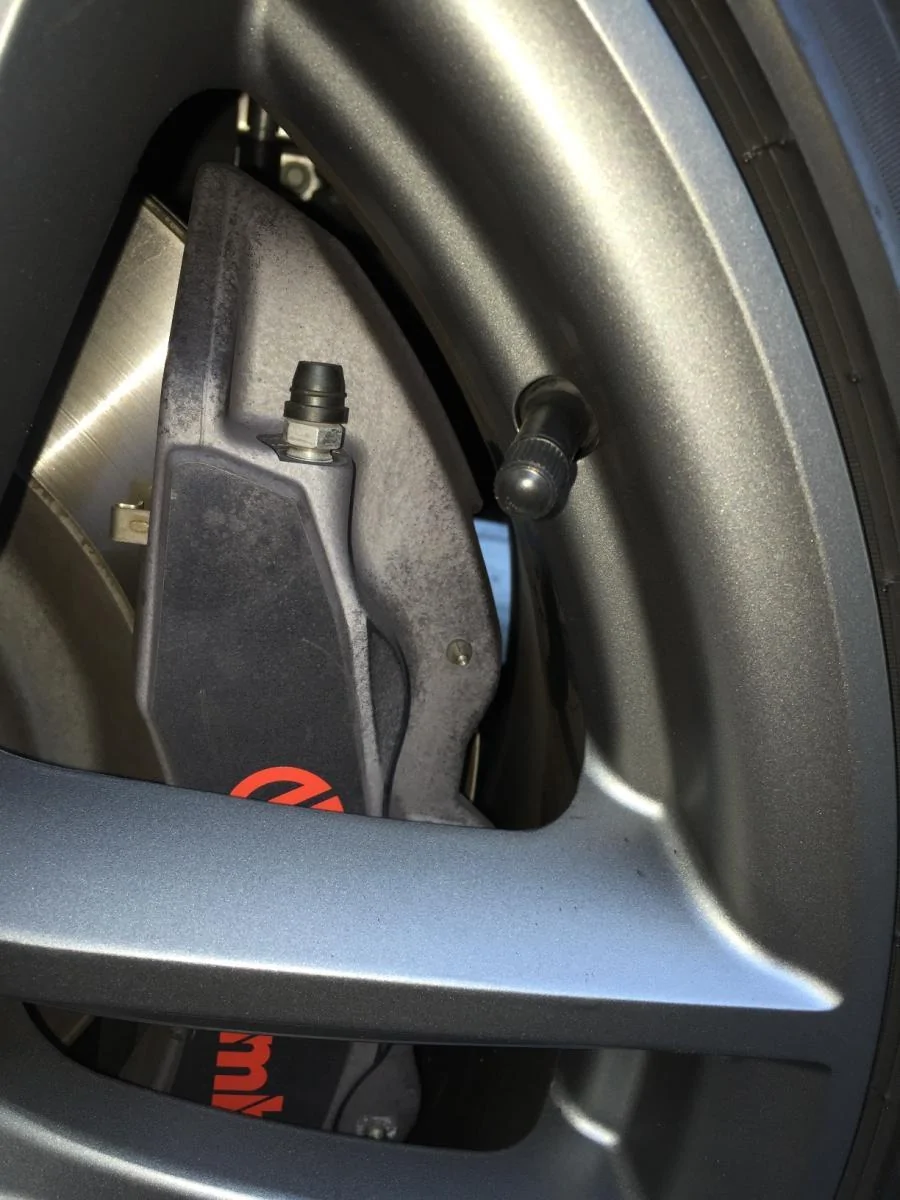

So I checked out a craigslist ad this morning and here is what I found.
Confirmed: The 2005 - 2009 Leguna seca 19x9 from american muscle will fit on the GTPP (attached photos). American Muscle Part Number: #99220G05
The 2005 - 2009 AMRs from the listing below will also fit over the Brembo's. I had them on my car this morning. They looked bigger than the 19x9 Laguna Seca's above so I believe they are the 10's. Regardless, they fit and there is lots of tread left. Wheels are in "like new" condition. https://allentown.craigslist.org/pts/5168433546.html
