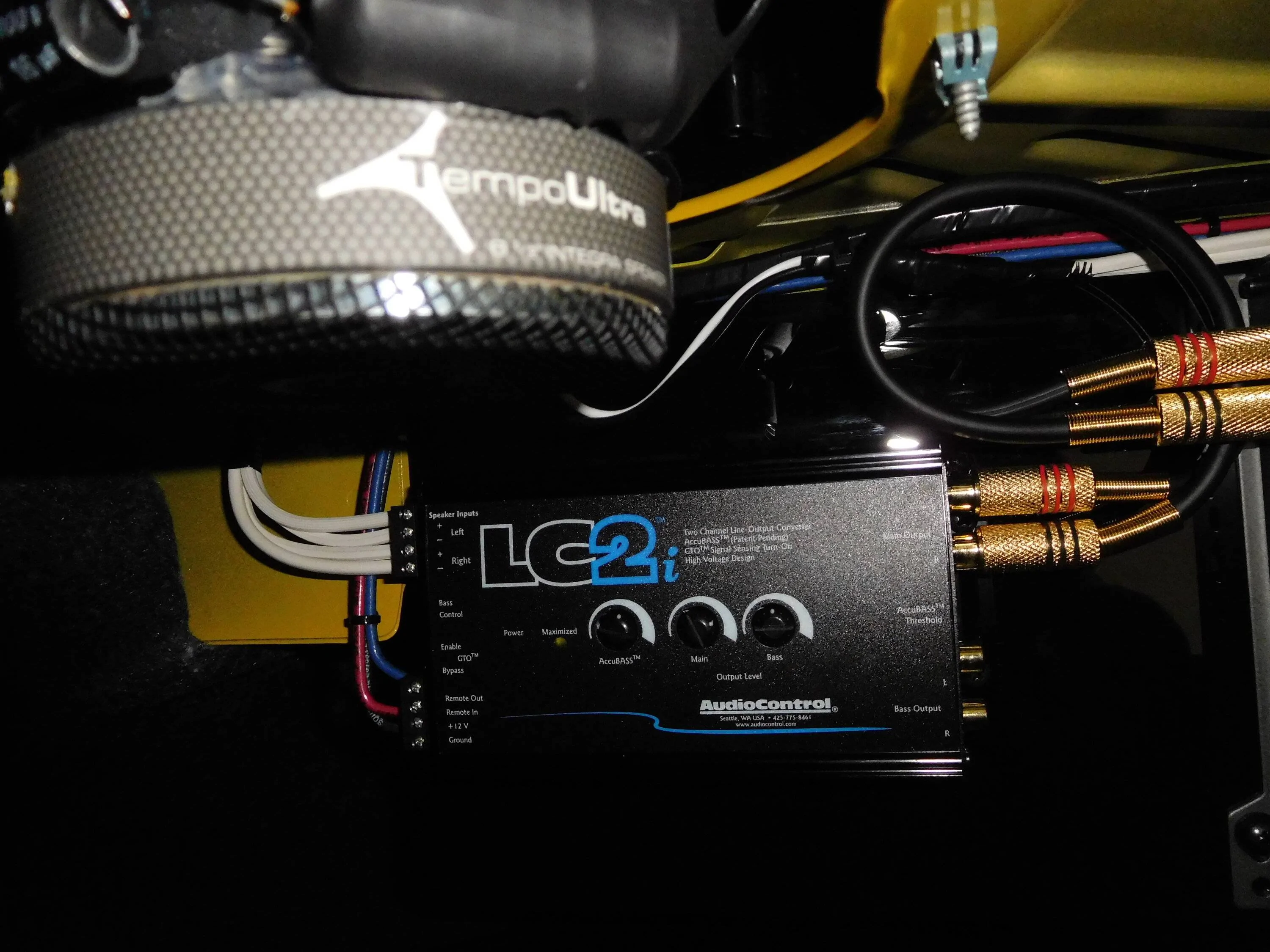

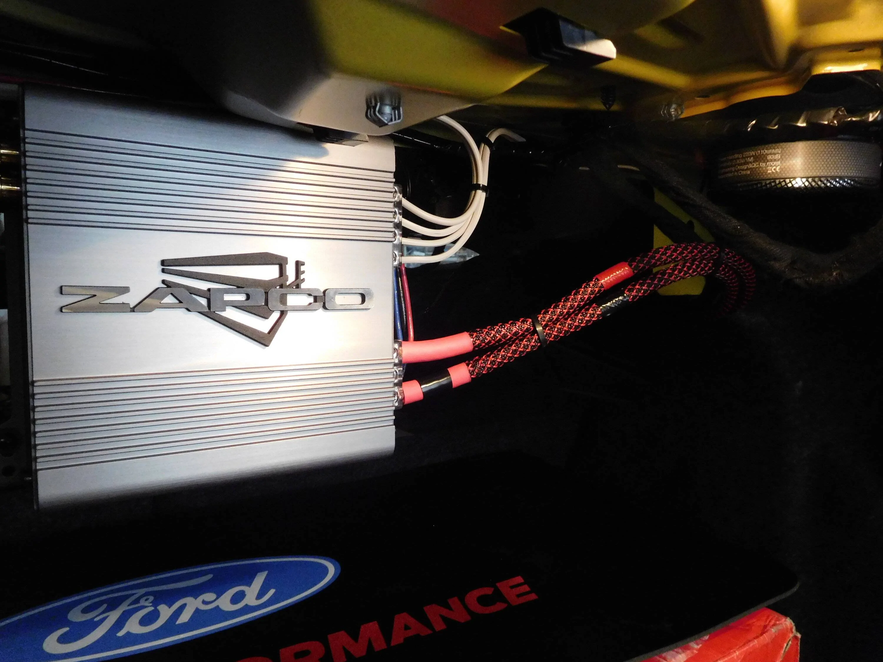

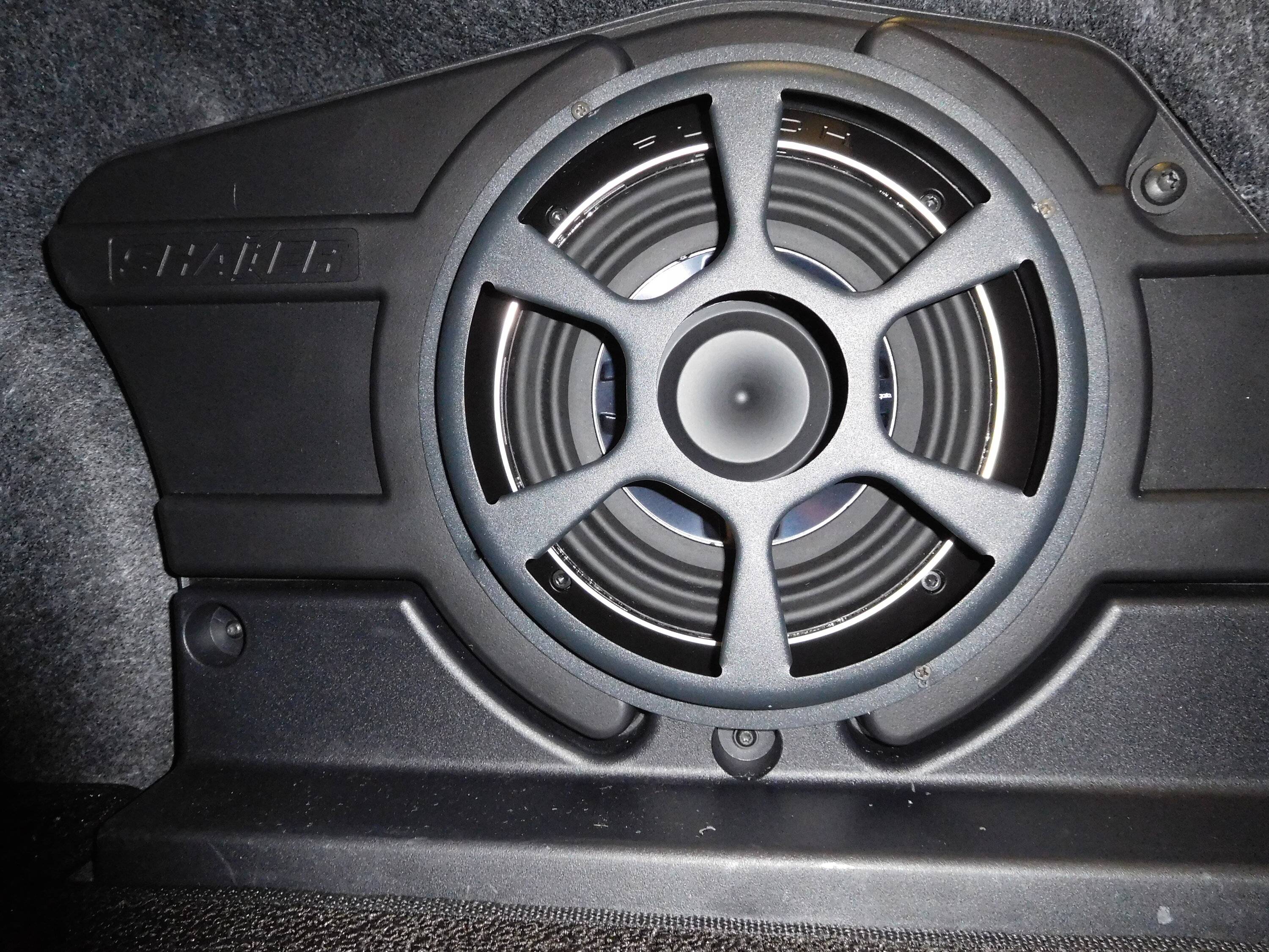

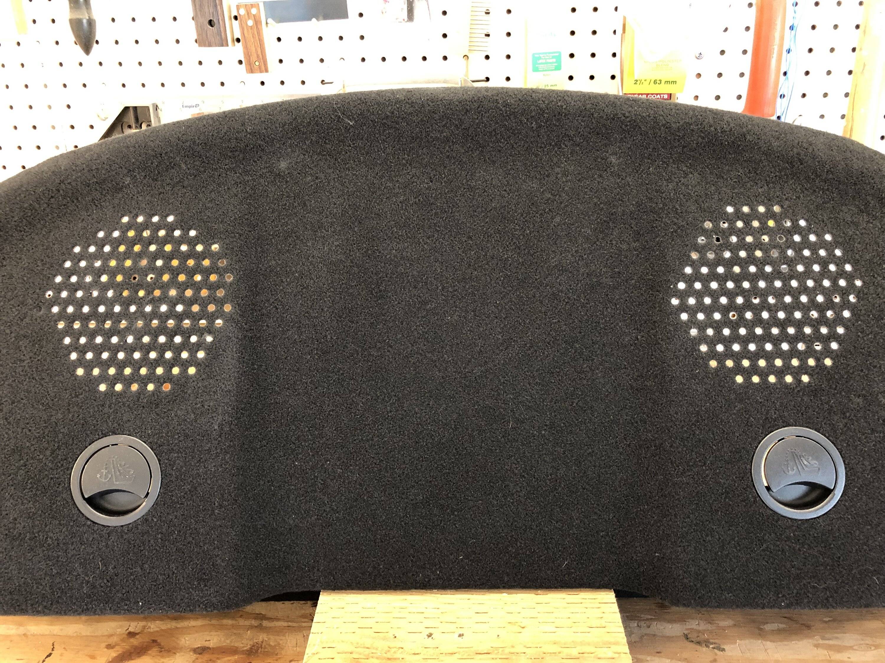

I have a 2015 LE Appearance Package. Got a rear deck speaker mounting kit from Crutchfield to install the Morel Ultra Tempo speakers and perforated the deck lid cove so more sound could pass thru, added a Zapco 2 channel amp and the LC2i DSP and upgraded the OEM sub to a Rockford Fosgate sub. The LC2i has another RCA channel output so I can add another amp (mono) to drive the sub if I want.
